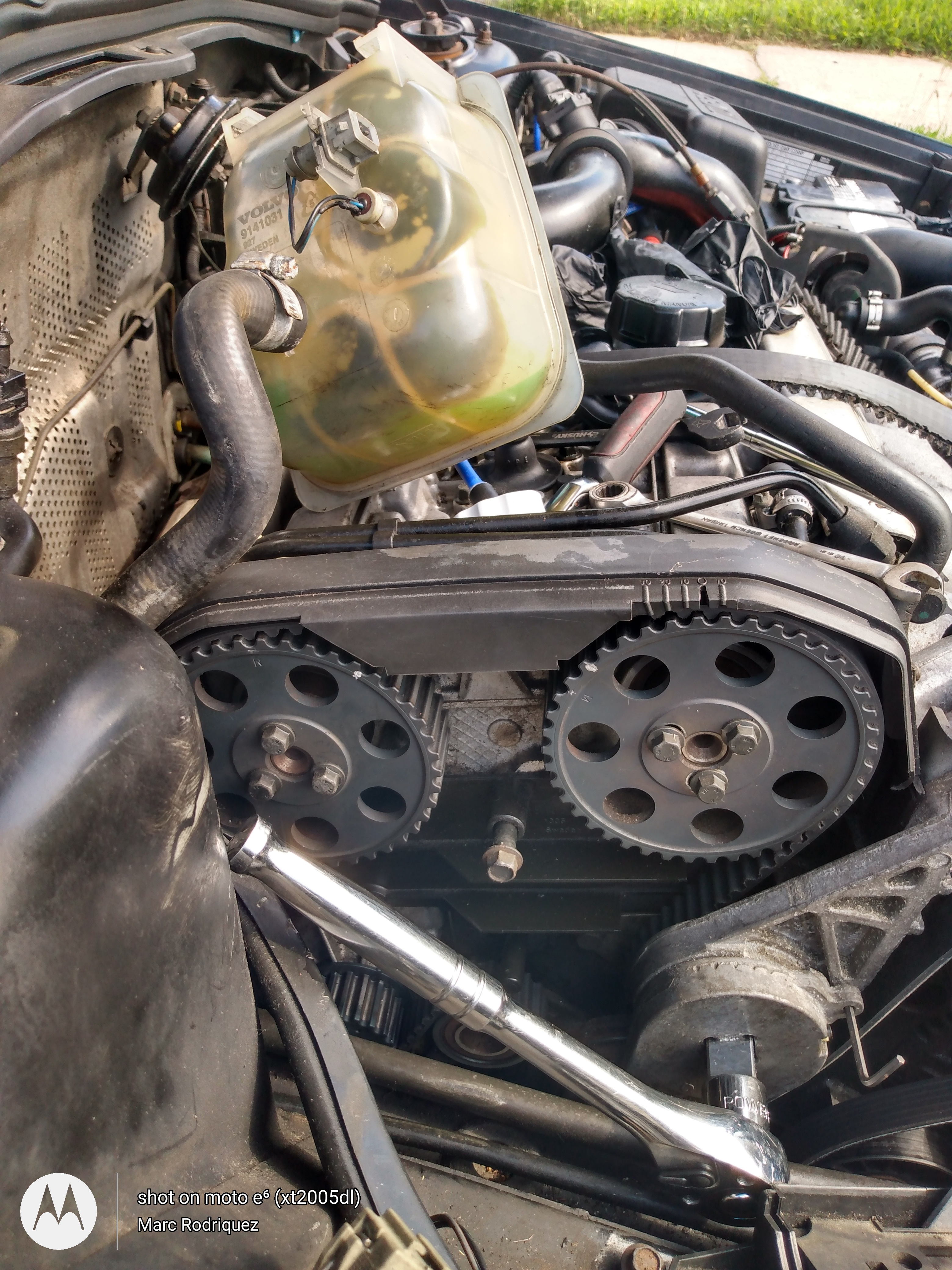

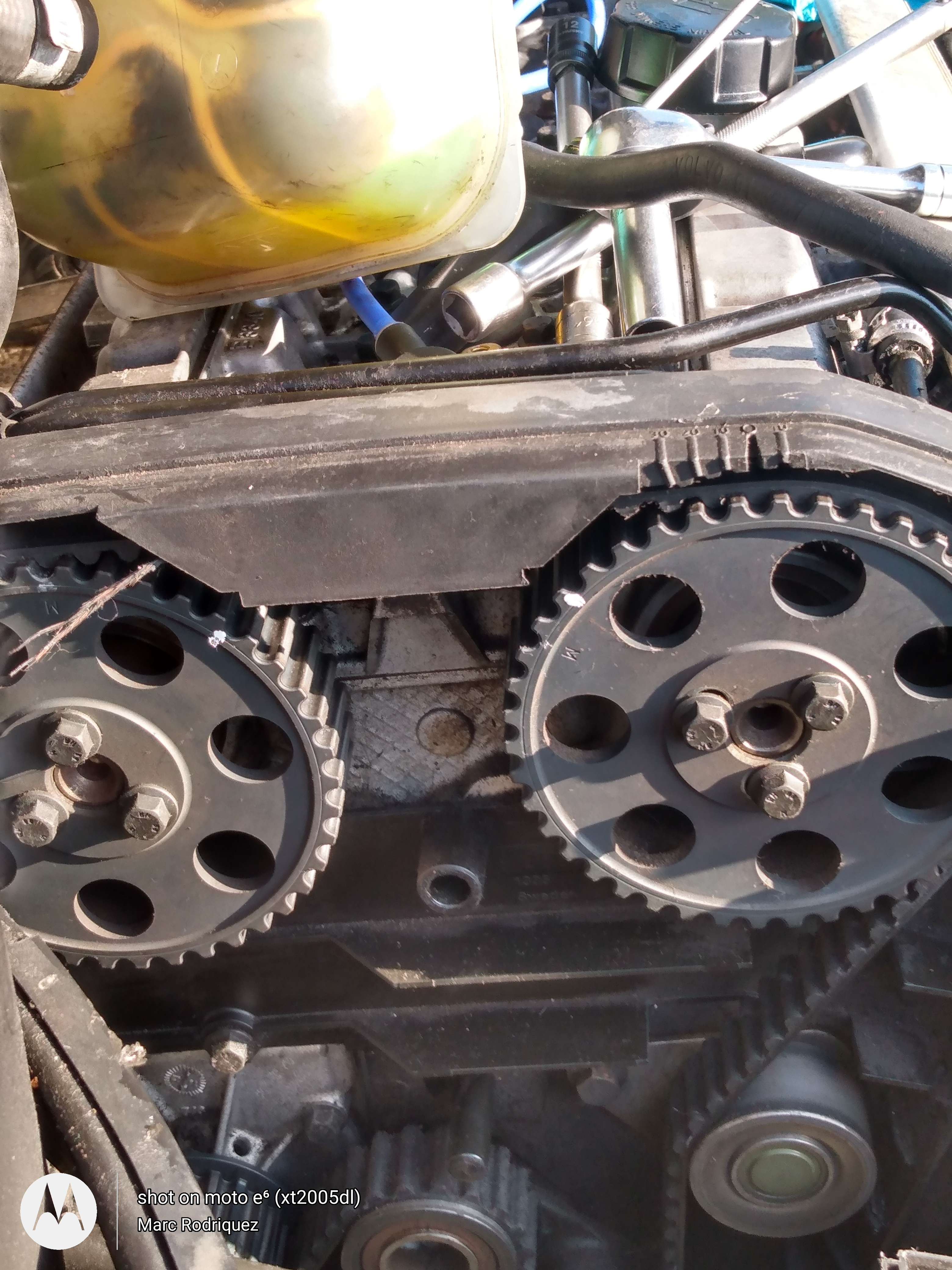

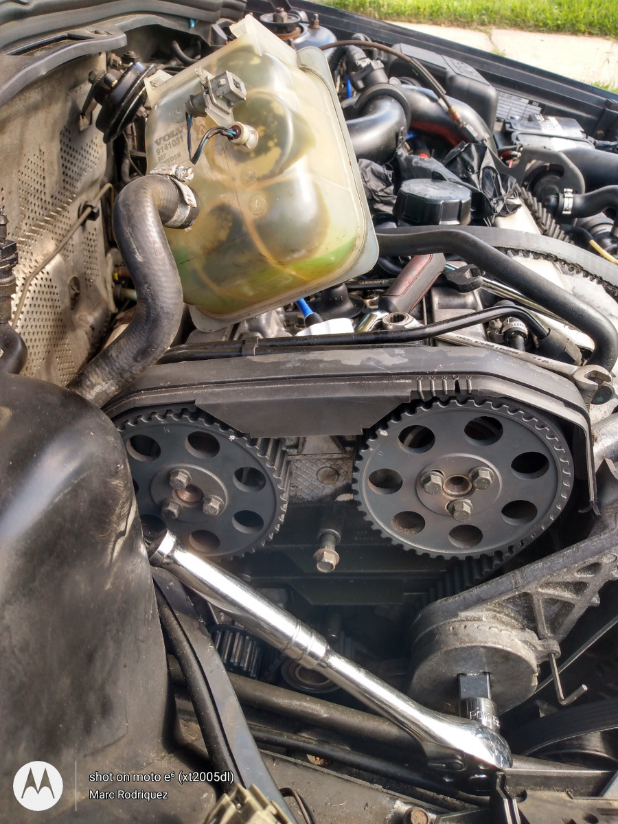

Also I haven't pulled the pin on the tensioner so nothing is locked in placemdr1220 wrote: 26 Jun 2021, 14:39 Put my new timing belt on and the exhaust cam moved now it doesn't line up. Am I screwed? And if you look closer at the intake cam someone messed with it before me. Any suggestions?

First of all here is better more mechanics kinda of people to give opinion still as i am more nerd kinda and vigilante. Just some start here.
Well when these three contacts in picture bottom are same you are good to go. And you haven't turned at all the bottom crankshaft by any turn so you have correct cylinder order going on there.
After putting it back to correct and pulling the pin do manually couple revolutions for the motor to check to confirm nothing will hit each other and it will turn.. if it hits something you hear metal clonk sound. Manual says to give some press force on top and left side but i didn't myself do so (i wasn't aware of this instruction).
Then finally second time look timing marks are still correct after manual turns.
Those pullies are yes variable some degree.. they instruct you to aim for center and it seems slightly off. As you put it i don't know why has put like that. Quickly looking they told to lock those bolts of camshafts to 20Nm. But i give warning that maybe wait some mechanic here to claim better or confirm my writing.

I didn't touch the crank pulley and its still in the same position when I lined up all the marksxanthefin wrote: 26 Jun 2021, 15:49 First of all here is better more mechanics kinda of people to give opinion still as i am more nerd kinda and vigilante. Just some start here.

You can easily recover from this situation. and Be sure to Rotate the crank 2 times around by hand to be sure you are back in time. Robert DIY has other timing vids too.
