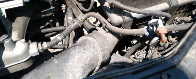

Hi,
I was working on my car last week and accidentally knocked this blue sensor as the top part popped up (there is a spring inside). I put it back together with zip ties but would like to replace it with a new one. I don't know what it is/called, any ideas?
Thanks

It’s a vacuum sensor for the power brake system. You can glue it back together or get a new one here at FCP
https://www.fcpeuro.com/products/volvo- ... 93#fitment
I think it’s a new design, but check fitment

Perfect, thanks for the help abscate.
