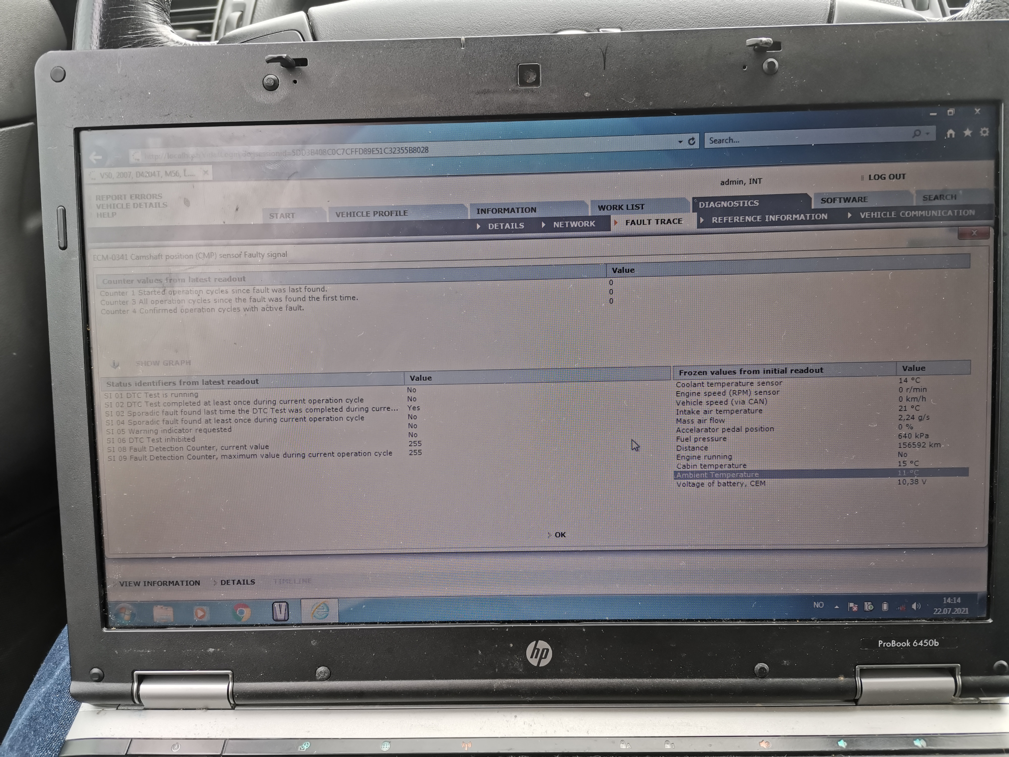

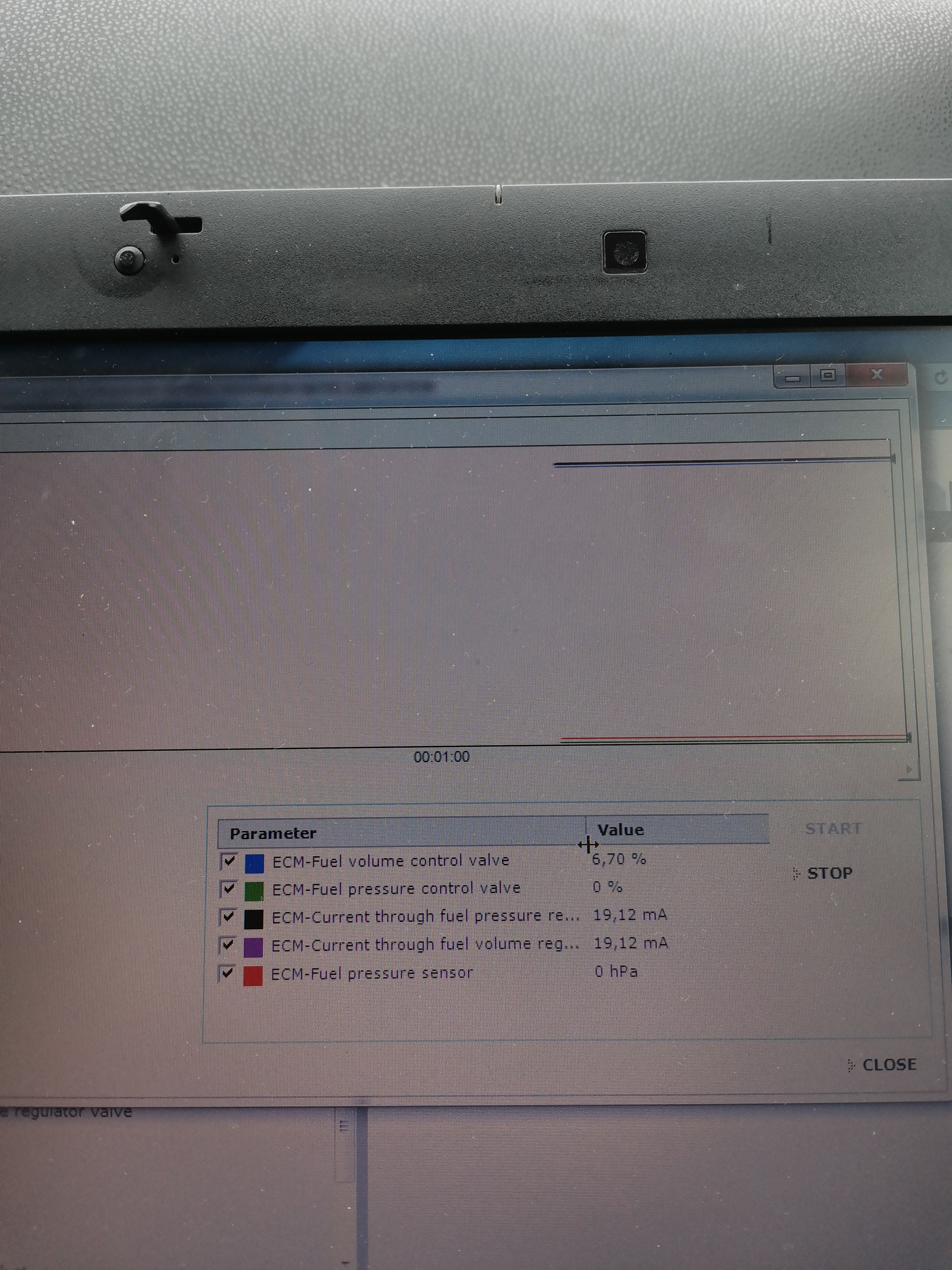

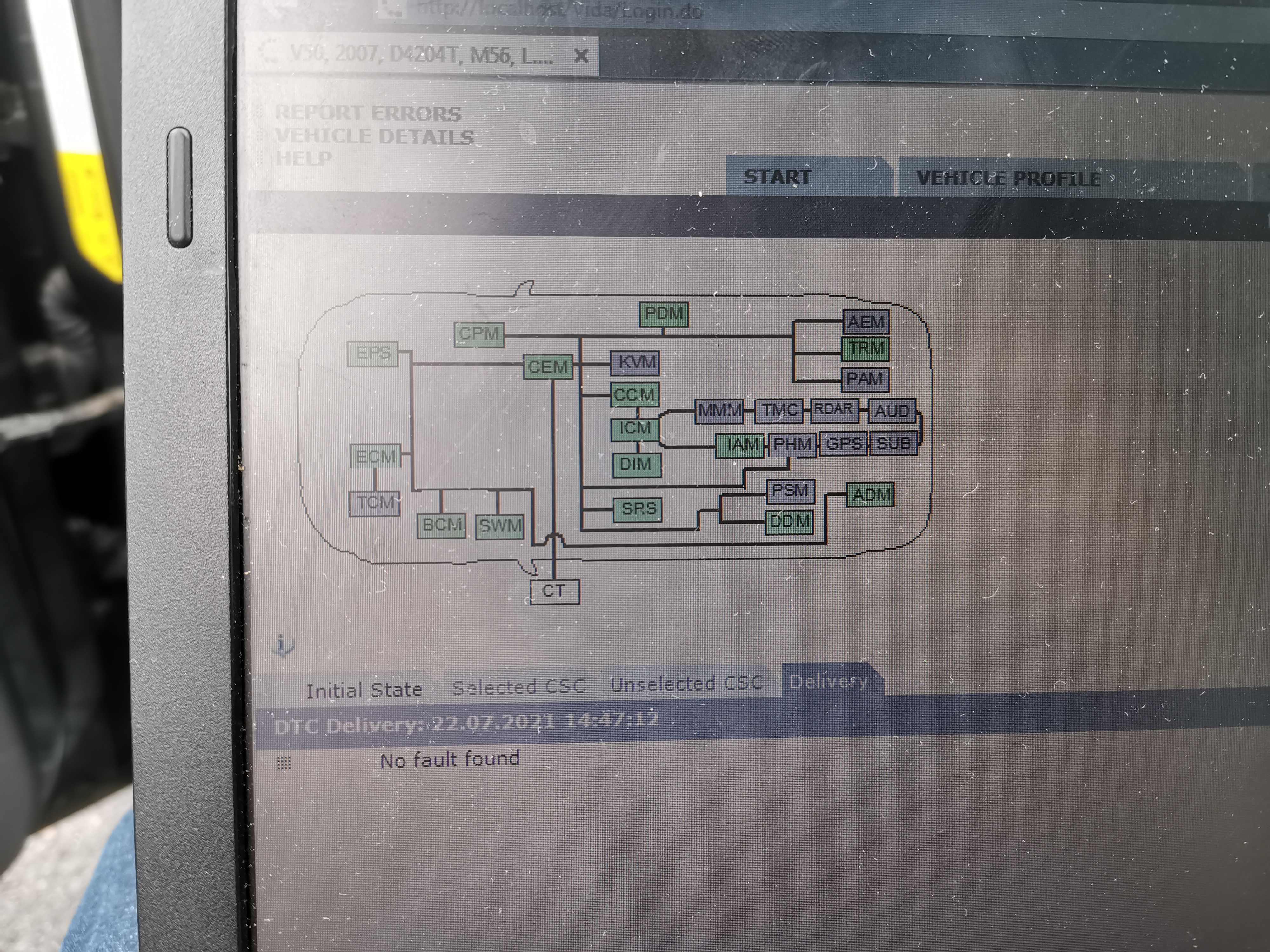

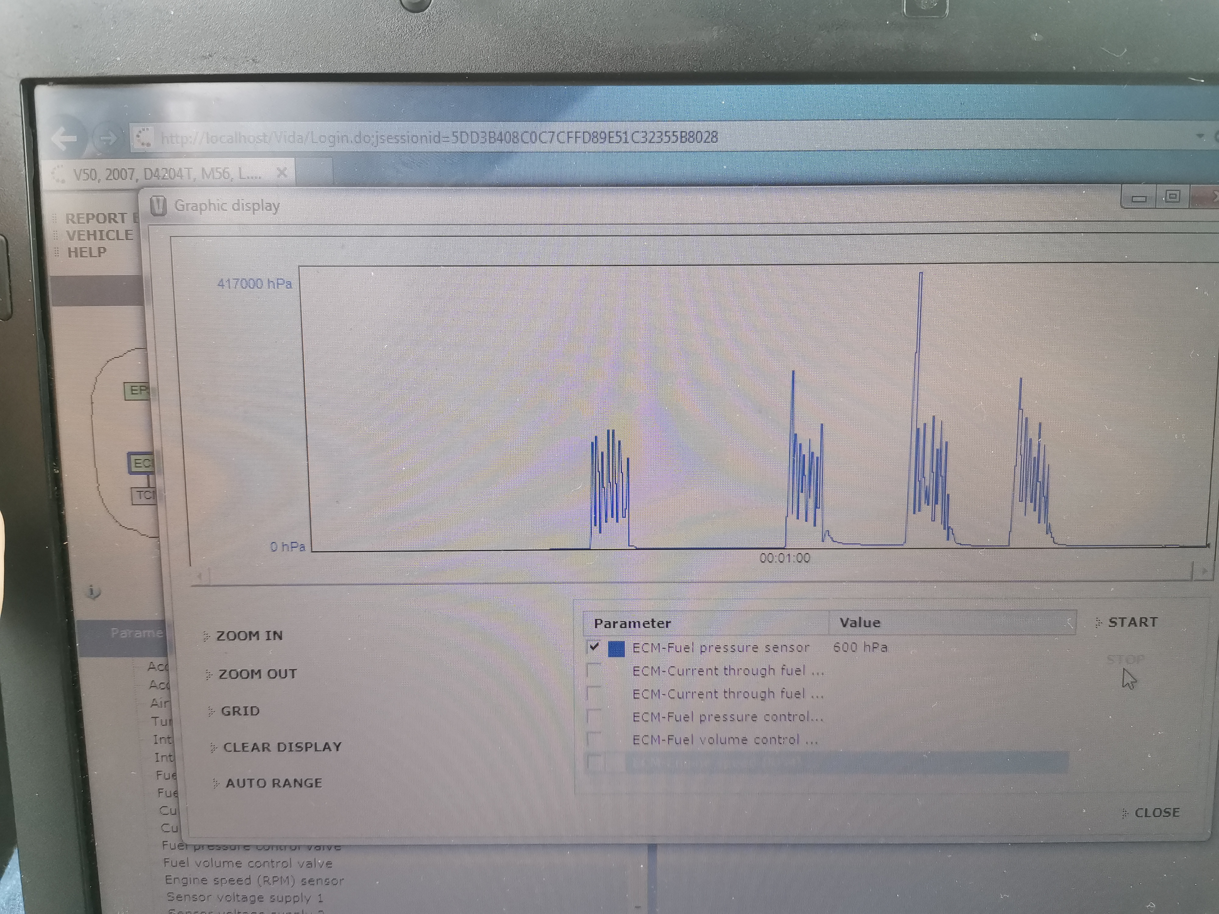

after this i managed to get a hold of a Vida to properly check diesel pressure and other sensor values, and i noticed the diesel pressure spiking to 150-500 bar upon cranking but quickly dropping down to just 40-60 bar after the peaks. so after this i determined it had to be something with the diesel system, maybe the diesel pump was dying and that was the reason the injectors went bad? but i am not confident in this yet to change the pump as i fear the issue might be some other electrical gremlin issue and i'm a bit over my head here. the local shop can't help me much as they suggested to start changin cem and random shit for almost no apparent reason for way more than the car is ever worth. does anyone have any clues or advice to how i should proceed here? i got a few pics of the diesel pressure curve and some other values and i can go get some more if needed.
