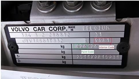

I'll see if I can figure this out for you when I check on Vida later for someone else for something. You Vin # is weird compared to the North American ones. There are about 4 digits missing! Maybe that is a Euro thing.

The plate does look weird.
It looks like it is not the one from under the hood...on inner fender.

Look at the top,picture closely for a clue

Finally dawned on my the car is RHD and a saffron V70R. Still don't get the weird Vin#. Can't quite read one of the digits on the number that is there. The Vin plate is not in the usual spot on the LH front inner fender behind the battery.

I grabbed the VIN plate picture from google, seems to be from a V40 but still looks weird :?

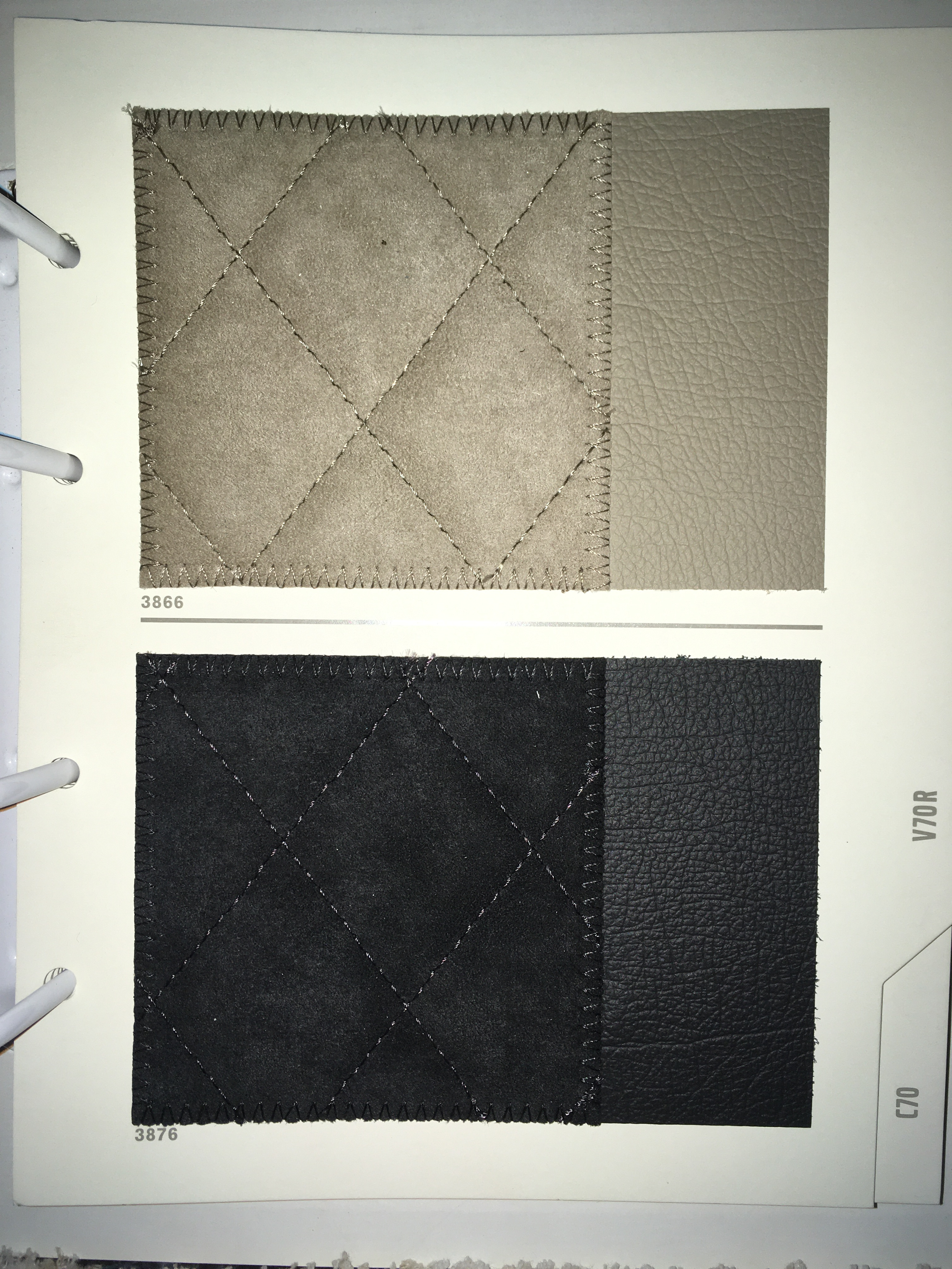

The color code for a beige interior on a V/S70R is 3866.
I bought 2 bottom seat skin (part# 9424470) about 8 years ago and at that time the backrest seat skin was NLA. The truth is that I managed to buy new parts that were long time NLA.. Good luck!
