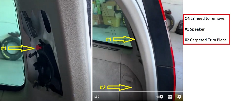

Since I do no have the 2004 V70 with me now (kid in college)...
And since I was in the junk yard today for other things, happened to see a V70, so looked at it...
- For the LOWER tail light assembly, ONLY the UPPER nut (#1 in the attached photo) is hidden behind the plastic trim.
The other 2 nuts are easily accessible.
So, the reason youtube videos say removing top and side trims is bc of this UPPER nut.
- Options are:
1. Follow the videos in youtube and remove the top plastic trim, then side trim, with a small risk of breaking the plastic trim.
2. If you don't want to remove the plastic trims for risks of damaging them, then...
Drill a hole with correct size and location to access that UPPER nut.
Use magnetic socket (small magnet inside the 10-mm socket) to avoid dropping the nut.
Once done, plug that hole with some rubber plug.
Or...
3. I kind of eyeballed it, but if you reach inside (with the plastic trim in place), you can feel that UPPER nut.
Then use a 10-mm ratcheting wrench to loosen it, then spin it out with your fingers.
I will try it soon when I have the car and report back...
- Options are:
Or...
PS: the reason for this post: I hate removing trim work in an older car, you risk breaking it...

Update,
@MDK is right. This LOWER light assembly can be removed without removing any of those plastic trim works.
Tricks:
1. Watch the videos above but...NO need to remove any of those plastic trim works.
2. Use 10-mm long socket with universal joint, 1/4" is best but 3/8" ratchet is fine too.
3. A 10-mm ratcheting wrench is a big plus. Remove any light bulb that is your way to make room for the 10-mm ratcheting wrench.
4. Speaker plastic trim and speaker (use a pair of pliers to remove the red tab in the speaker) as in videos: 2 minutes.
5. Remove the lower carpeted trim work: 3 seconds.
6. The rest is straightforward, the TOP nut of the LOWER light assembly can be reached using either 1/4" socket or ratcheting wrench.
7. I stuffed a rag at the bottom in case the nut falls but luckily I was able to do whole thing w/o dropping any nut. Or get a telescopic magnet at auto parts store ($4-$5)...
Yes, these are the only 2 items you need to remove.Very easy, no need to remove any of the upper or side trim works...
