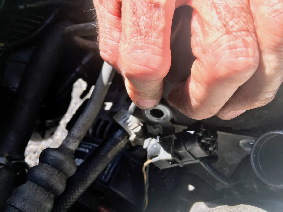

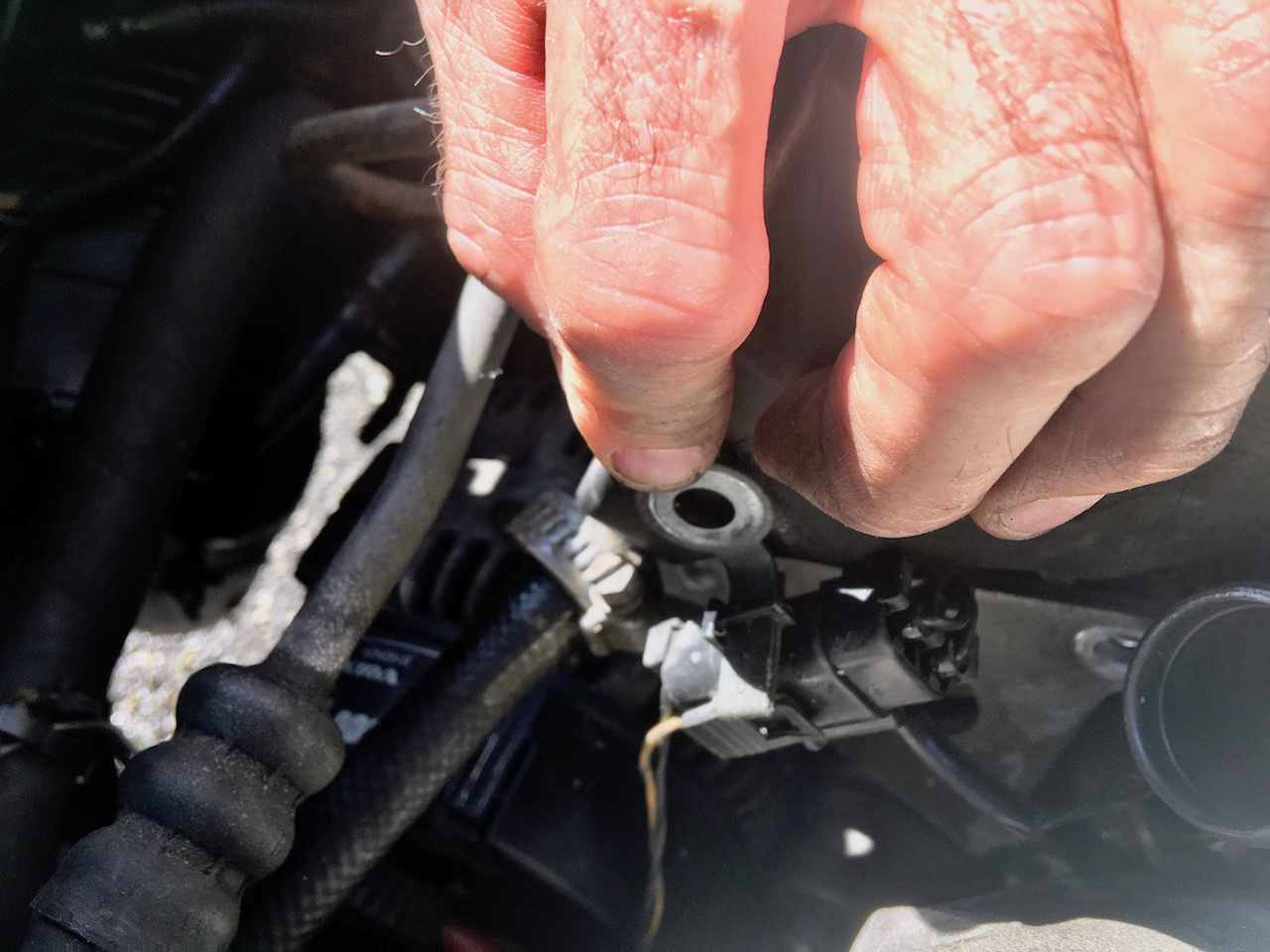

A little steering fluid stuck to my accessory belt. I ordered a new one from my dealer. I disassembled the whole steering pump system to access the alternator but the one I had planned to replace (from a 1998 V70 diesel) is not compatible. So I took the opportunity to clean and degrease everything, I reassembled the alternator and power steering pump, reconnected everything and tomorrow I'll put the new belt. I was too tired to finish.
After that, a good wash at Meguiars and on the way to the test drive, then the refueling.
A question, anyway : This part is to be fix under the steering pump, with the screw of the bracket, right ?

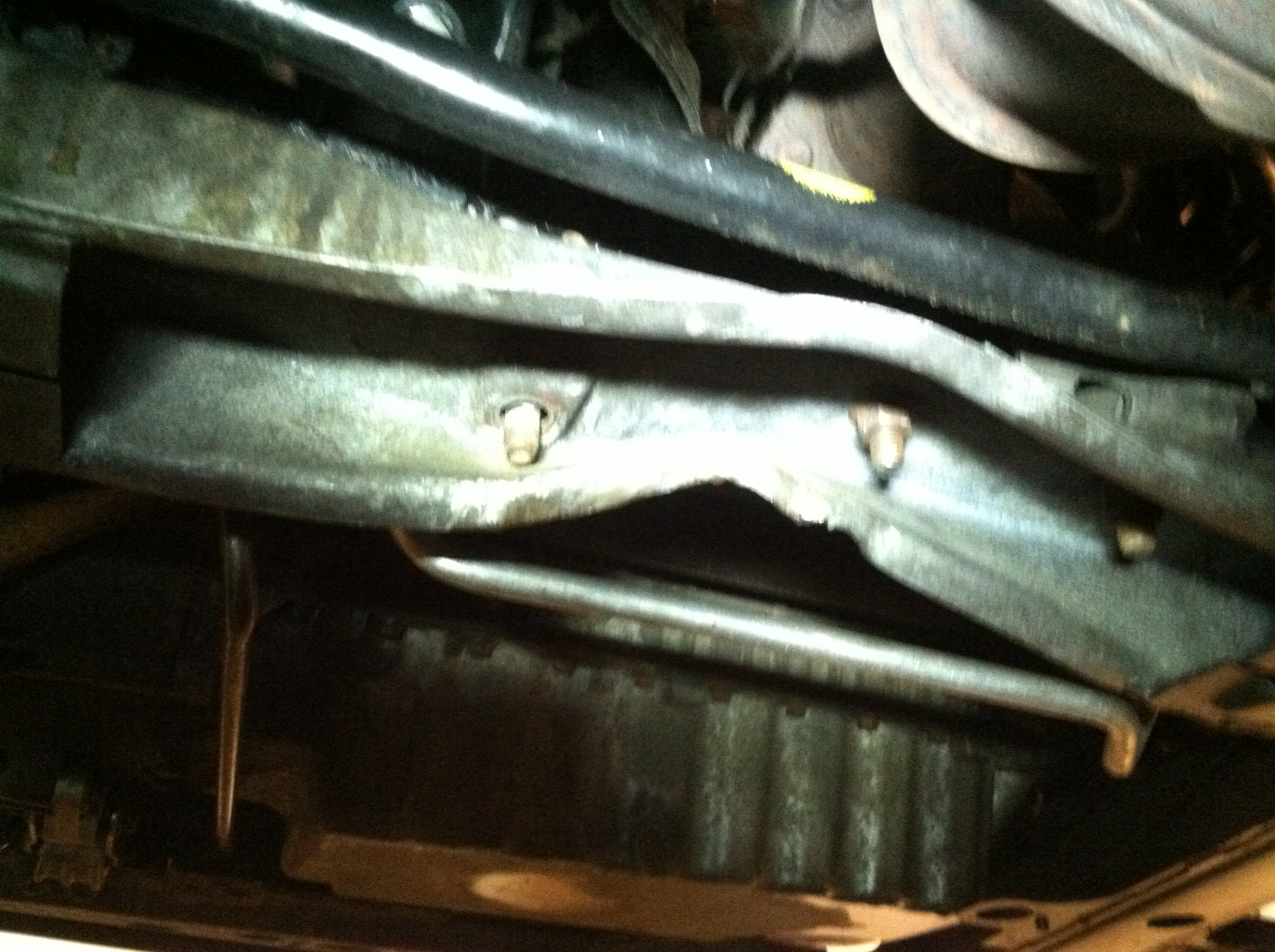

Dealing with the steering rack; it froze up solid while I was driving it. Kept it out of the weeds - barely.
Found this.

Sub frame to replace, to me, i mean in France, this sends the car to the junk yard... if not in perfect shape.

Woah, was that the result of it locking up or did you hit something that damaged the rack before? Time for a new subframe!

bmdubya1198 wrote: 11 Aug 2021, 16:19 Woah, was that the result of it locking up or did you hit something that damaged the rack before? Time for a new subframe!
The car is new to me, first time under it; this feature was pre-installed.
Has lots of new stuff, poorly done.
Managed to keep it on the pavement during the Excitement.

Just got a spreader bar for the floor jack; once I have a man-to-man chat with my back I'll finish dropping it and regroup.

Curios, with that big a whump, that the airbags didn't blow.
