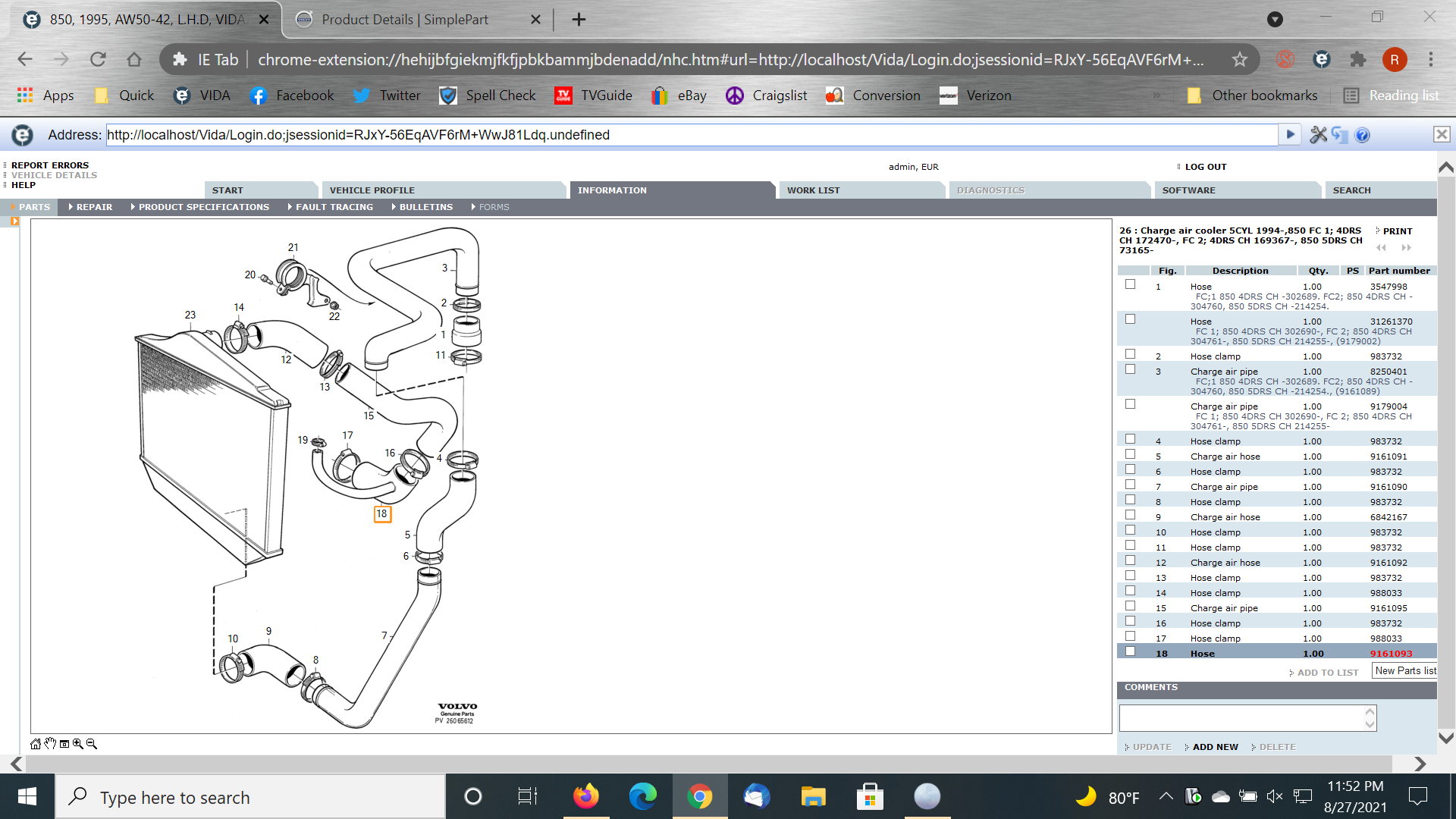

Which hose is it that has broken? There are likely used ones out there but being a 2.0l it is not a car we got over in North America.
Can you post a picture as there is always a chance a member may have one in Europe or be able to suggest where to try. My memory of 850 turbos is fading with old age (not the cars, me!!).

Elbow with a smaller hose forking off? Volvo 9161093.fantajuice wrote: ↑27 Aug 2021, 10:32 Hose before intake is busted, no clue where I can get another one.
Any Turbo 850 1994 - 1997.
Any Turbo 1998 C/S/V/XC70.
In other words any Turbo P80 1994 - 1998.

Nobody's selling them, got a spare from some guy who didn't need his anymore - it's almost split in half too. We don't have many turbo P80's here or nobody's willing to sell parts or part them. Absolutely none in wreckers.RickHaleParker wrote: ↑27 Aug 2021, 22:34Elbow with a smaller hose forking off? Volvo 9161093.fantajuice wrote: ↑27 Aug 2021, 10:32 Hose before intake is busted, no clue where I can get another one.
