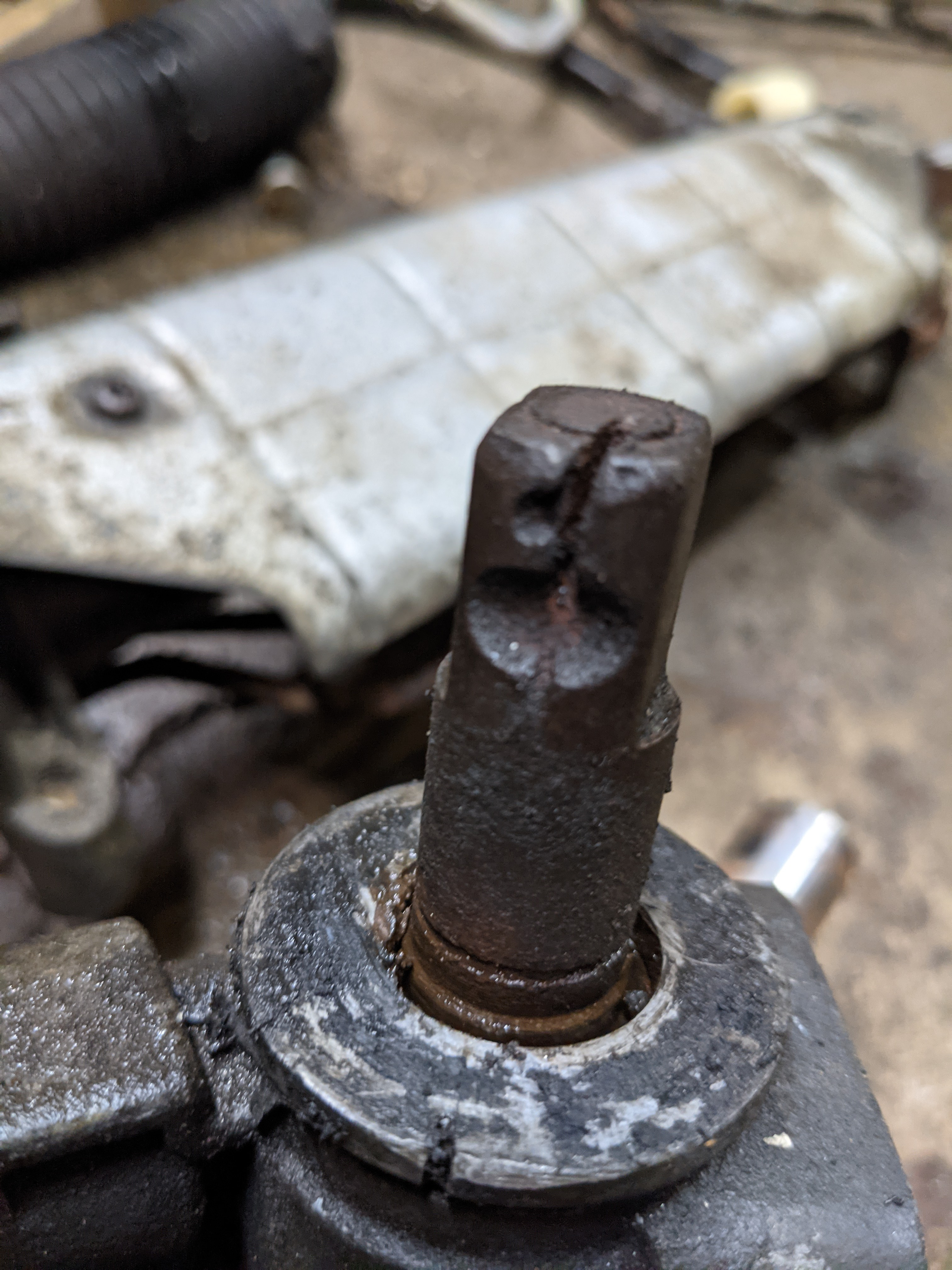

I picked up a smi 6820000015 rack from the salvage yard that's in decent shape. It is indeed non variable.
I am stuck right now because the steering shaft won't come out of the old rack. I have given it a pretty good beating with a drift to no avail. I even tried to wedge a screwdriver into the pinch slot to spread it out a bit but that didn't work either. I'm afraid to heat it because the shift cables run right next to the steering shaft.
Has anyone had this problem? Any tips?

That's a good idea but I'm not sure if the rack would squeeze out with the shaft attached. It was a real right squeeze as it was. I ended up getting it out by just beating it harder and wedging a larger screwdriver in the pinch slot. It looks like whoever was in there before me cut a slot in the rack shaft and staked it to make the steering shaft stay on. I guess they couldn't find the right size bolt. It's a bit terrifying to see a corner cut like that.abscate wrote: 28 Aug 2021, 18:22 Go inside the car and disconnect the steering shaft at the U joint

It always freezes like that. Steel-aluminum pressurized contact, salt, water and time - all it takes to infuse materials into each other. Use some anti-seize for your replacement rack.
You still can take the rack out, just lower the subframe a bit more and rotate the rack.
