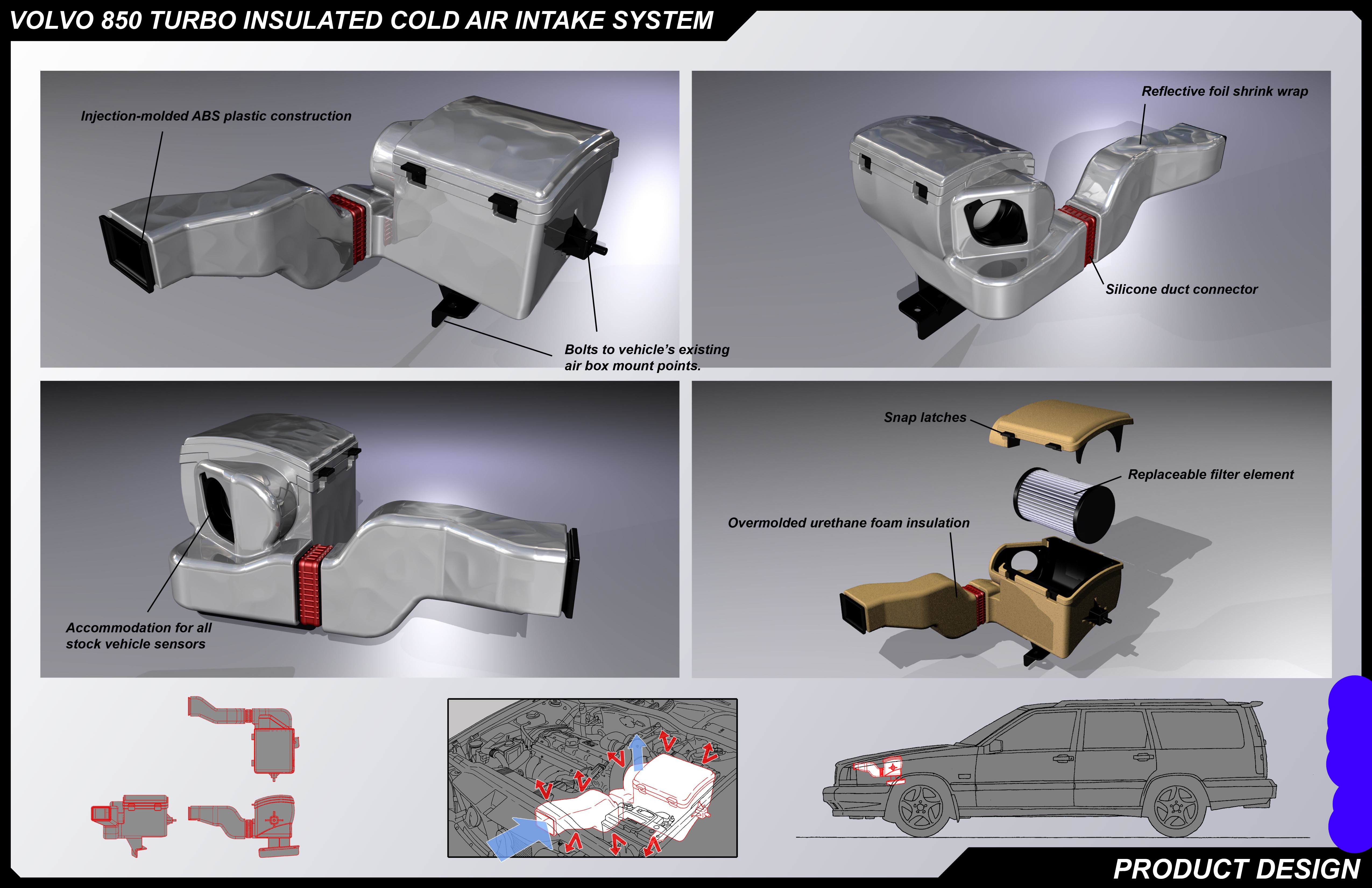

This is something I worked on several years ago - a custom cold air intake for my 850 Turbo. I built the original input model in cardboard to verify fit, then a nicer one out of black foamcore, then built it digitally in Rhino. I even made a presentation panel for it. I haven't messed with it in years, but since I'm into the hot rod phase of the car's life, I thought I'd drag it out and have another look.
I have no idea how much this drops the intake air temp, but I know it drops in with no interferences. The air duct maintains a constant cross-section along its entire length, and it's designed to accommodate all the factory sensors.
