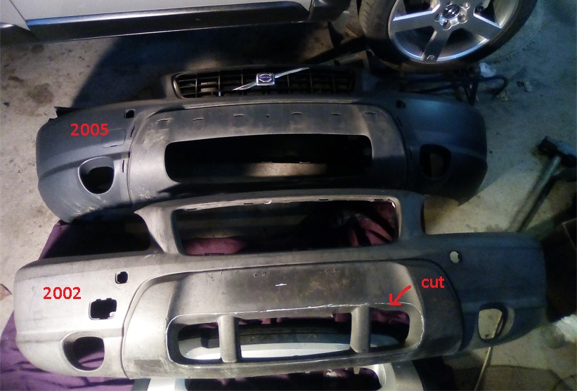

My 2005 xc70 bumper cover has too many broken and missing tabs, so i decided to see if i could update my spare 2002 cover that only has one broken tab to the 2005 styling. cutting the mouth is the easy part, the mounting slots was a challenge.
For glueing the PP cover JBweld plastic weld seems to be holding strong
