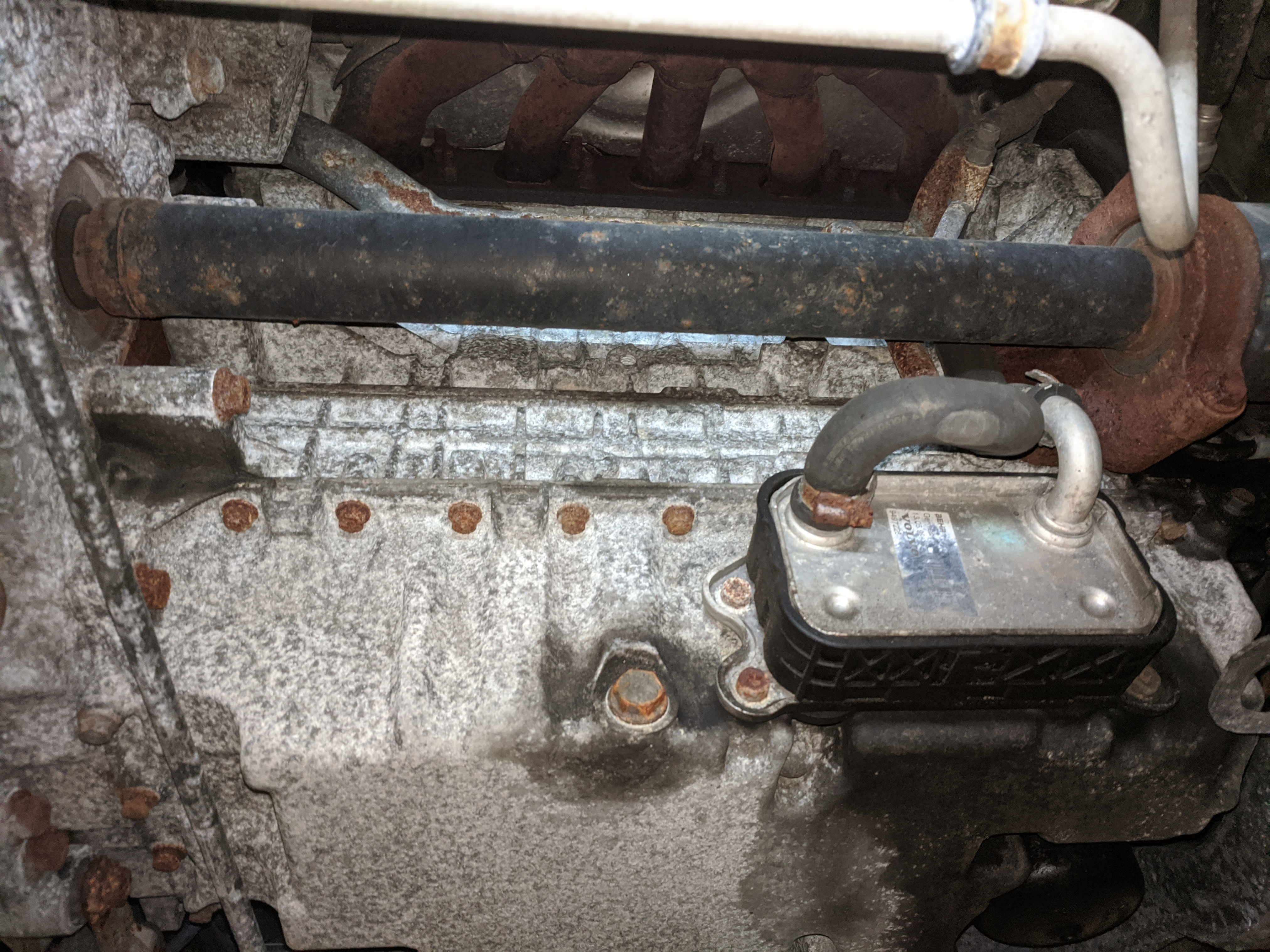

I have an oil cooler and all the black staining around it suggests its leaking slowly. I will install two new seals between it and the block, hoping that stops the leak. The hoses, however, look dry at all of their junctions.

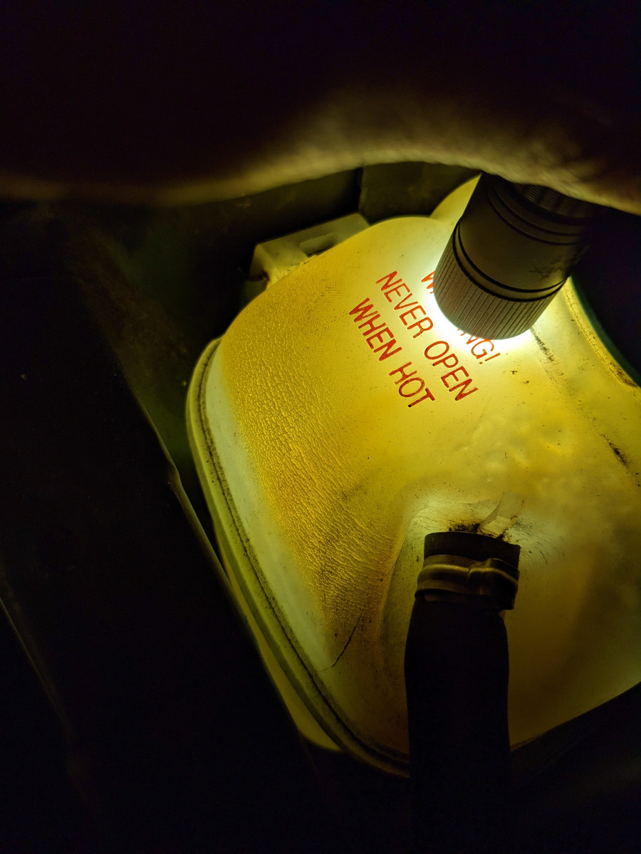

I just checked my coolant tank while it was dark out and could clearly see where it's slightly leaking at the seam. Also, the area near the top hose is more red than the rest of the tank. When I held a flashlight up to it, it looked like a shattered windshield; a huge network of fine cracks. This also revealed a crack by the top hose. Who knows how many other cracks and brittle areas there are.
$140 well spent.
