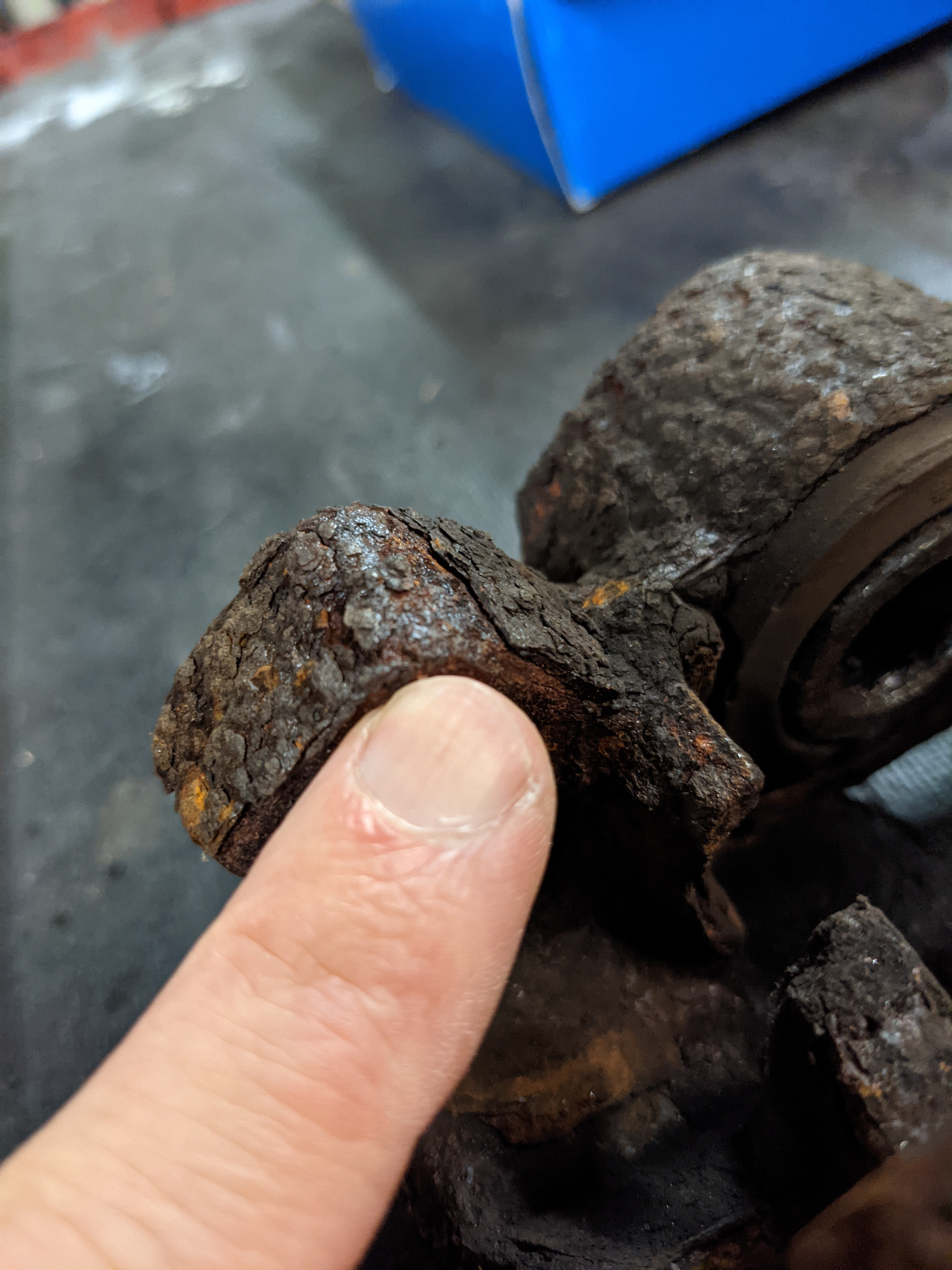

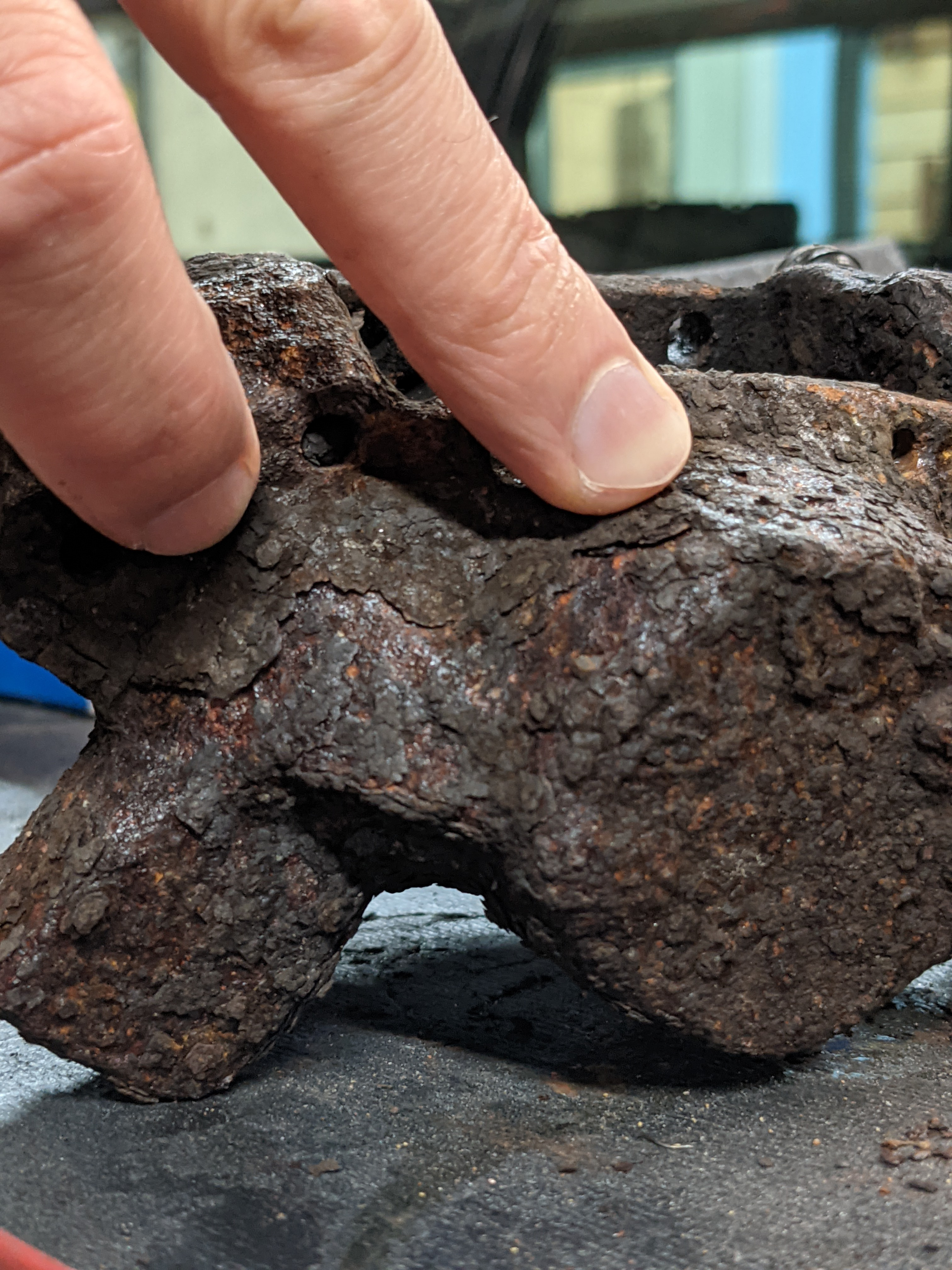

I spoke to a company about powder coating my calipers for rust protection. They were wary to do it if there was "missing metal". I just rebuilt my right rear caliper and it's internally perfect, but the outside is gross with large sections flaking off. Is there a good way to remove these flakes to a stable core so it can be coated?
FireFox31
- Posts: 36158
- Has thanked: 1611 times
- Been thanked: 4073 times
You bash them with a small ball peen hammer

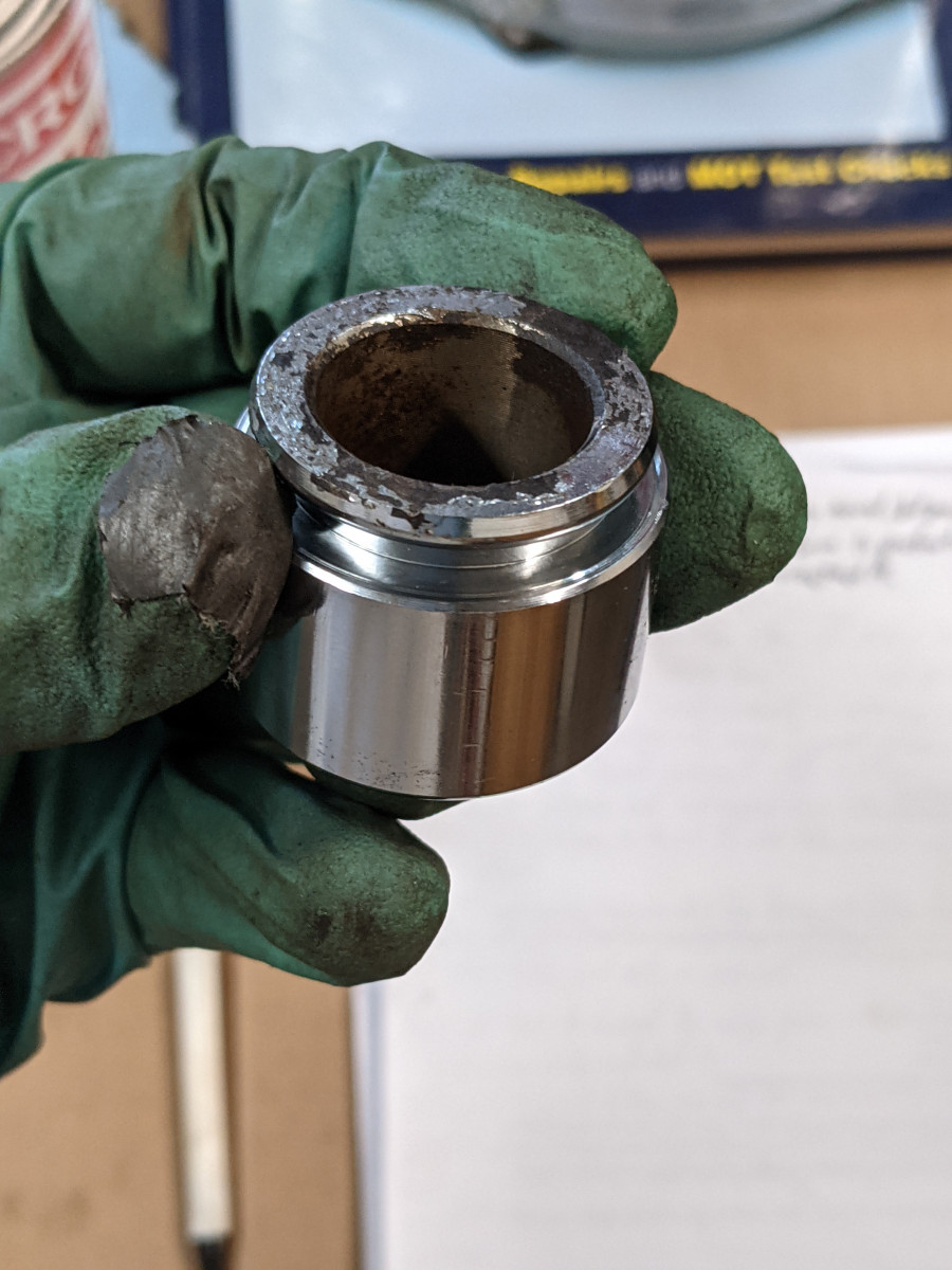

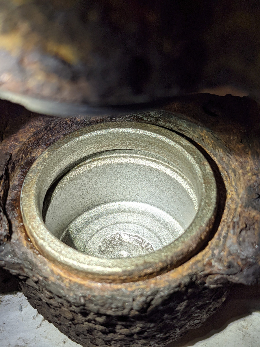

Thanks, but I've realized that I should not waste any more time (especially someone else's) on these calipers. It's time to quit when the fitting bolt hole threads have contracted from rust, and the bleed screw has become frozen in place over the last nine months and snapped off. I blame the parking brakes for dragging, generating heat, promoting rust, so rebuilding those is where I'll put my efforts.
I just ordered rear left and right remanufactured calipers, new springs and pins, and the three rear brake hoses and clips. My safety is worth the $500.
For reference, do the inside of these rusty calipers look good? The piston had a few slight nicks and the photo seems to show pitting, but I didn't see it in person.
It's odd that the piston faces are flat and don't have the 40% cut out section like the new ones. Are these original calipers, or maybe cheap rebuilds?
