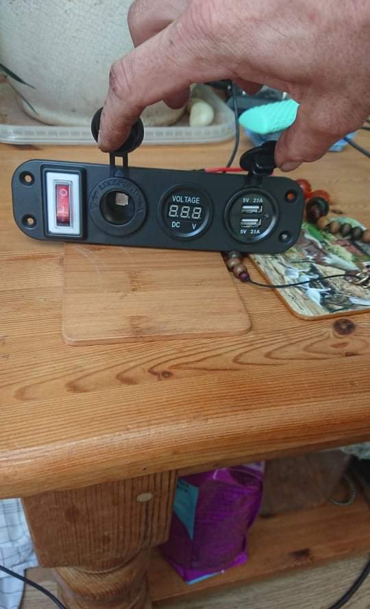

I want to build a power hub that is separate from the car for camping so we are not using the power durin the night.
Using this
I want to essentially create a power station for in the tent to run a cooler fridge tent lights and chargers for phones / cameras.
