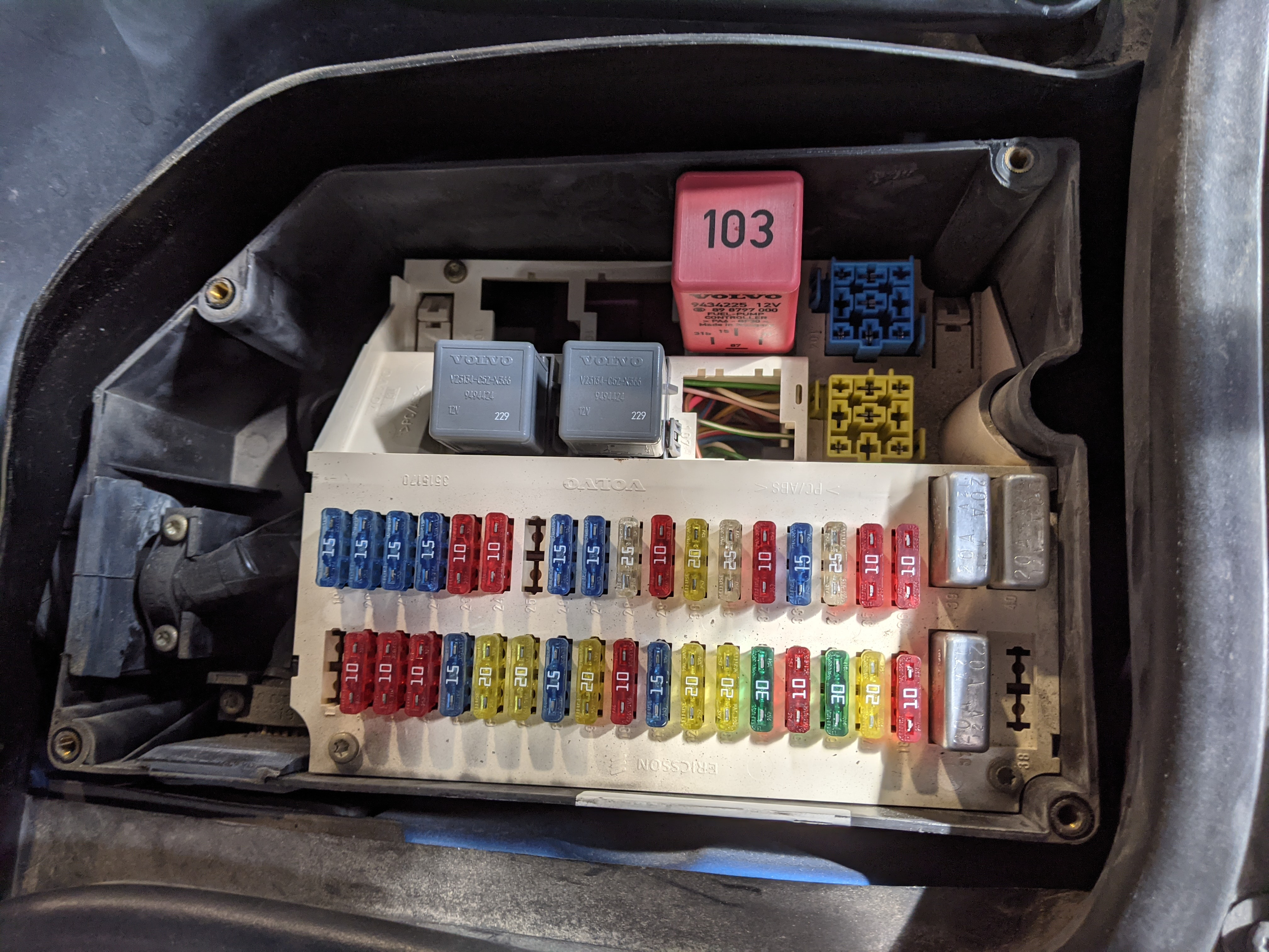

I have attached the pictures of the main fuse box for my car below. This looks different to all the ones I can find and there is no info I can find other than the self explanatory Light Relay as to what the rest are. Any one able to 'enlighten' me?
Appreciate any help/guidance.
I have found a new electrical portion of the ignition switch but don't have a spare light relay. Looks like PnP may be on the cards tomorrow!
What I am trying to find if this car has the 'Power' relays and if so are those the smaller gray ones on the lower LHS of the relay section? Headlight relay is removed and fits in the blue/yellow plug ins on the RHS.

In Canada you guys have mandatory Daytime Running lights or DRL. WE can toggle ours on or off in the States with a little switch on our light switches you turn with a small screwdriver, your switch won’t have that unless someone has replaced it with a liberated one from South Canada.
Thst mightbe worth checking. The wiring would be different.
103 is your fuel pump relay. They got better on the 1999 amd 2000 models so we don’t have to carry them around like the rest of the plonker P80s
The grey ones are X load reduction relays for various things that use high current, but are turned off when you crank the car ( headlights, wipers, blowers, heated third seats , etc)
Next time you read someone post how you can diagnose a bad battery by watching the headlights while cranking, you can admire the flow of worthless information on the internet from afar.
