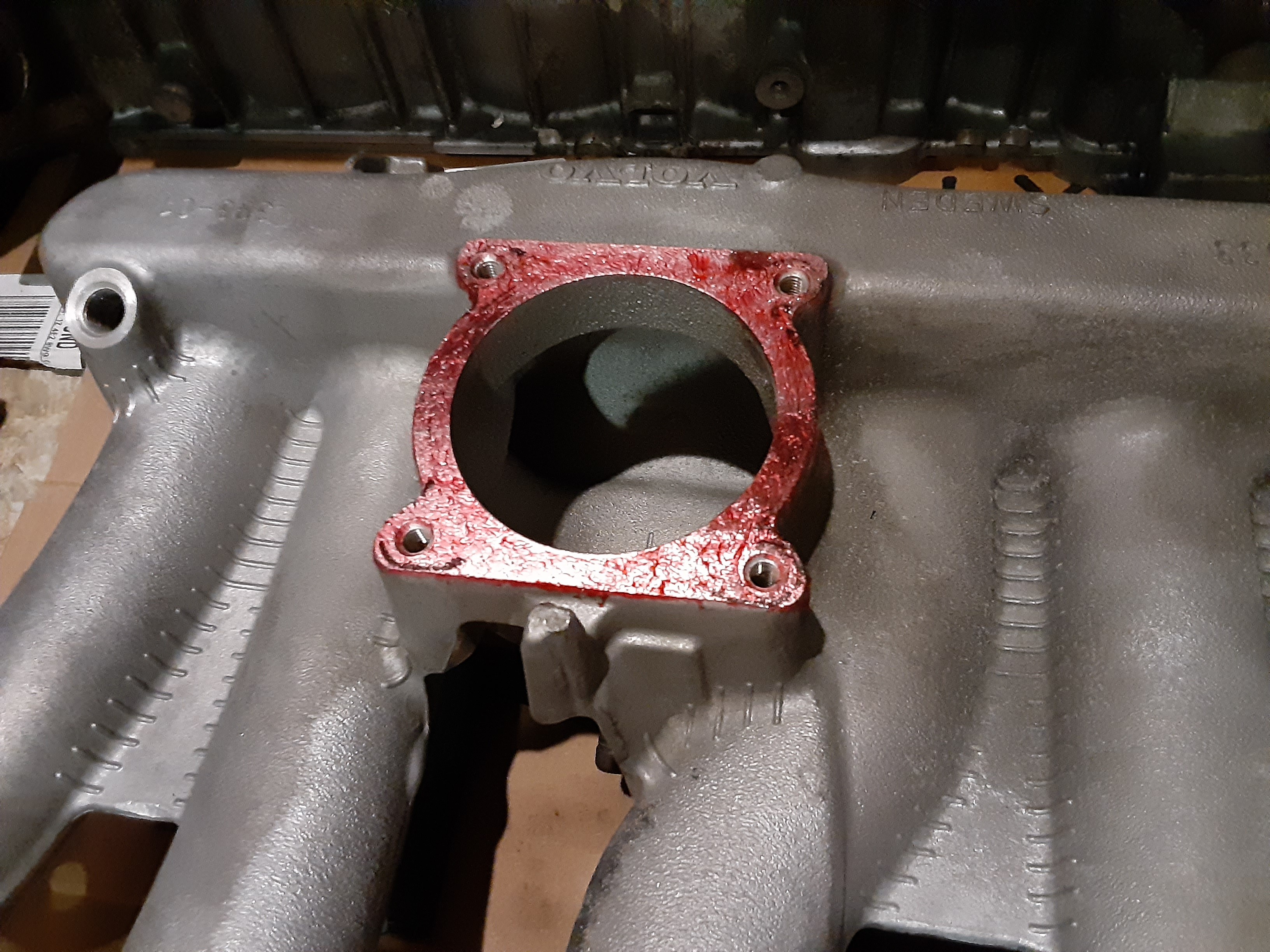

Moving on to the intake.
Yes, purists may scoff and tell me I need to use an actual gasket on the throttle body but I say EH, this engine's full of chemgasket. A little more will be fine.
