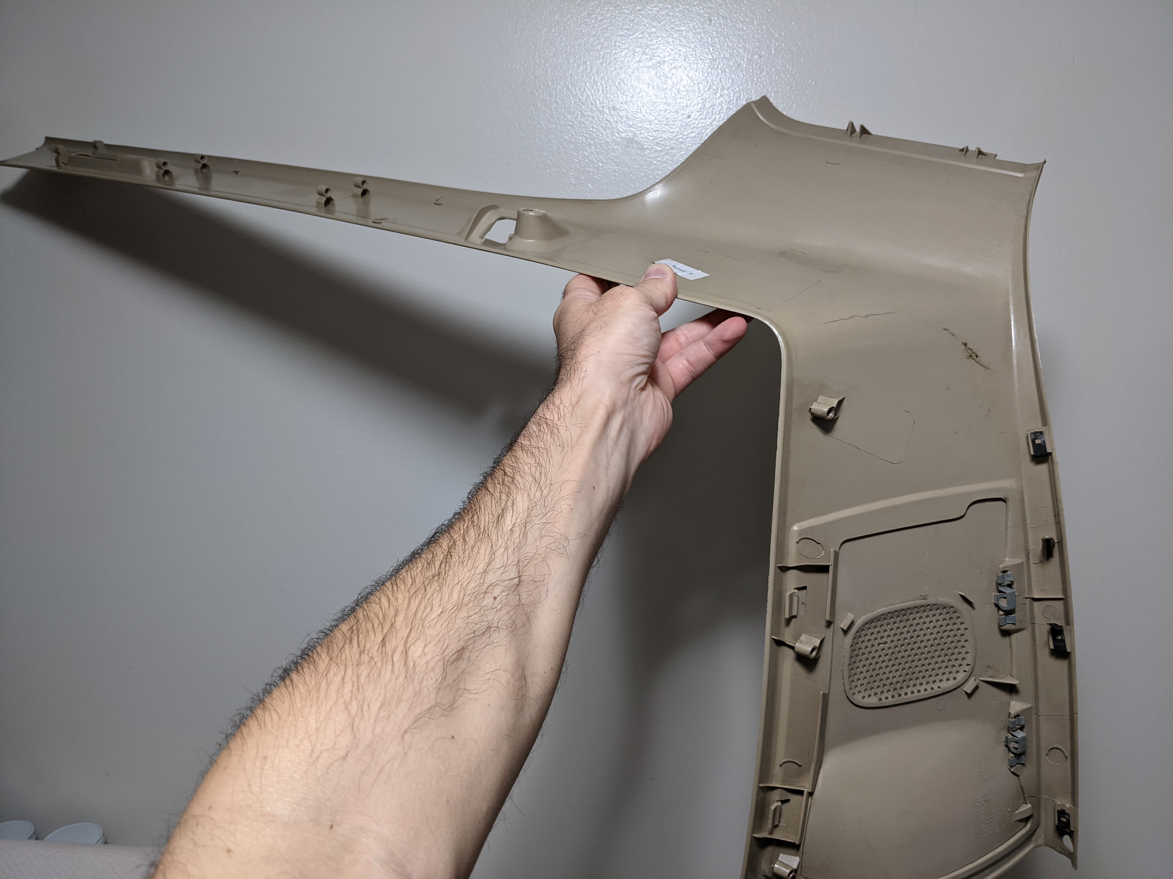

Here's the trim panel above the rear window on a 2000 V70 in case it's at all similar to an 850. There are many cylindrical points on the trim which are held by C clips on the ceiling. Similar C clips are used on the window side of the D pillar, part 3539879. On the trunk door side of the D pillar, there are metal clips, part 31389804. Many of mine broke and I had to order them from a dealership.
