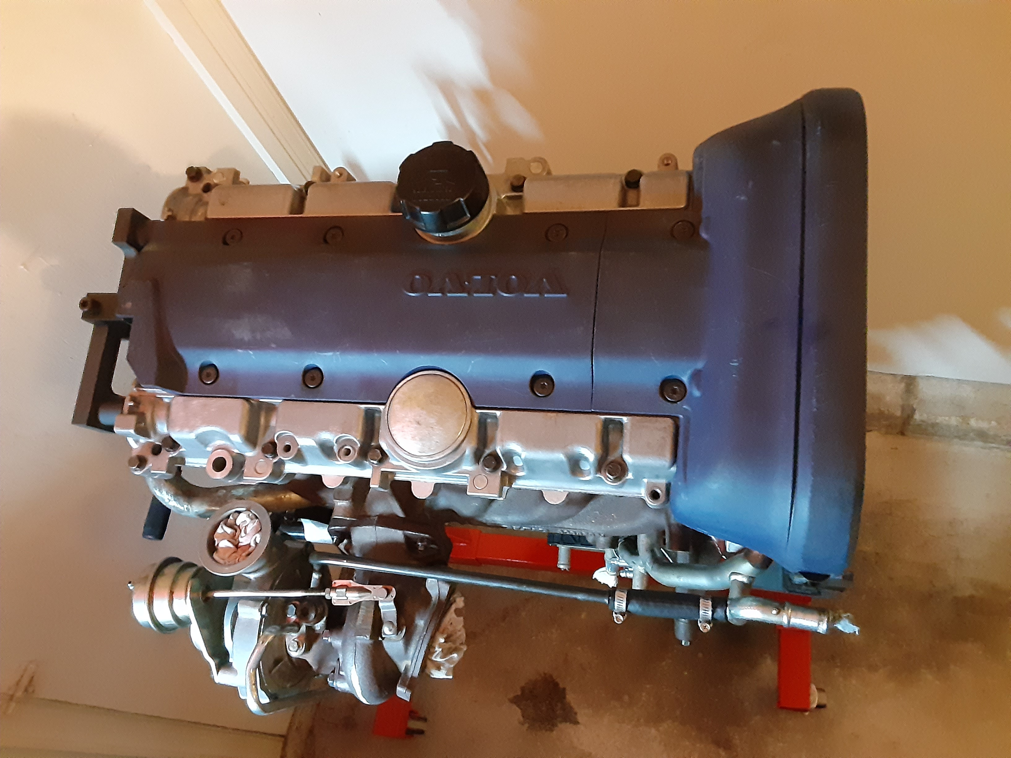

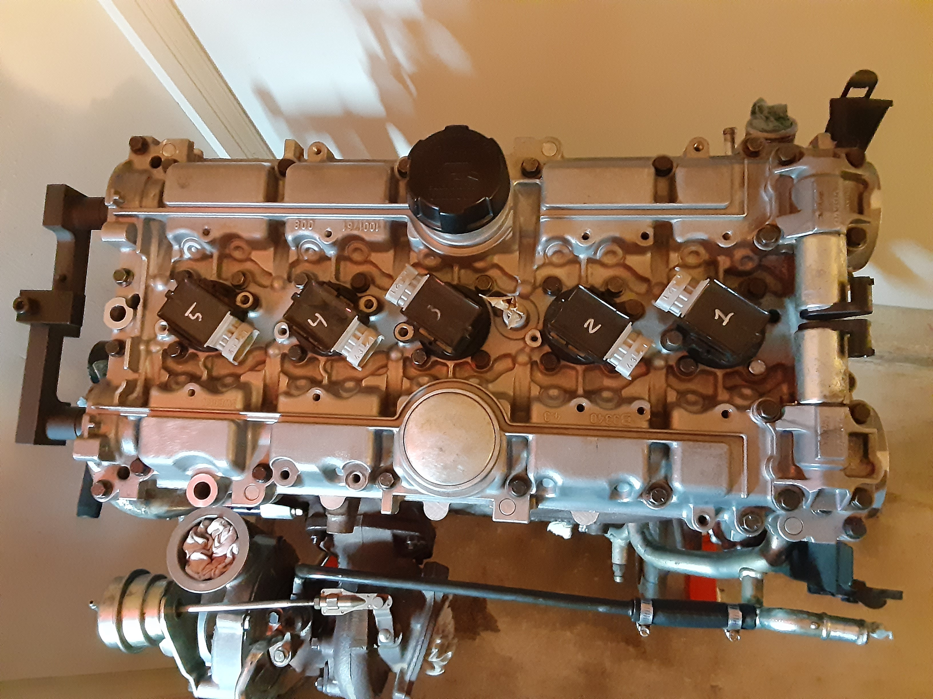

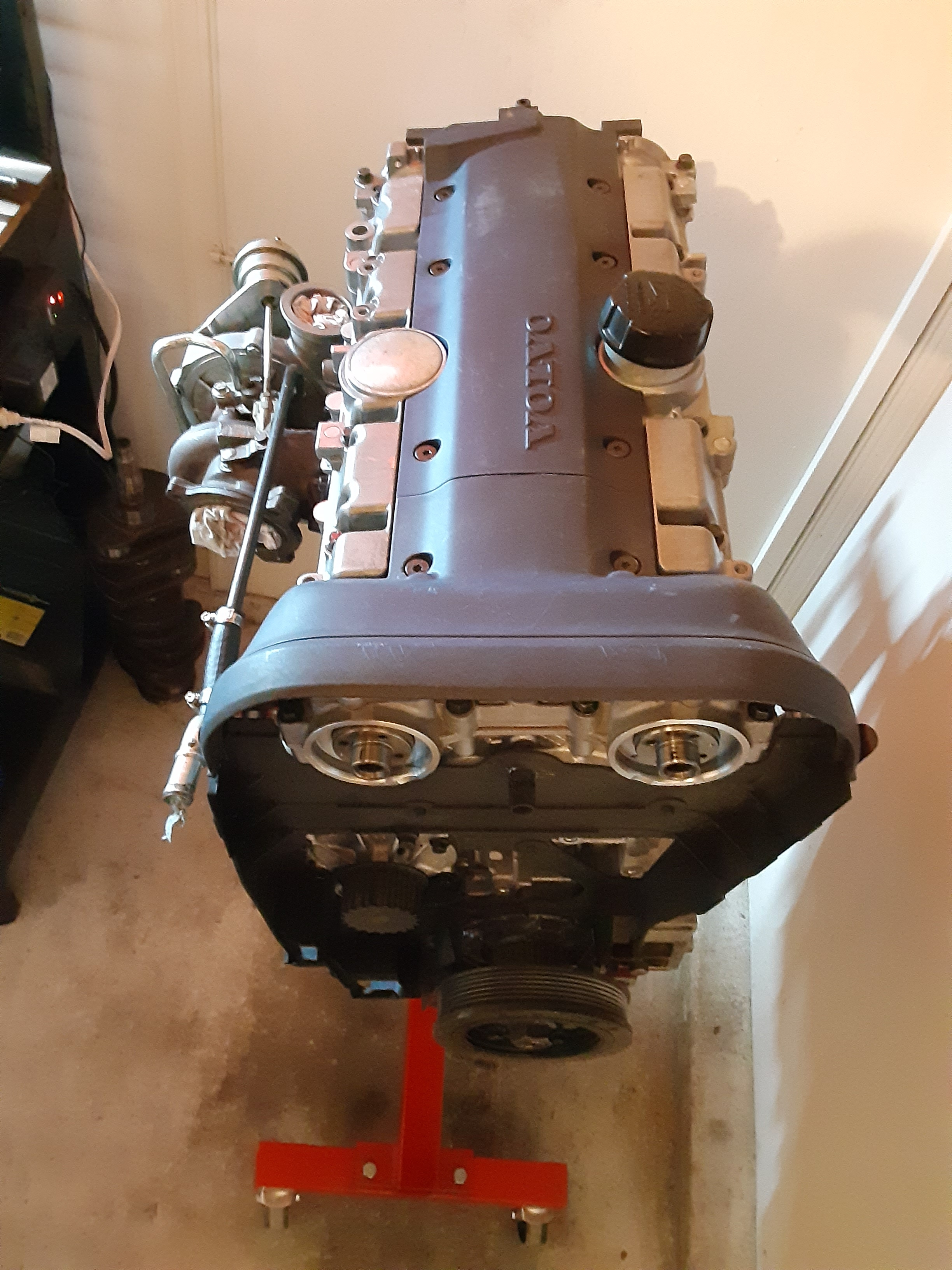

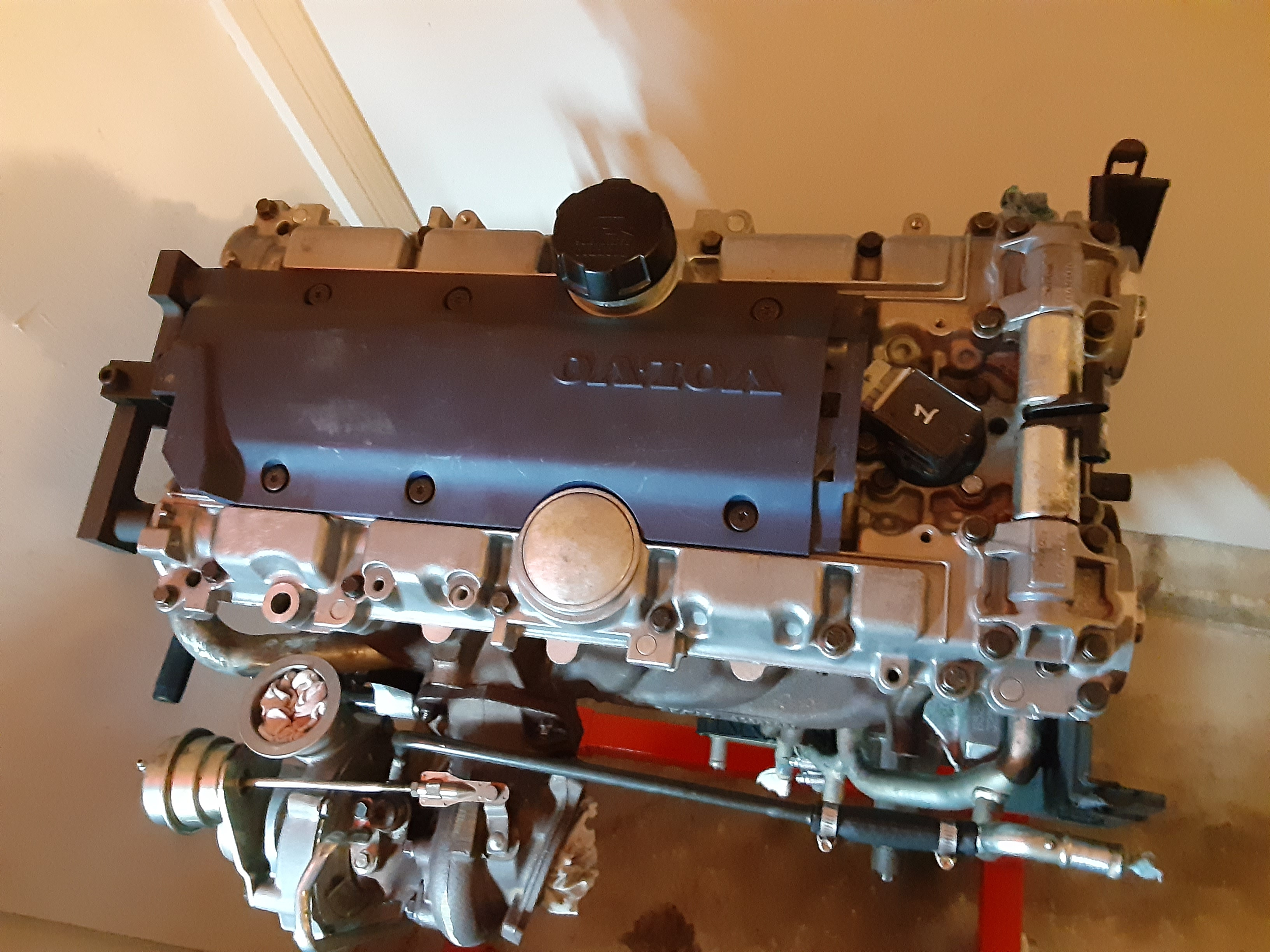

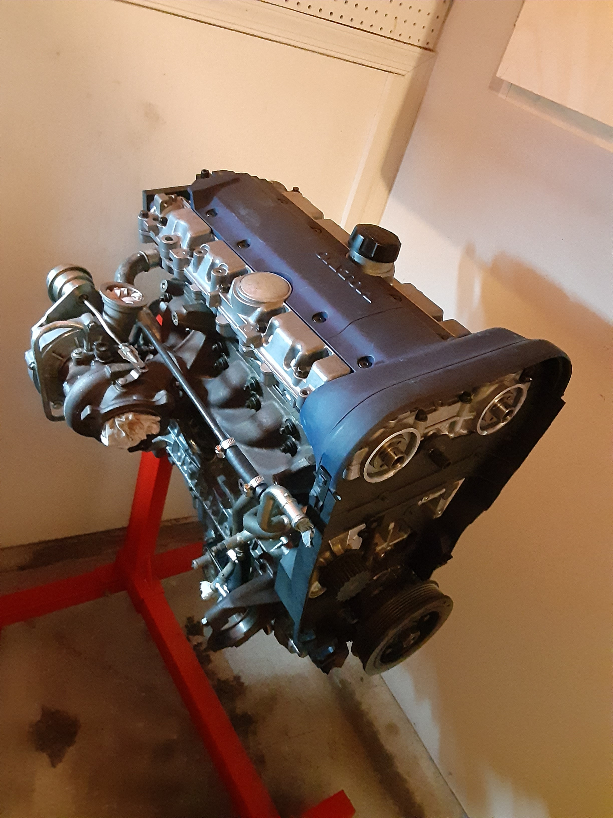

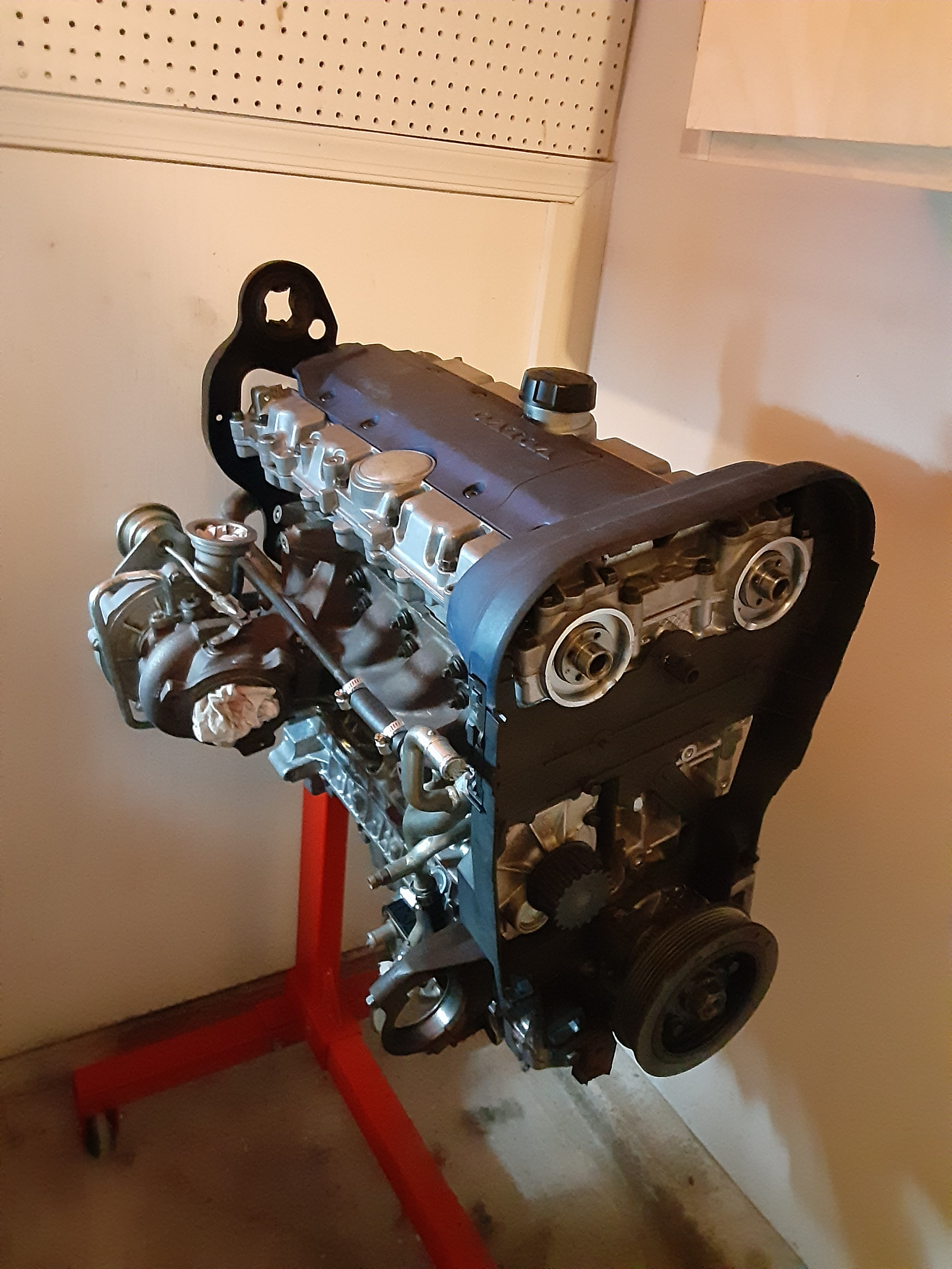

Added the coil packs. There aren't any spark plugs yet, but I want to keep junk out of the plug wells. I also added the upper covers in order to align the CVVT gears...and to see how they look.
Interestingly, the way it's leaning on the engine stand is about how it'll sit in the car - look at the oil cap in the front view.

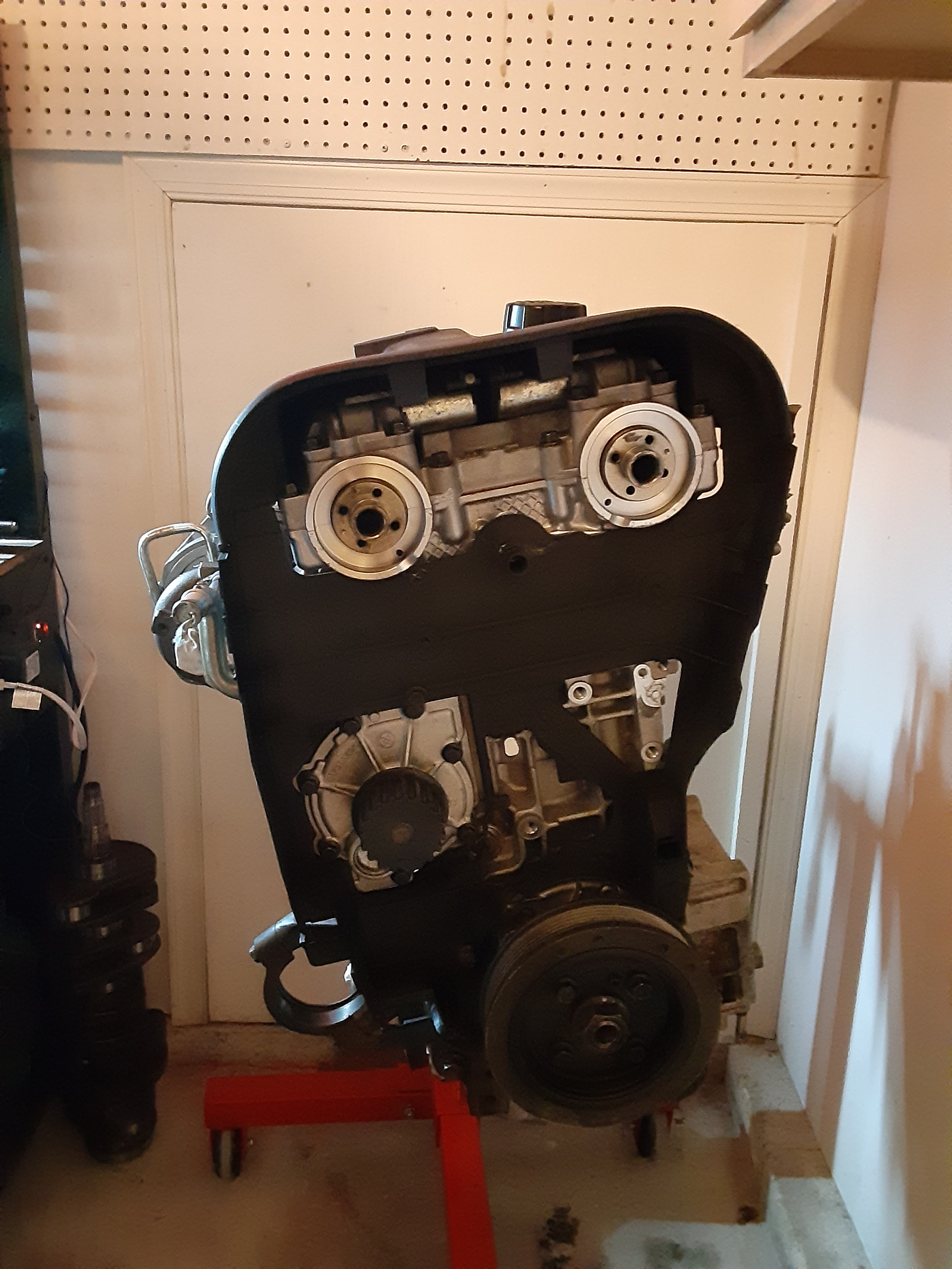

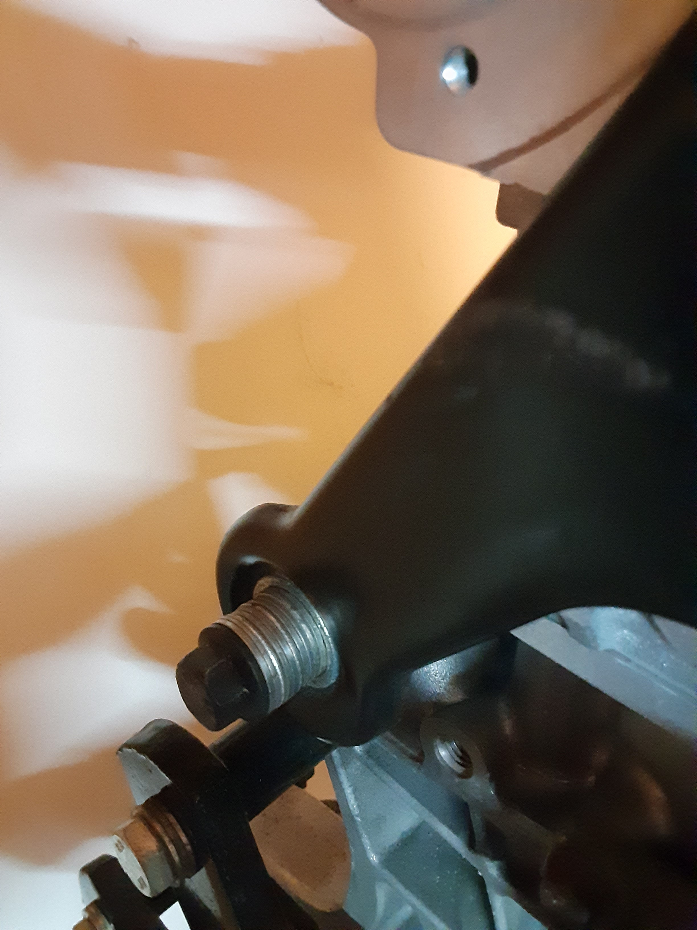

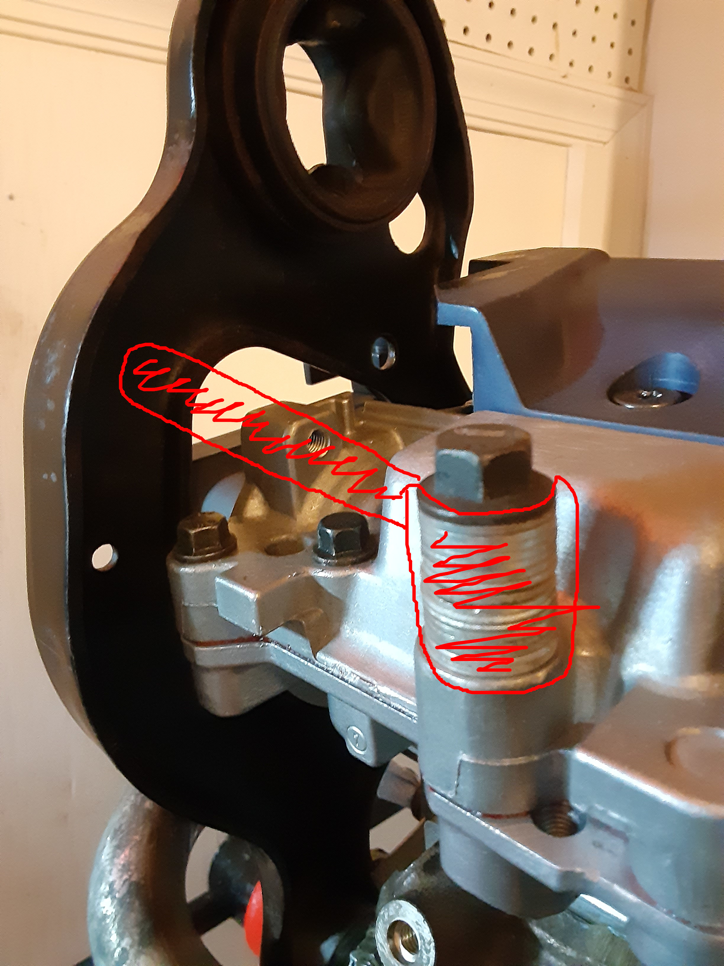

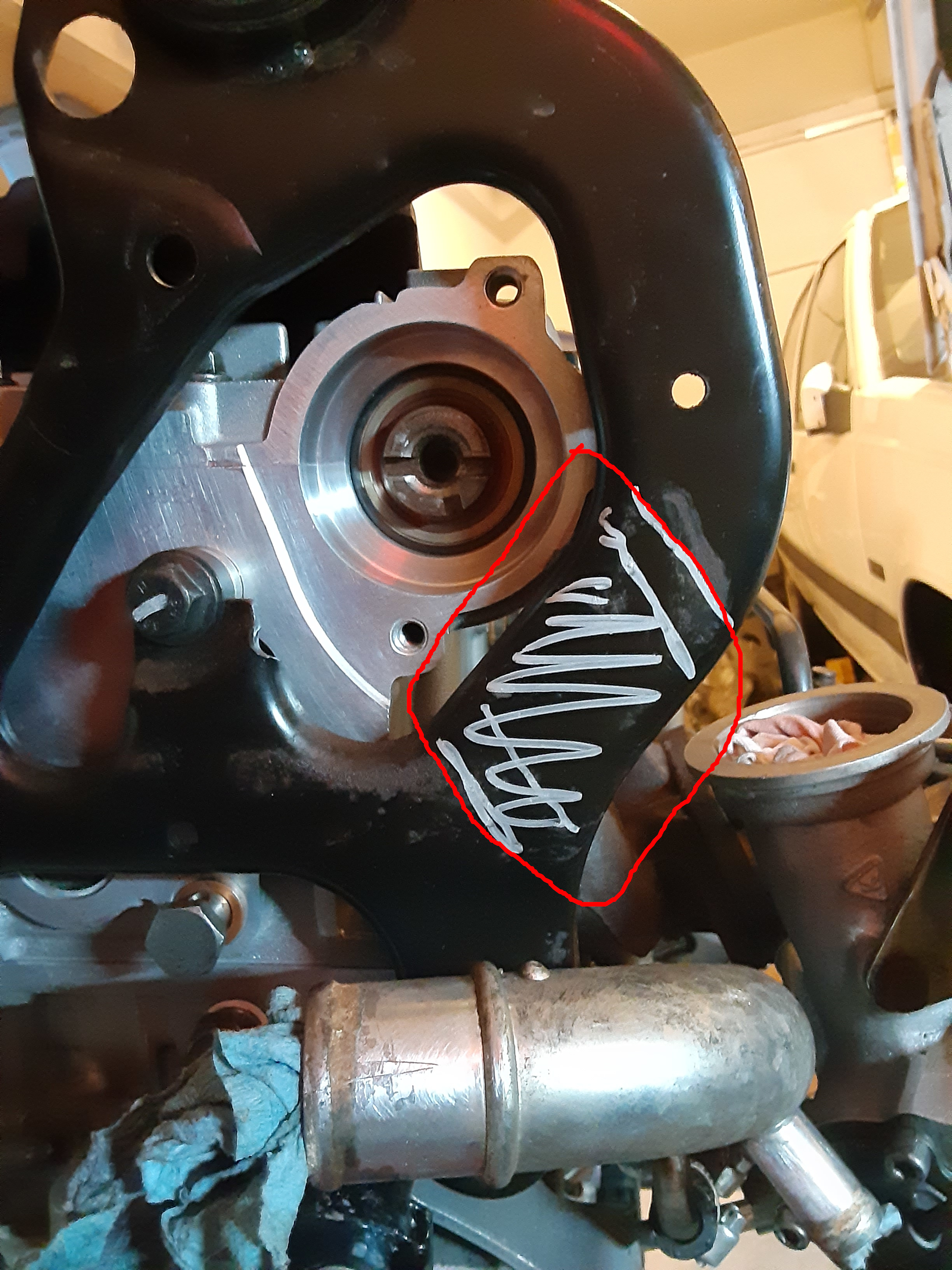

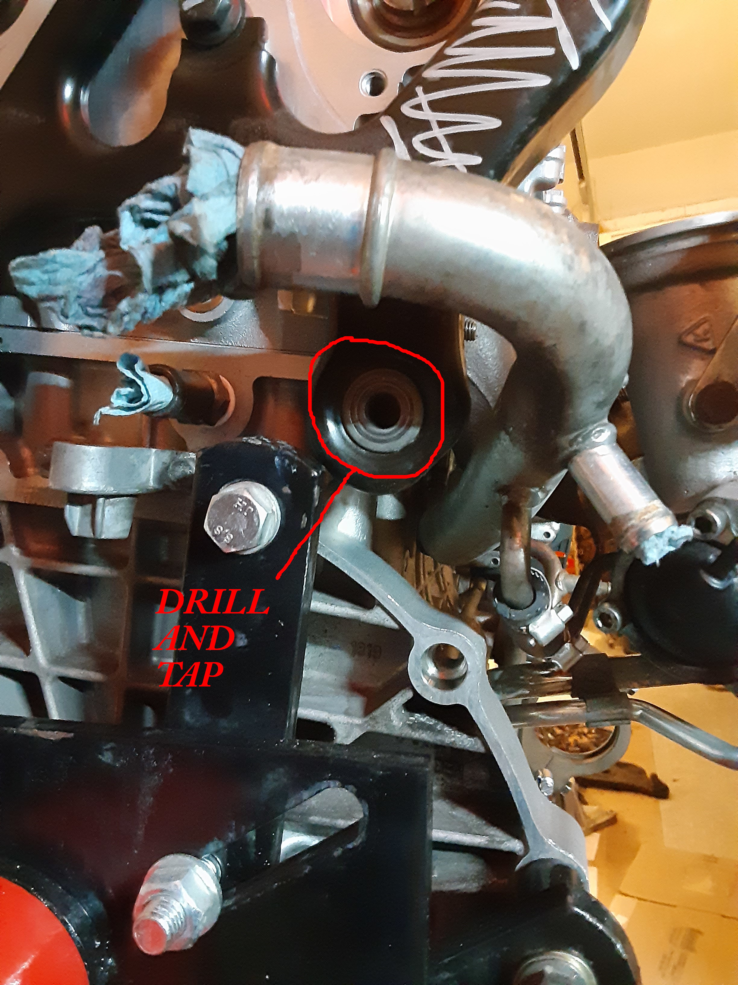

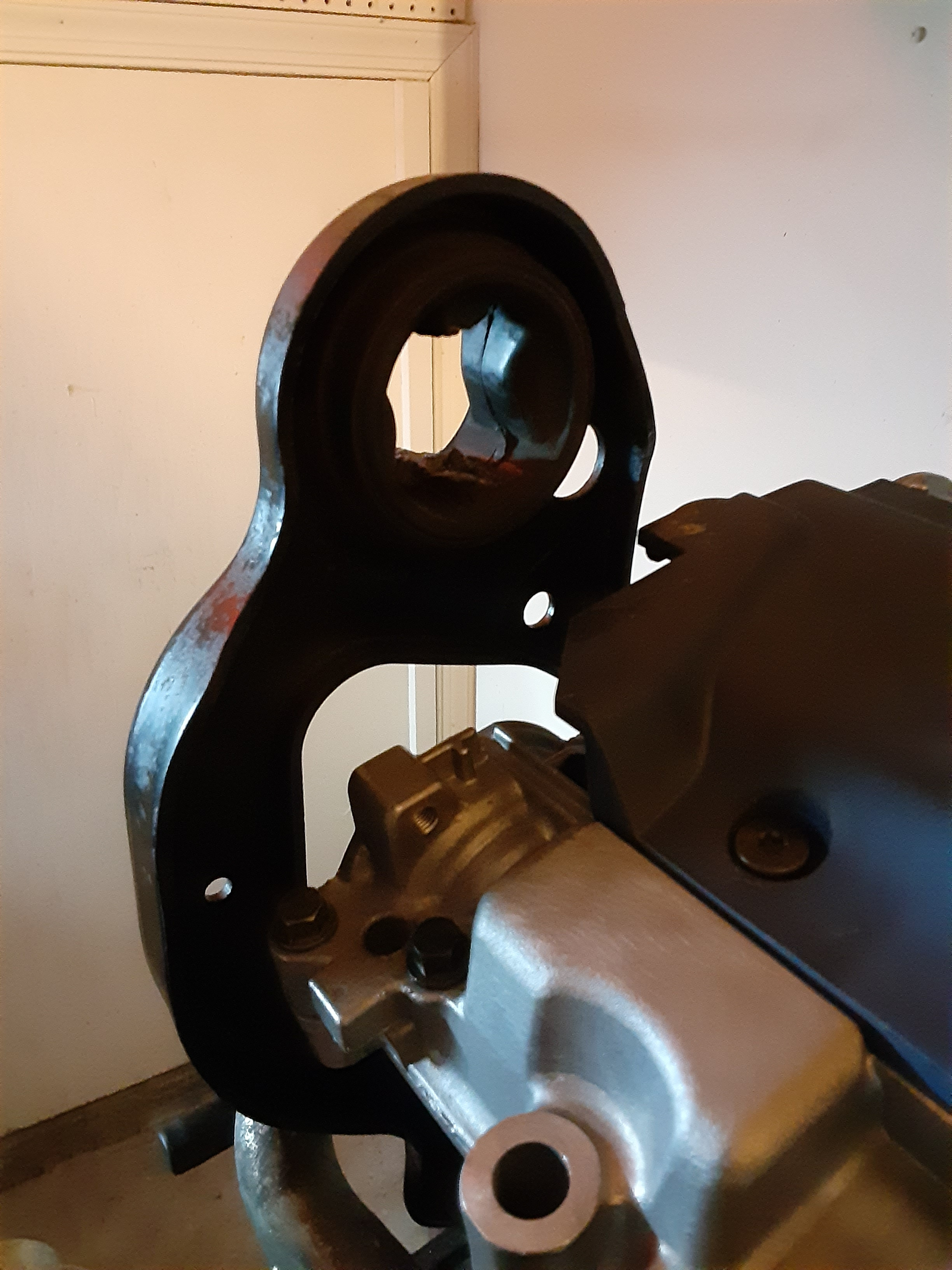

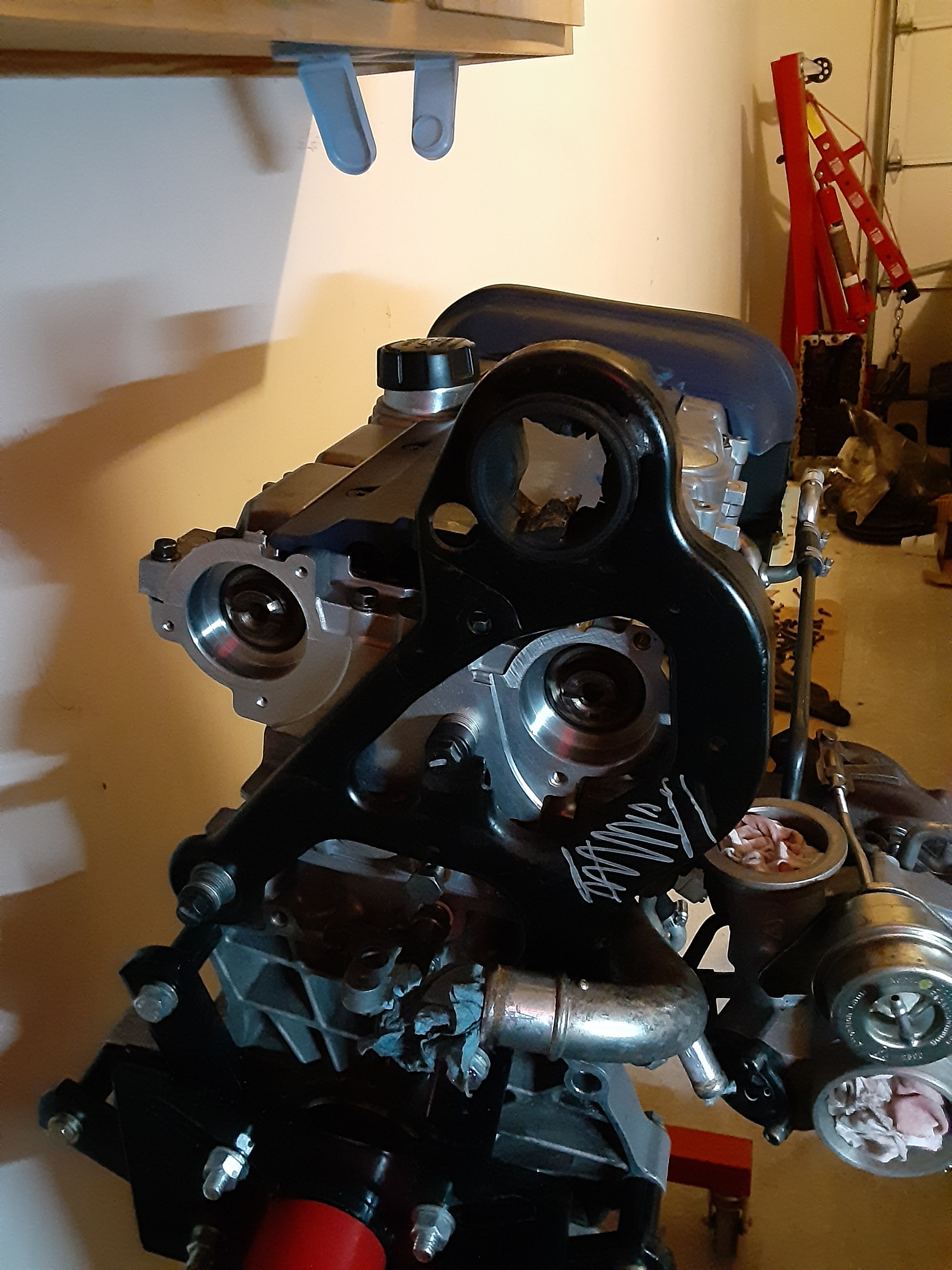

I was feeling industrious today, so I decided to see about the upper engine mount.
Here's another reason this job isn't a direct bolt-in. The B5254T mount will fit the engine, but doesn't place the upper attachment point correctly in space relative to the car's firewall. The B5234T upper mount that came with the car will properly locate the B5254T in the 850's chassis, but it won't fit the engine without a few mods. Notice the stack of washers needed to space the mount away from the head, which will be replaced by a short length of the same tubing I'll use to fab the front side mount from earlier.
One hole in the block will need to be drilled and tapped.
The mount itself will have to be cut up to clear the exhaust cam sensor housing, with a reinforcement built out away from the sensor.
And a brace rod will be needed to stabilize the mount in the Y-axis.
It's Johnny Cash's Volvo.

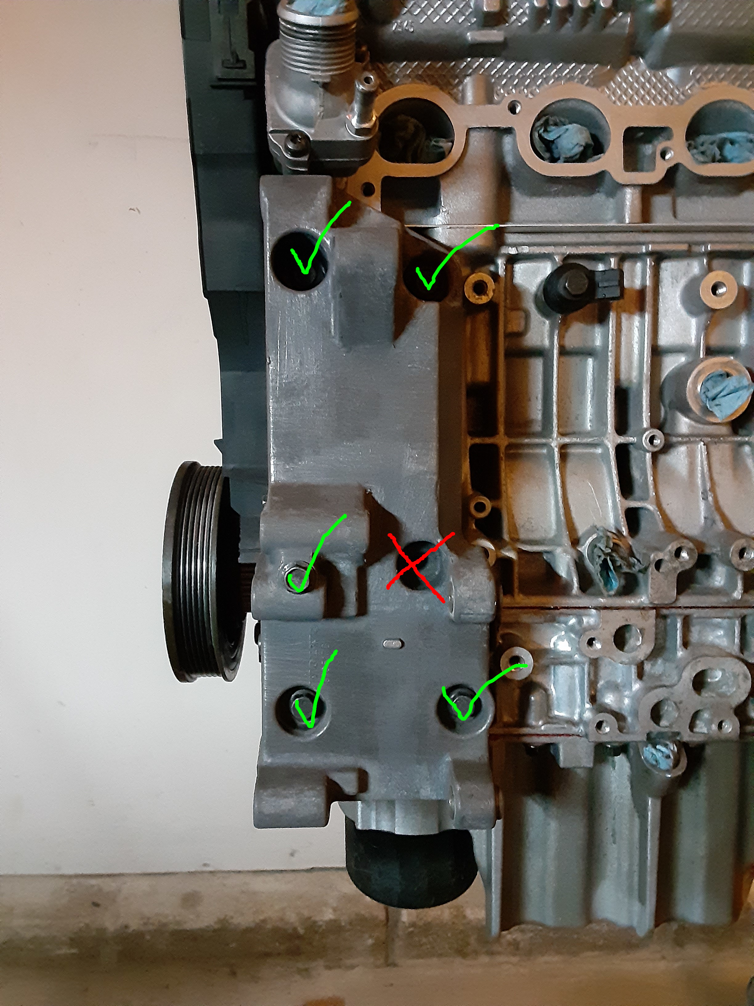

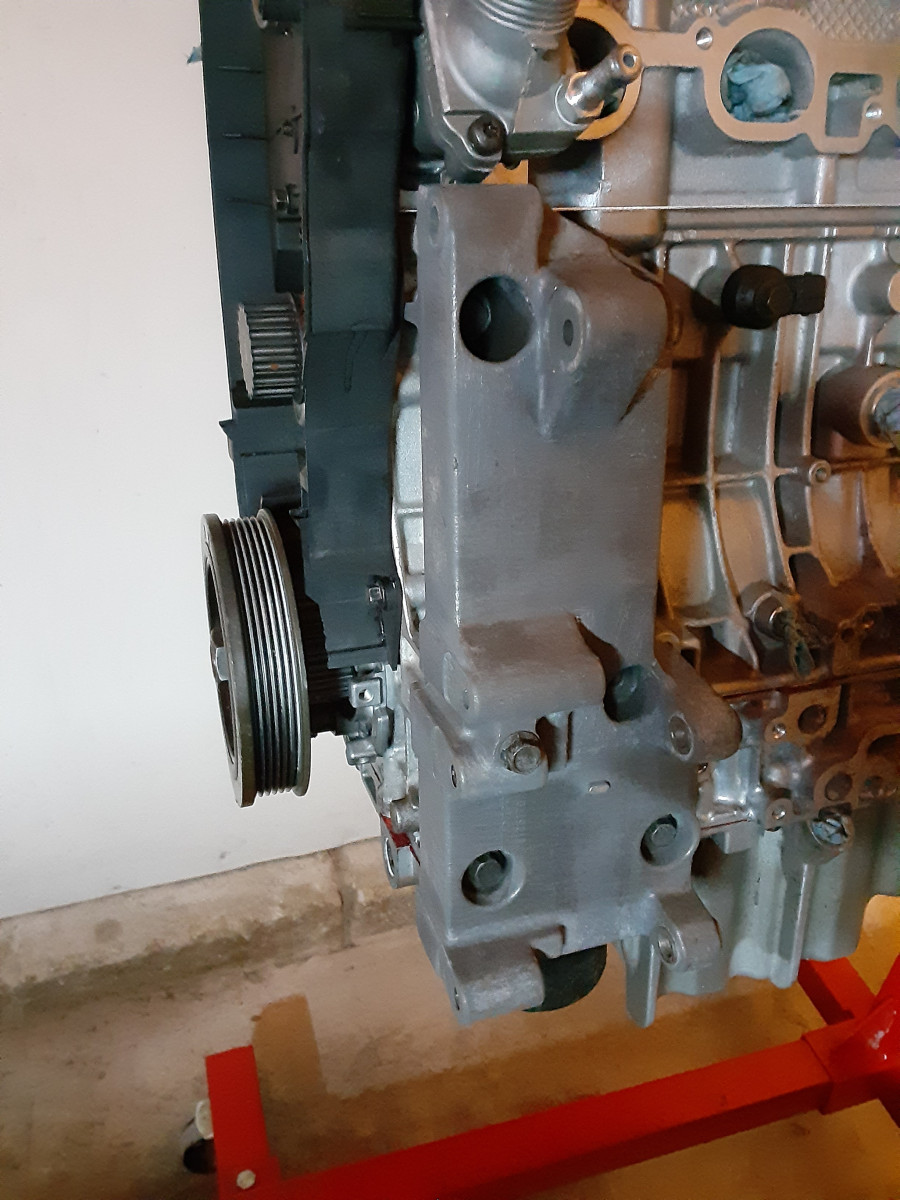

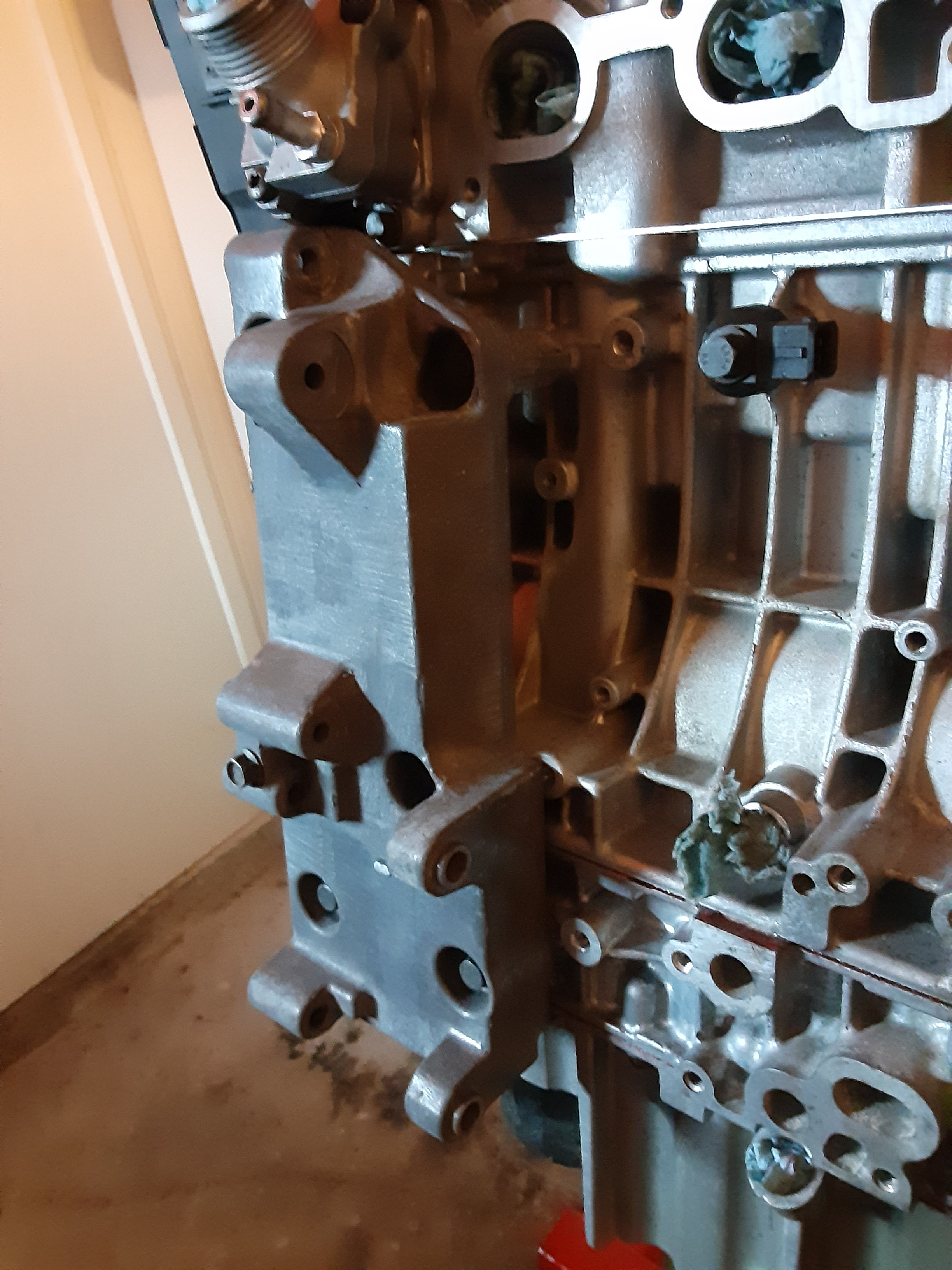

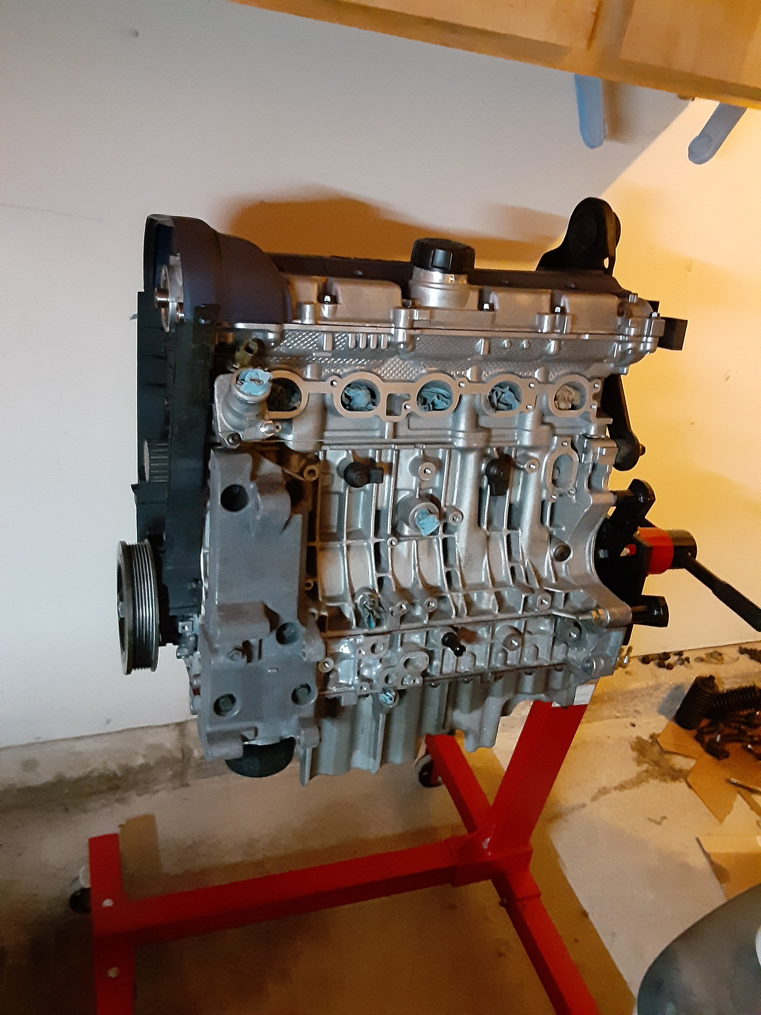

Yay! The B5234T's accessory bracket fits!
It only gave me five out of six bolts, but I'm calling that a win.
