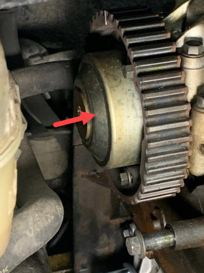

In doing the crankshaft seal on my 2001 XC70, the videos I have seen bypassed the removal of that cut and went straight into the seal replacement. I had seen a video where Robert mentioned that device is spring loaded. I need to replace the crankshaft seal.
In VIDA, the parts or removal section does not show that cup like shown in the photo above. I also searched "crankshaft" in parts store or Google, I still could not find such.
Any directions please?
Thanks.
Thanks.

True, but how it it removed. Can’t find instructions.vtl wrote: 30 Sep 2021, 07:30 That cap is your VVT hub. Yes, you have to remove it for seal. On your model year it is spring-loaded.
