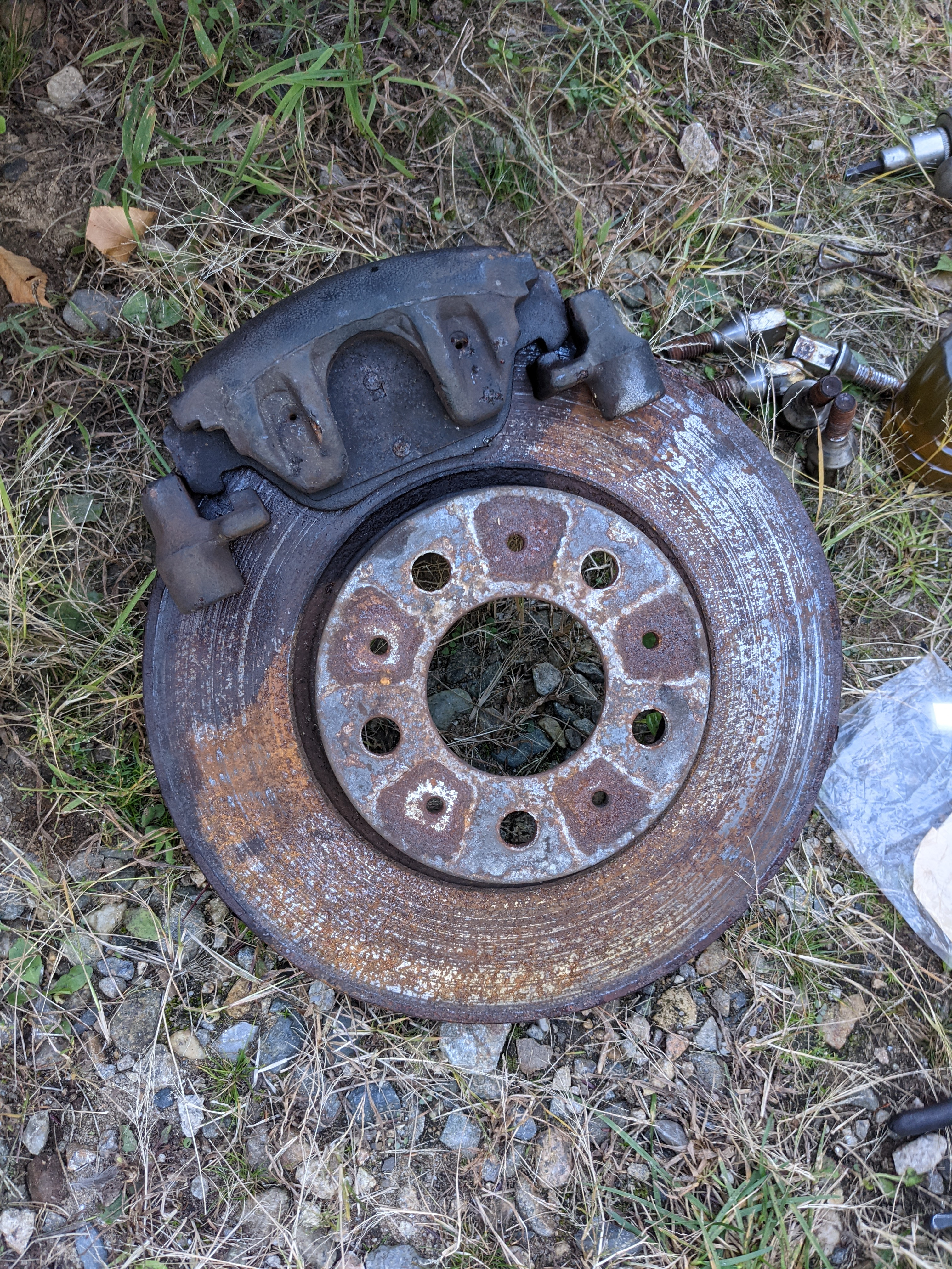

The next challenge is breaks. Any advice for how to free the pads rusted to the rotor? That's penetrating oil on the rotor, having tried desperately to free it. The front suspension is more rusty than any I've seen. Is it more than just surface rust? How much of this should I reasonably replace? The power steering rack sounds funny. When I pull one of the front wheels (moving them both and the steering wheel), I hear squishy sounds from the rack. I don't think a healthy car sounds like that. The power steering fluid is quite low. Maybe it's trapped air?
Ultimately, I want to find any deal breakers before any money is spent. What else might send this car to the junkyard because it's too difficult or expensive to repair, and how can I find these things?

Top off the PS fluid and make sure you don’t have leaks , the rack is a big job and could kill her.
That suspension is gnarly but if the struts and springs are doing their job that can wait for the last step when you know there are no deal breakers. I think rack and transmission are your last two big things.
