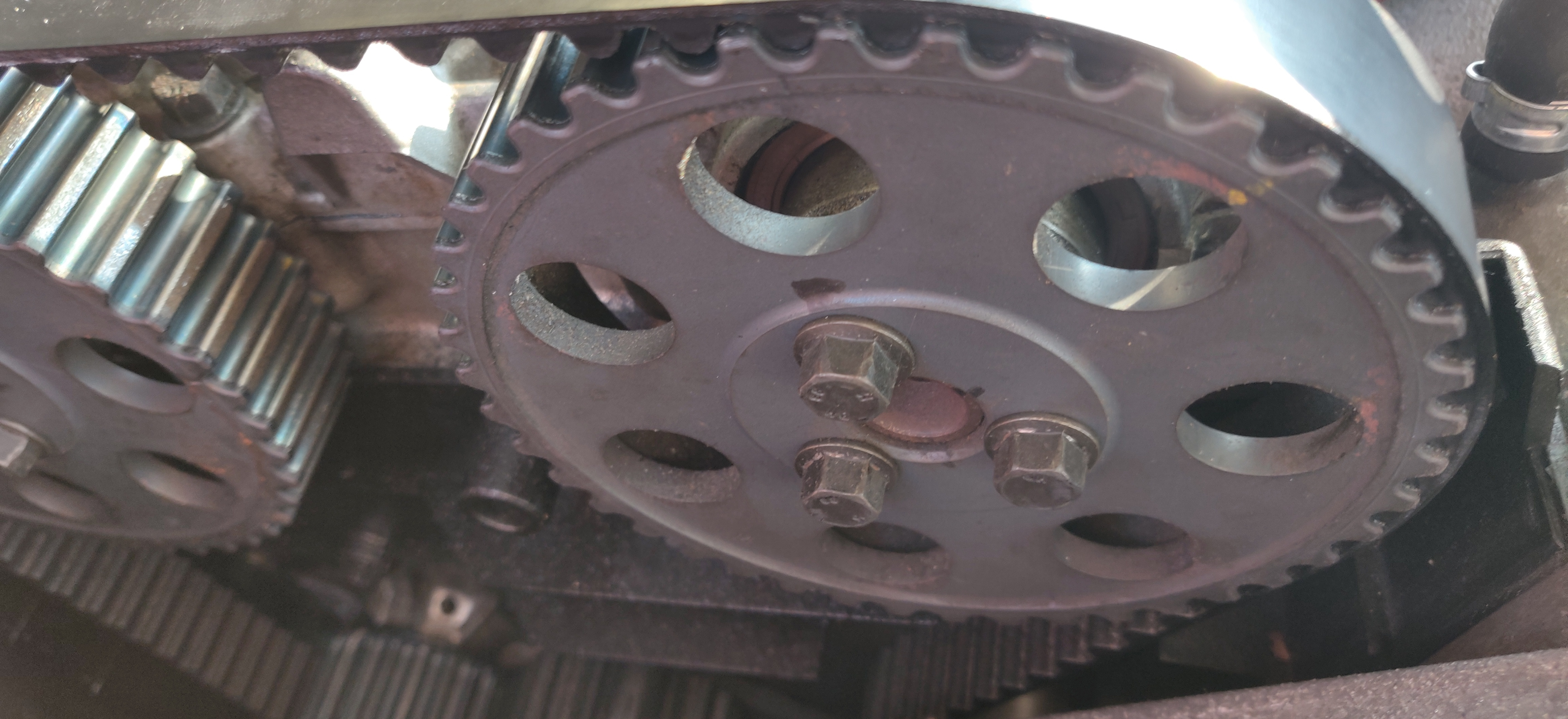

Ok, I found the cam timing marks.
Having trouble finding the top dead center marks on the crank pulley.
Help anyone?
Help anyone?

Sufbug wrote: 09 Oct 2021, 17:35 Ok, I found the cam timing marks.
Help anyone?
On the timing belt pulley, there's a tooth with a notch on either side. The red lines indicate the notches on both sides of the #1 TDC tooth. It looks like this:
There's also a raised bar on the pulley mount, which is in line with the TDC notch. It's the silver part in the picture.
Hope this helps.

- Posts: 36145
The timing mark on the crank pulley is notTDC , it’s a non interference markSufbug wrote: 09 Oct 2021, 17:35 Ok, I found the cam timing marks.
Help anyone?
It can be either the scribed lines or the notches in the inboard side of the pulley teeth. You have to look for both on an old car that may have been reworked
If you set the cams to the angled mark the crank will be close enough to see the marks.

abscate wrote: 09 Oct 2021, 18:04The timing mark on the crank pulley is notTDC , it’s a non interference markSufbug wrote: 09 Oct 2021, 17:35 Ok, I found the cam timing marks.
Help anyone?
Could you clarify? I'm pretty sure that's the mark for #1 TDC. It's not like there're any other marks on the pulley.
