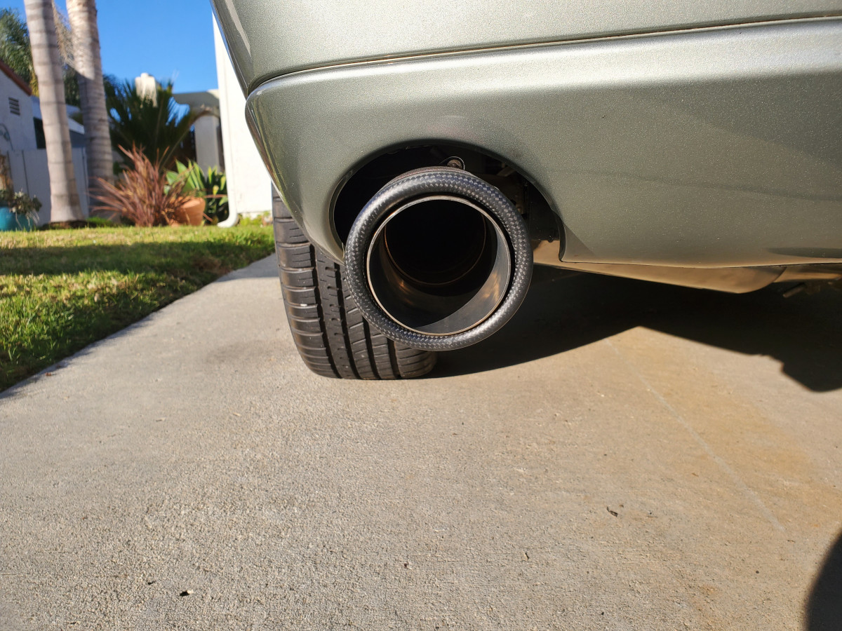

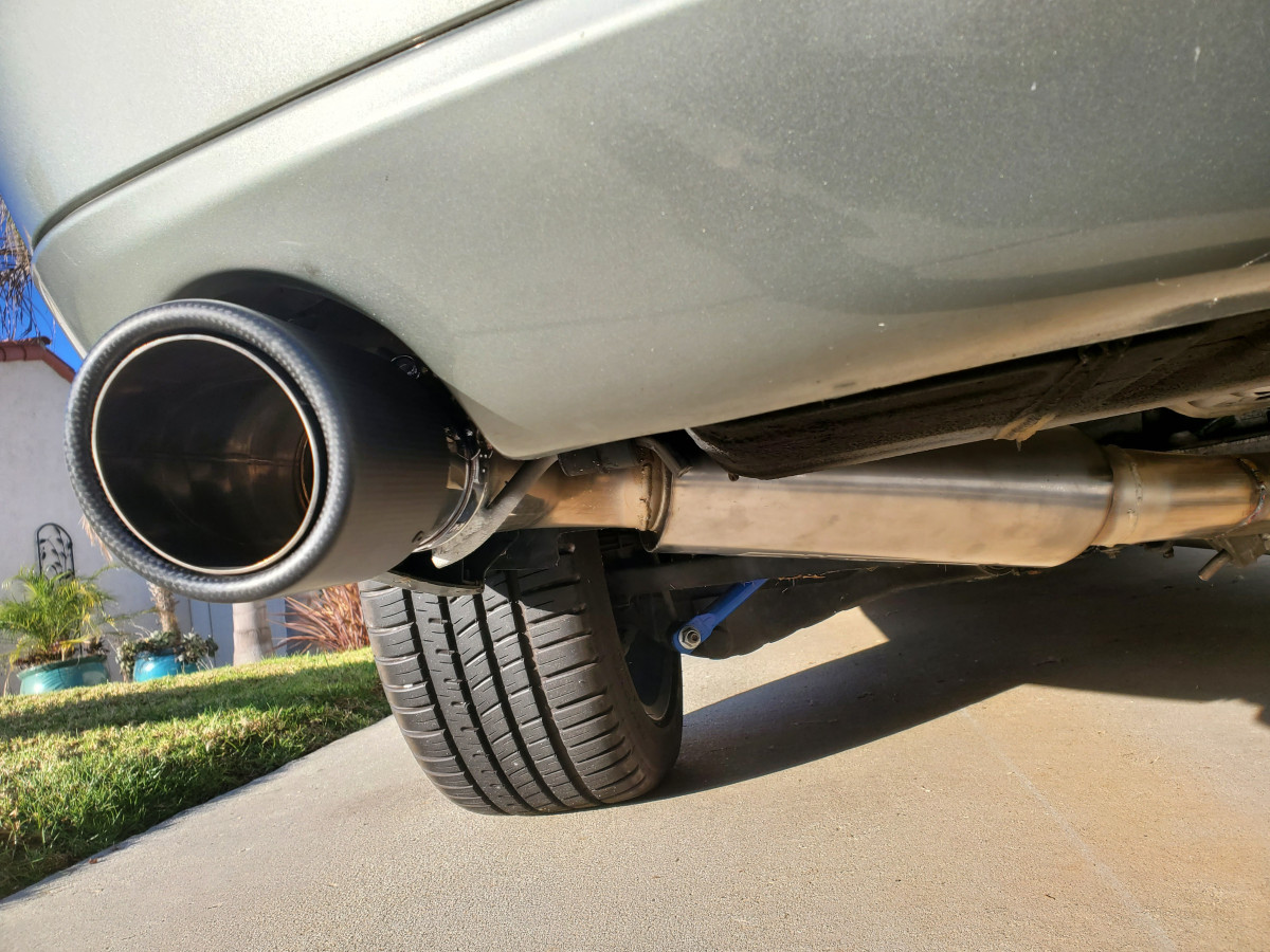

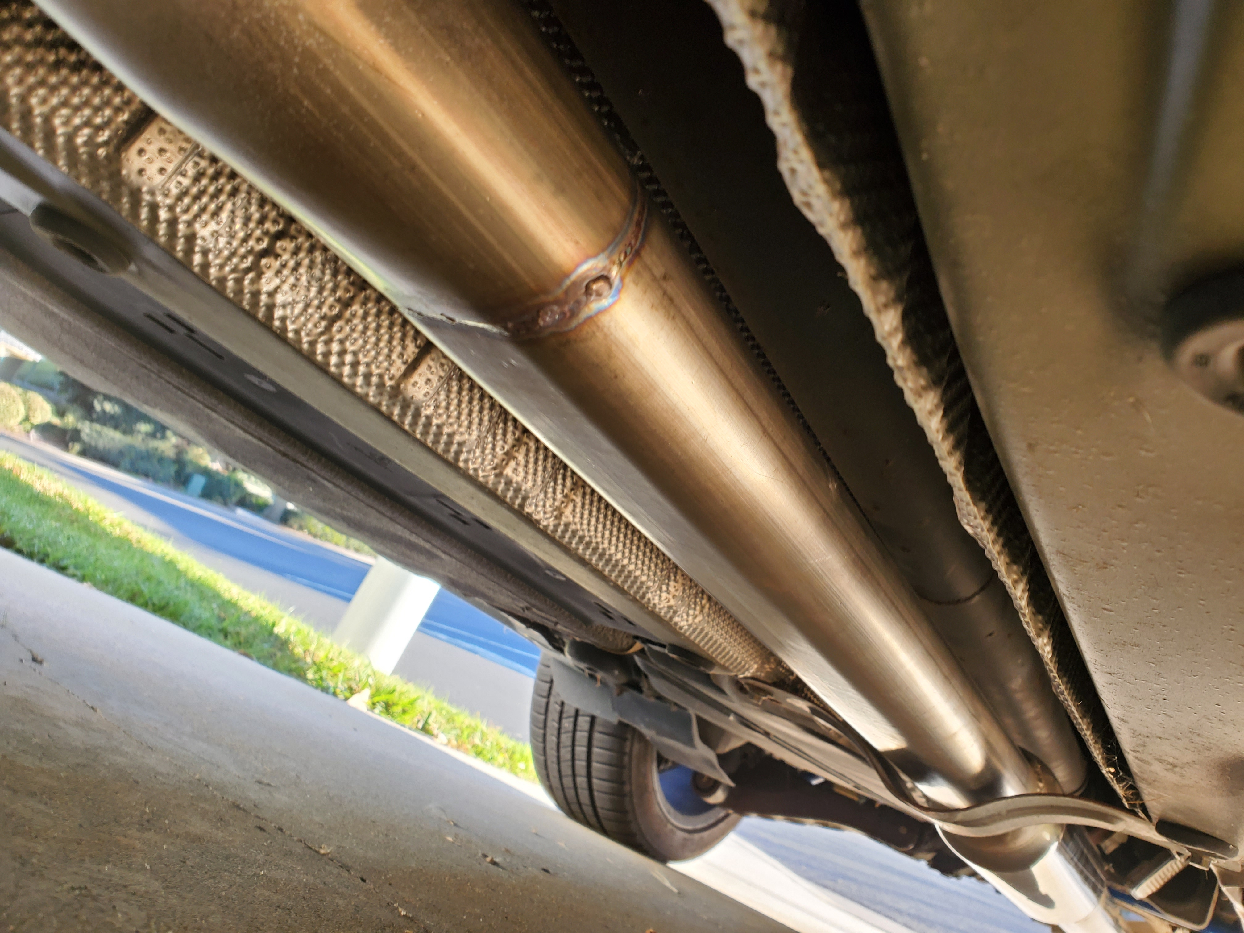

So my total out the door ended up just shy of $900, but I got exactly what I wanted (my choice of resonator, ~3.125" oval tube with the Borla XR-1), using some of the parts listed above. Listening to videos, I just didn't like the IPD sound, and some noted a drone with it. That Borla just sounds...nice. Tucks up underneath pretty well, glad I didn't push it too far with the resonator, though that larger one might, maybe fit. Maybe. I also didn't want to trim my bumper, so this way I didn't have to.
Some pics attached. One or two things I would change about the way the shop assembled it, but overall I'm happy with it.
