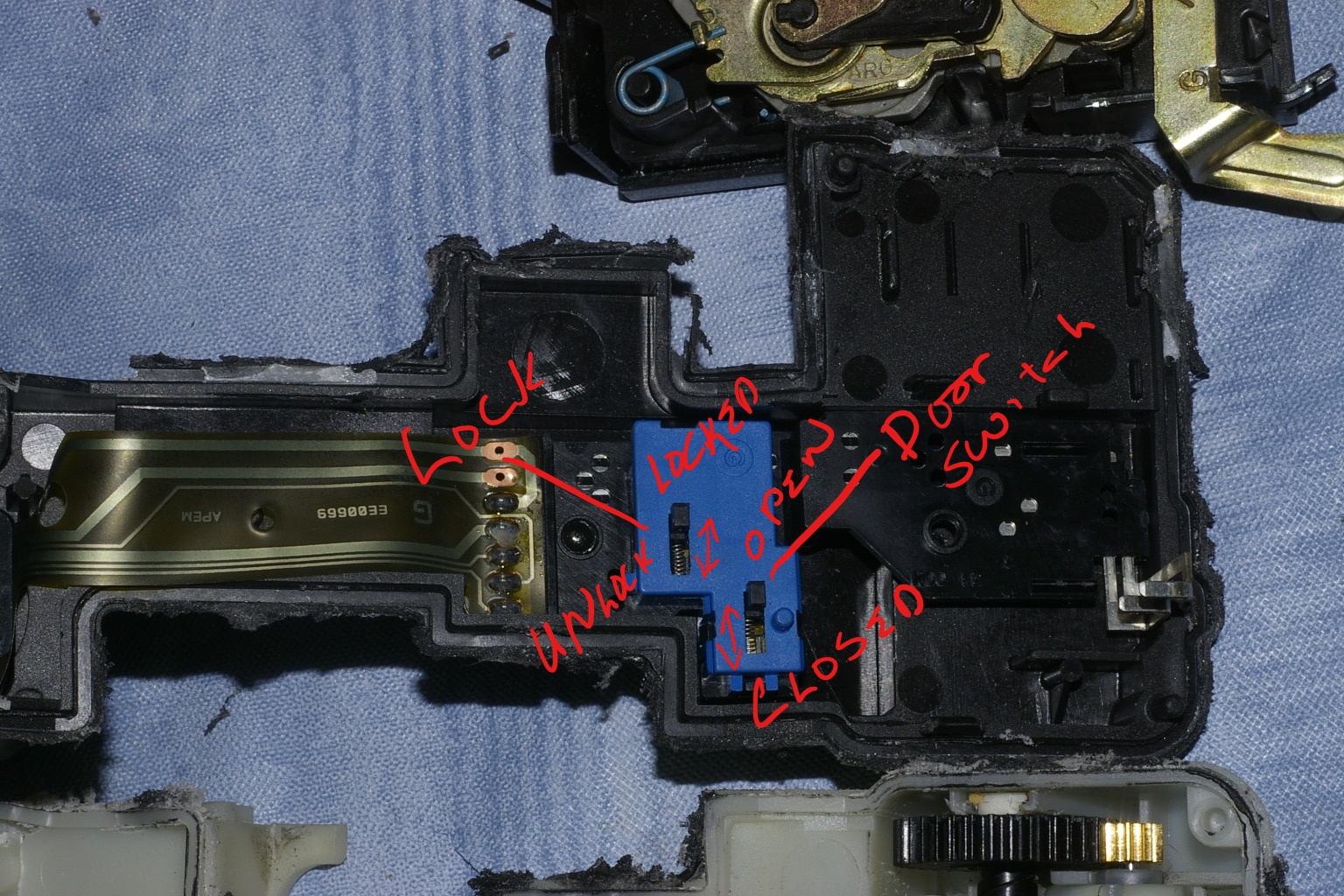

I do not think there is a switch actuator. I believe the door closed signal is built into the latch.

Most likely the door lock assembly, there are two switches in the door lock assemblies, unlock/locked, door open/closed and these switches do have problems. Sounds like you may have two bad door lock assemblies too. It's also possible a wire or connector problem. The alarm is probably getting triggered because of the door open/closed switch or lock/unlock switch intermittently becoming open. I have a 2001 V70 and have replaced 3 of 4 door lock assemblies over the years, I pull the parts from a local salvage yard and you can also purchase new. Gas gauge is not likely related to door lock assembly problems.darksteelsliver wrote: 02 Aug 2016, 20:40 Hello, I recently purchased a used Volvo V70 T5 station wagon and have started to have some issues with the car thinking the doors are open - even when I've made certain that everything is secure. In particular, the display often reads, "Right rear door open" and "Driver's door open". This causes my interior lights to stay on. How do I fix this?
