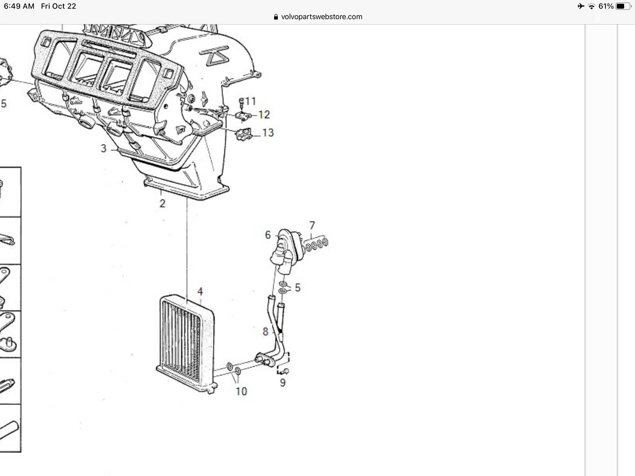

There is a little bit of confusion in Volvo webstore. These-rings are used in three places on the heater core
1 one on each pipe, in compression between core and pipes
B. INTERNAL O-ring sealing pipe to plastic junction inside car…one or two per pipe?
iii. At the firewall connection, where I believe the fitment is, from front of car ( amd so loading order)
Fat spacer, oring, thin spacer, oring
The diagrams in Volvo webstore, for air distribution box, conflict a bit.
P80 air distributor heater core o-rings 3545586 confusion

Also , number 9 , a t25? Torx screw is loaded from the rear, not front of car as depicted

The torx screw number 9 indeed loads from the rear of the car.abscate wrote: 22 Oct 2021, 04:57 Also , number 9 , a t25? Torx screw is loaded from the rear, not front of car as depicted
The o-rings and spacers, it's been too long since I took one apart. Hopefully it stays that way. But if you search it is definitely in the fora.
EDIT: I had it wrong, fixed the text to match reality.

Hmmm. My 1999 the Torx head is rearward and the 1999 I just did was the same
The threads are in the black plastic manifold , Professor?

Yes, I refer to the solo screw down at the bottom of the heater core. And you are right - I will edit above to avoid confusing others!
