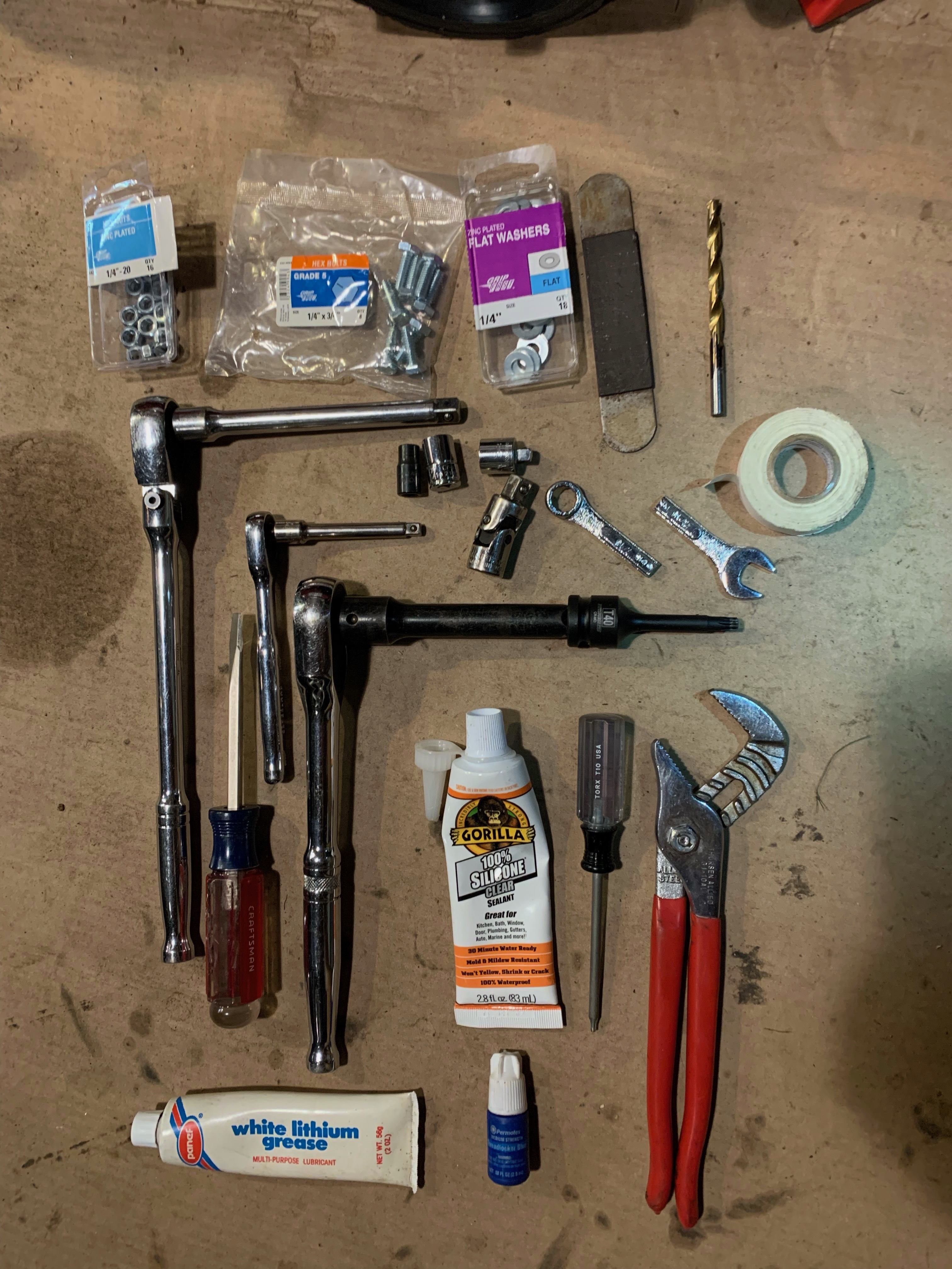

Here are all the tools and hardware I used:
Notice the cheap 7/16 box wrench has been cut in half with an angle grinder. You can also break them in a vise. If you don't have a spare box wrench to ruin I suggest a local pawn shop, they usually have a huge box of junk wrenches.

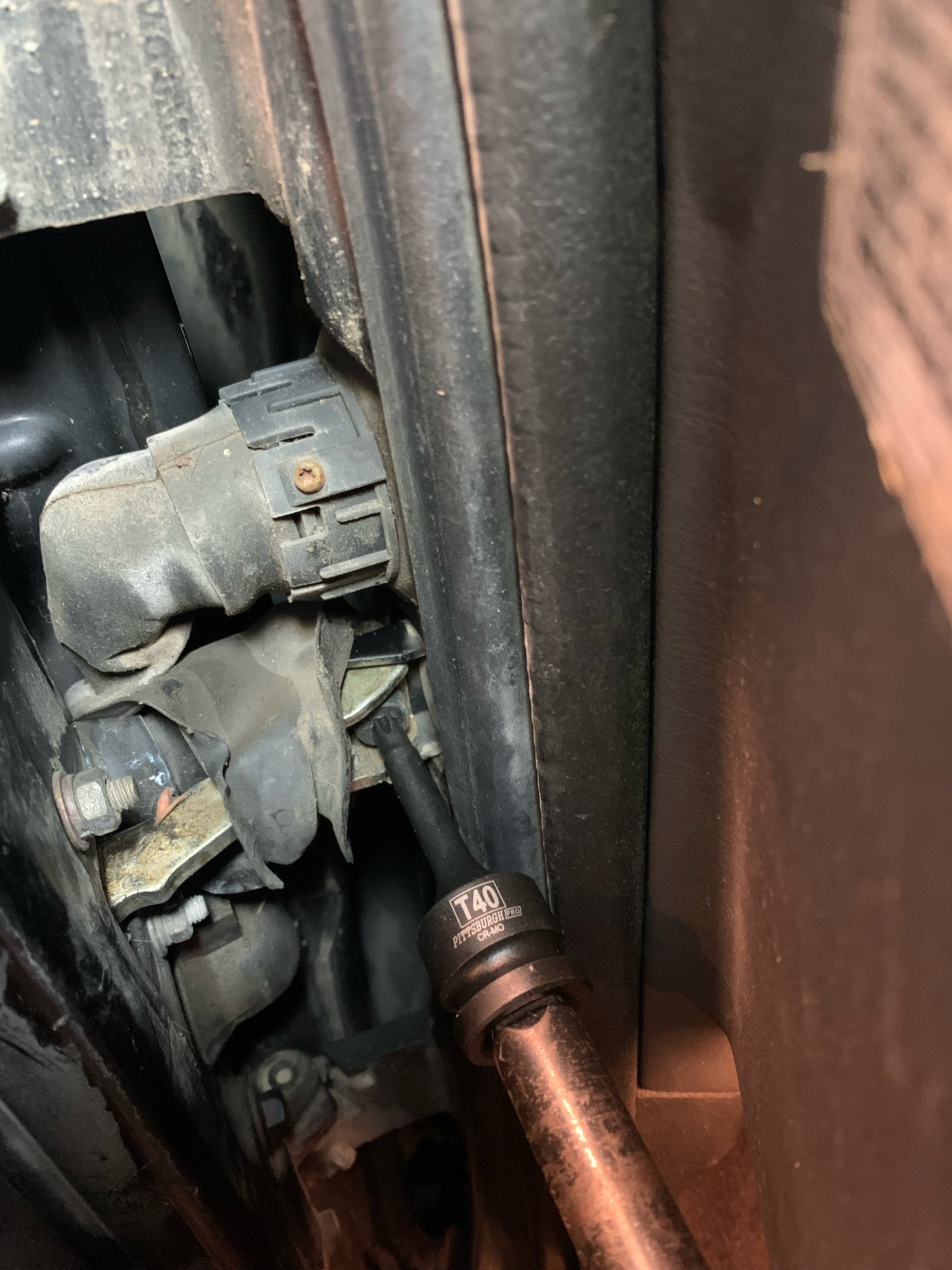

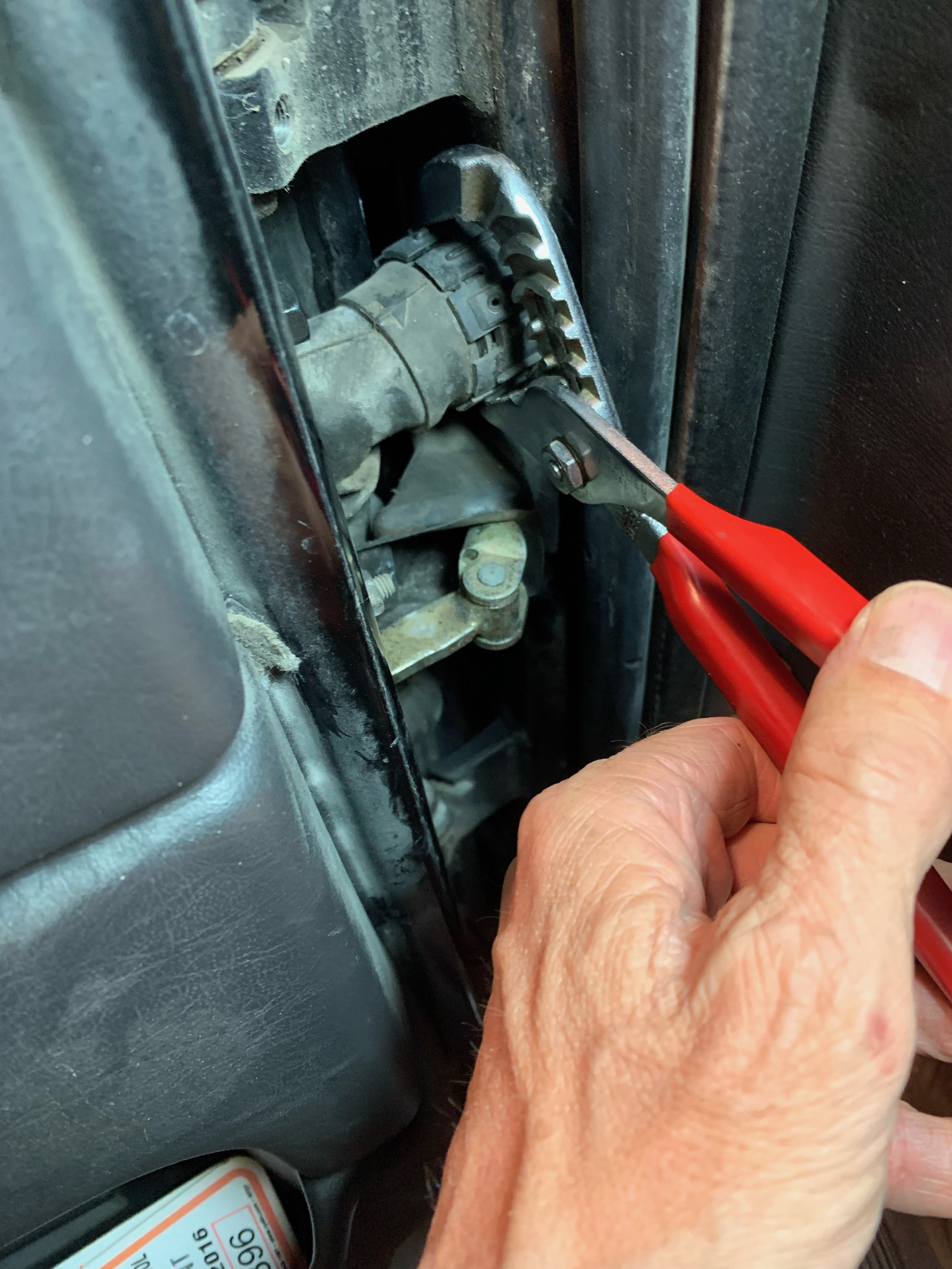

2. Next unscrew the T40 torx screw that holds the door check strap to the frame.

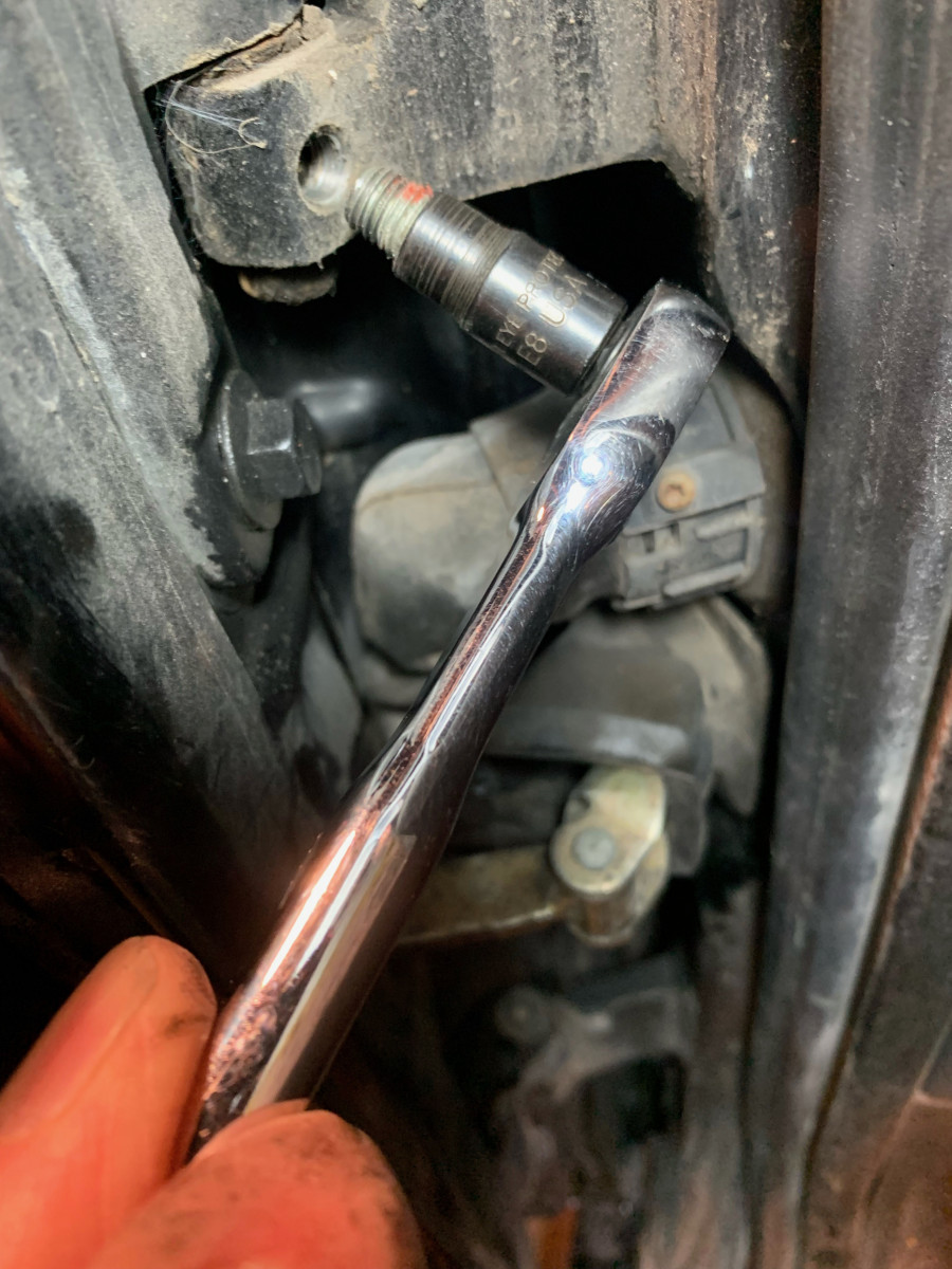

3. Remove the two door pins, one on each hinge. They are E8 torx but apparently you can use a 1/4 socket too.

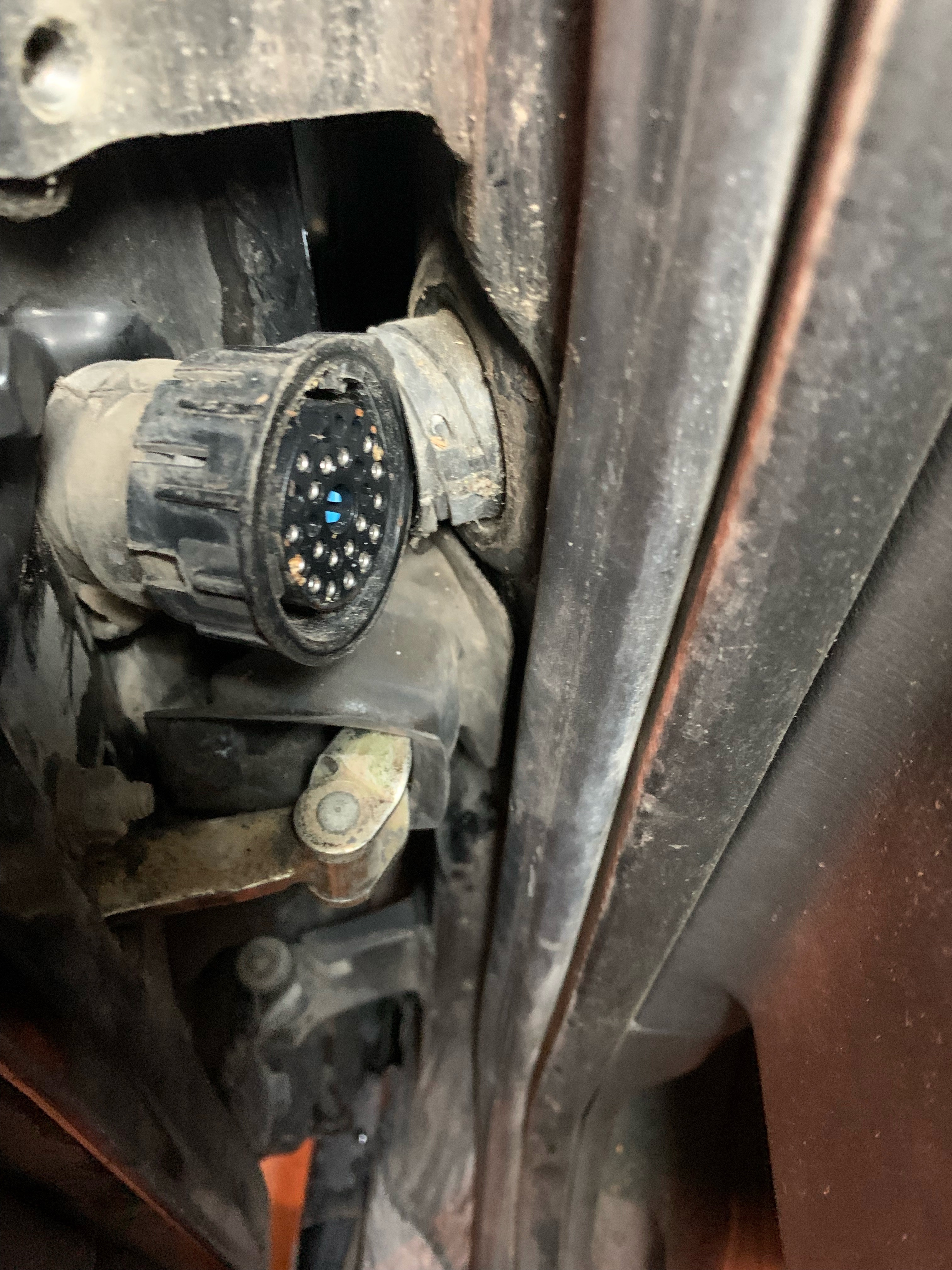

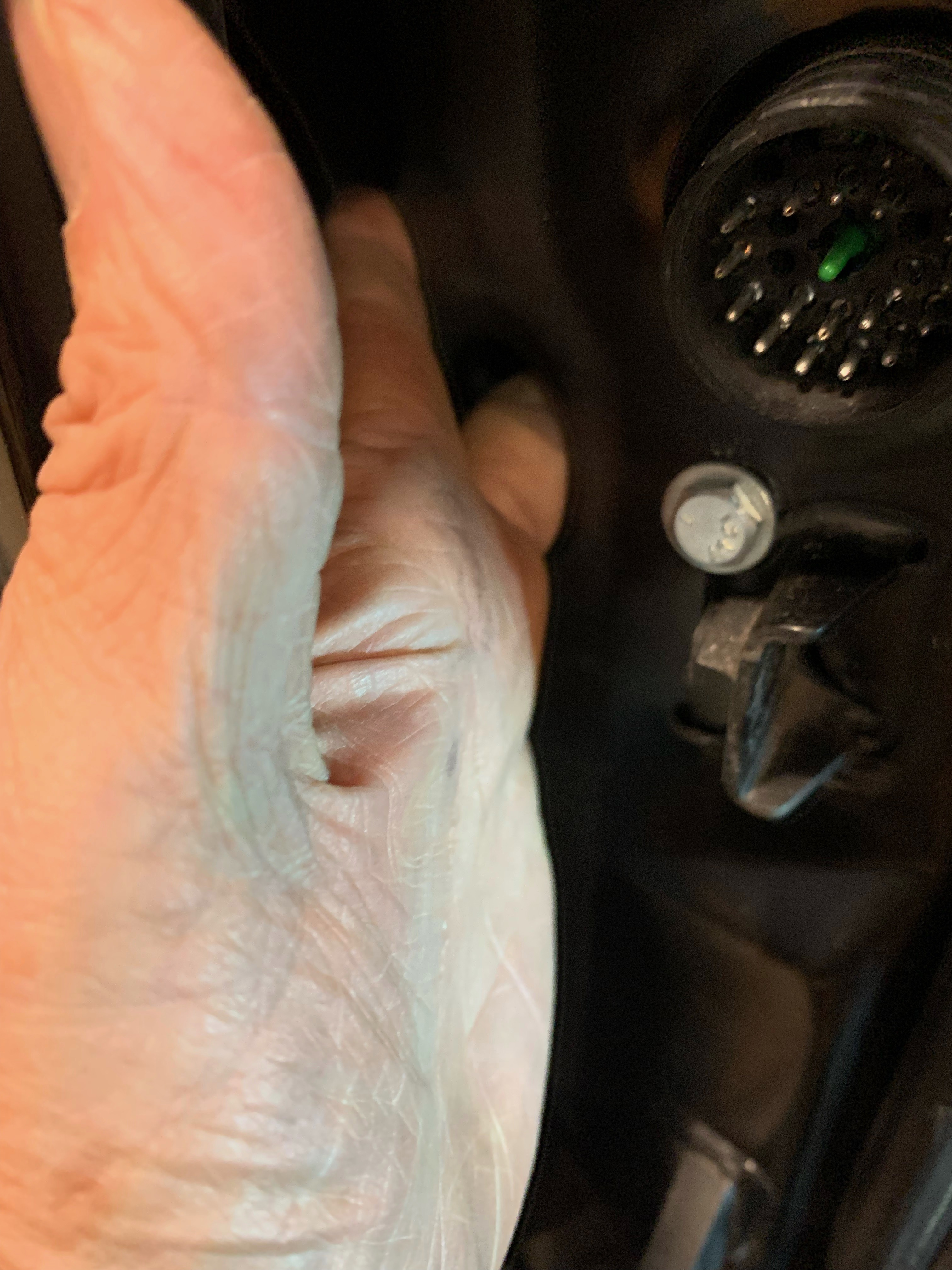

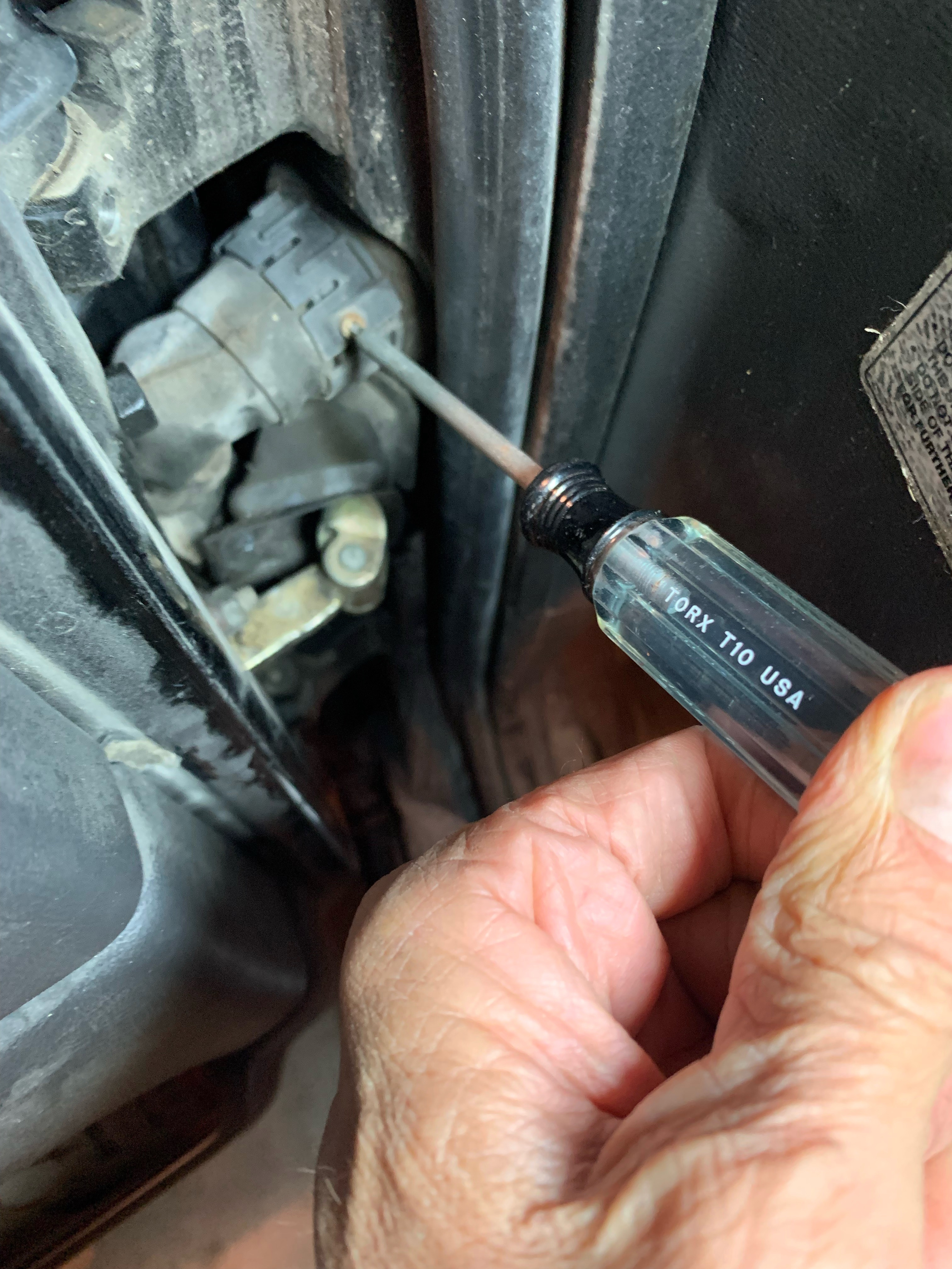

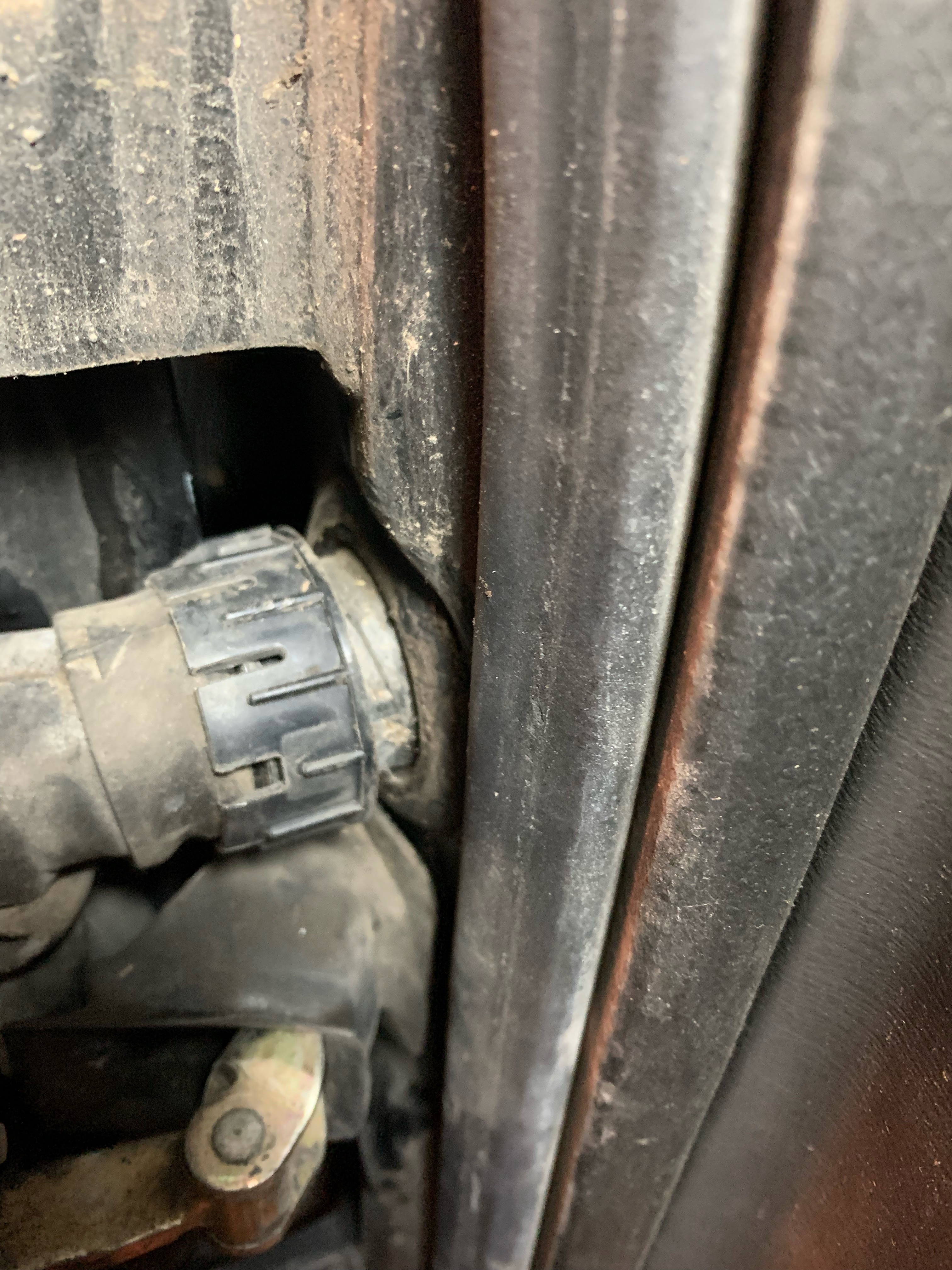

4. Unscrew the T10 on the electrical connector, carefully rotate the connector sleeve counterclockwise about 30 degrees (don't squish it!) until the screw hole moves past the the triangle on the cable sheath (see pic), then gently pull out the connector.

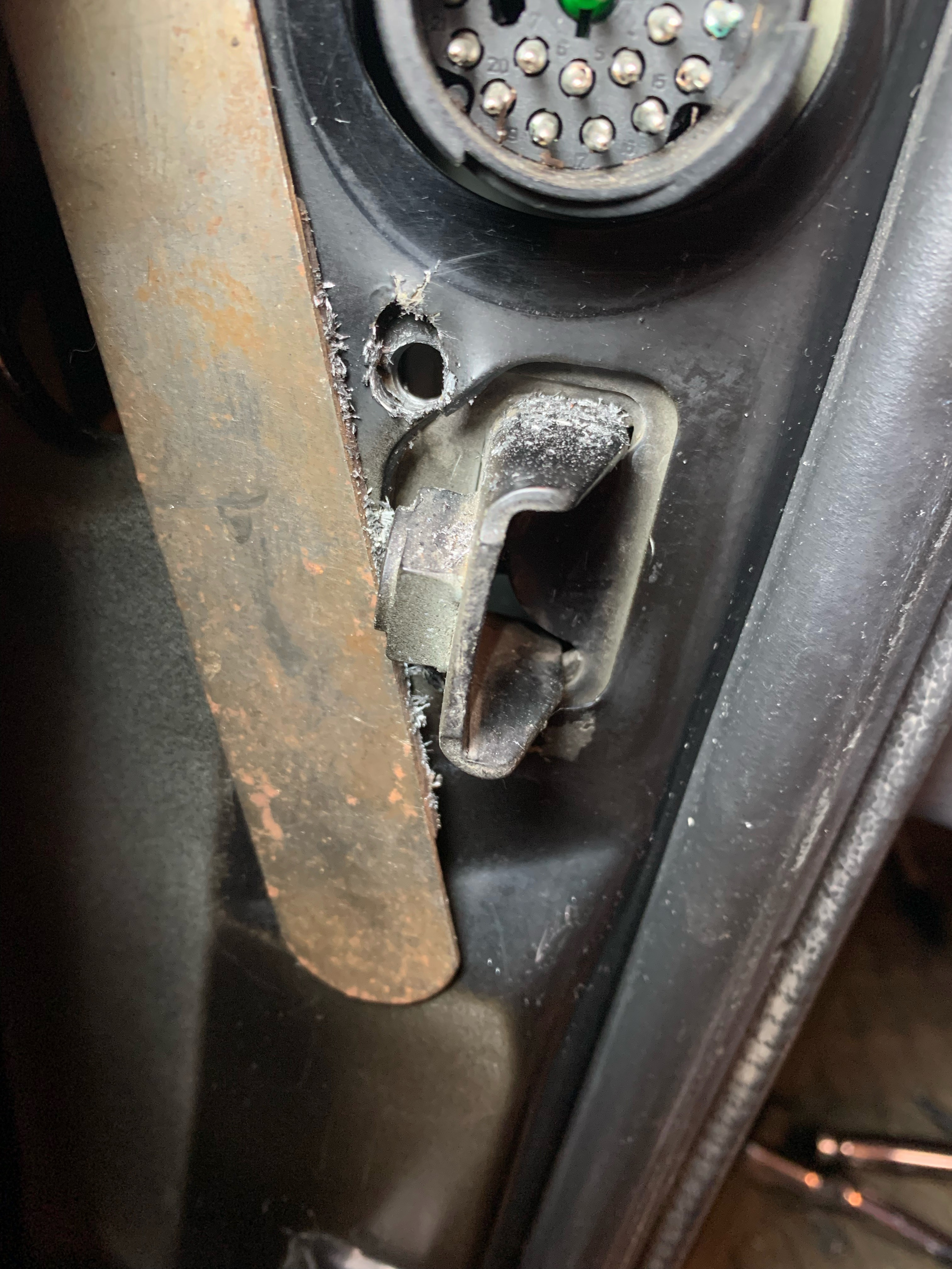

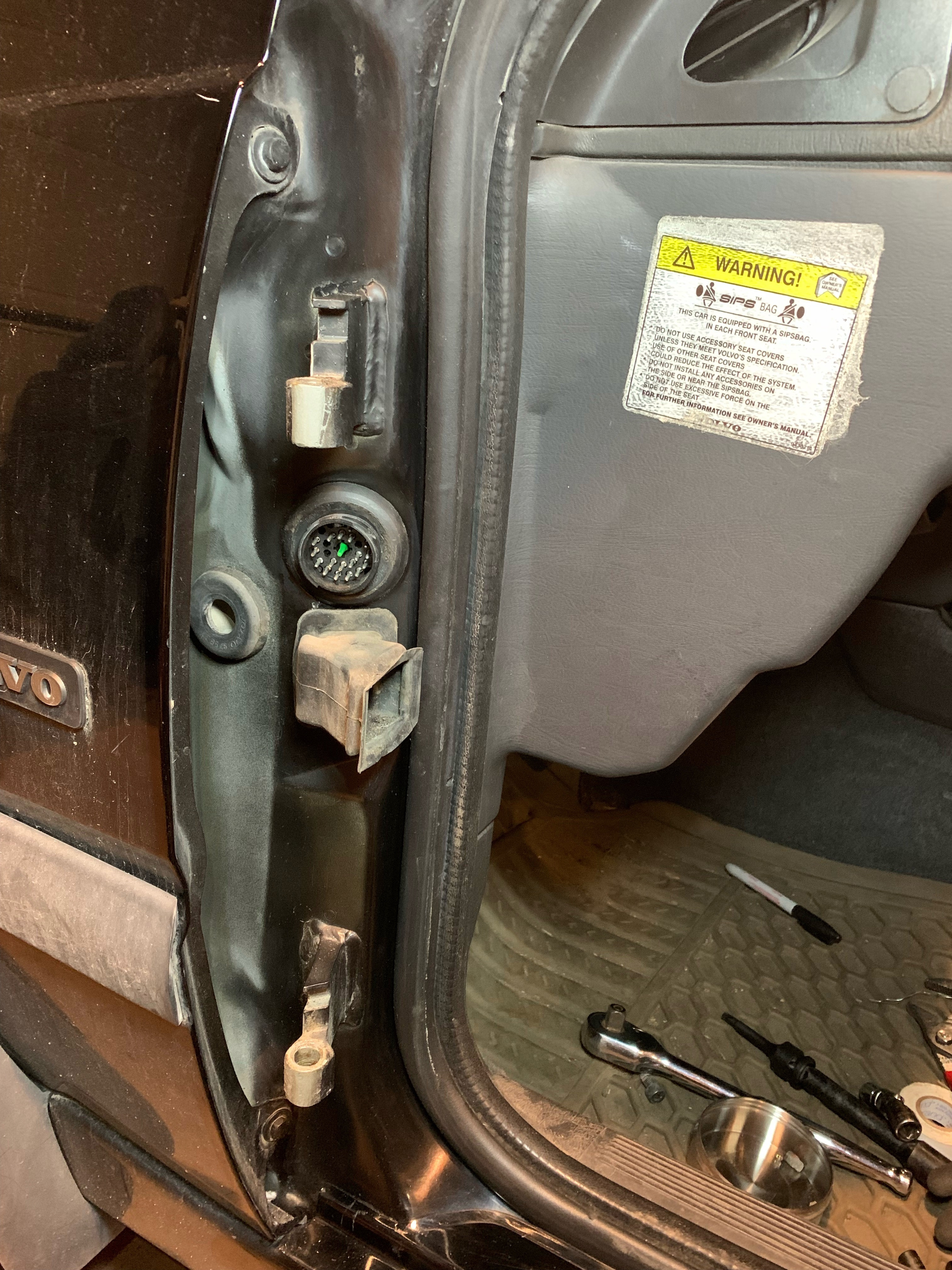

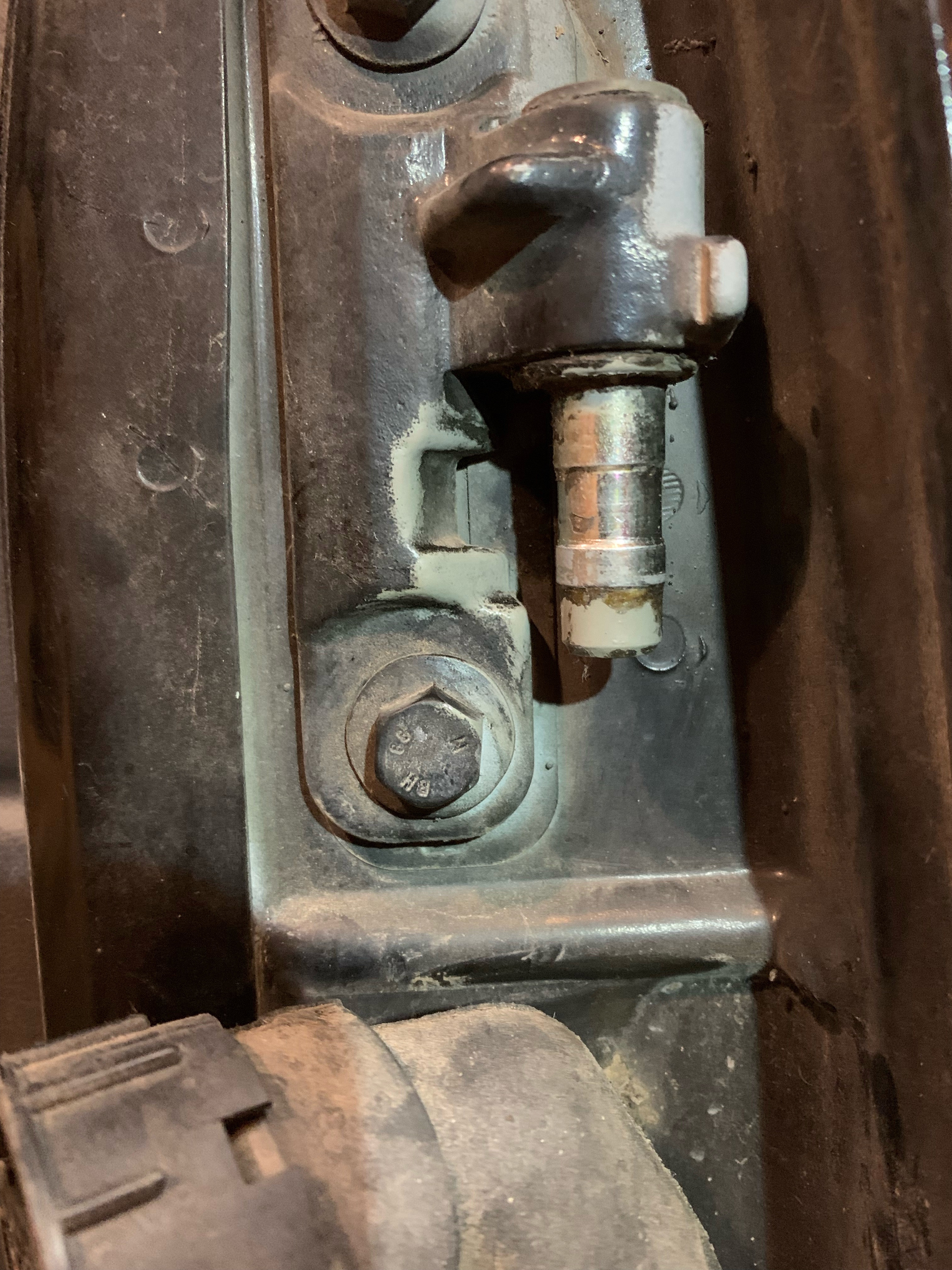

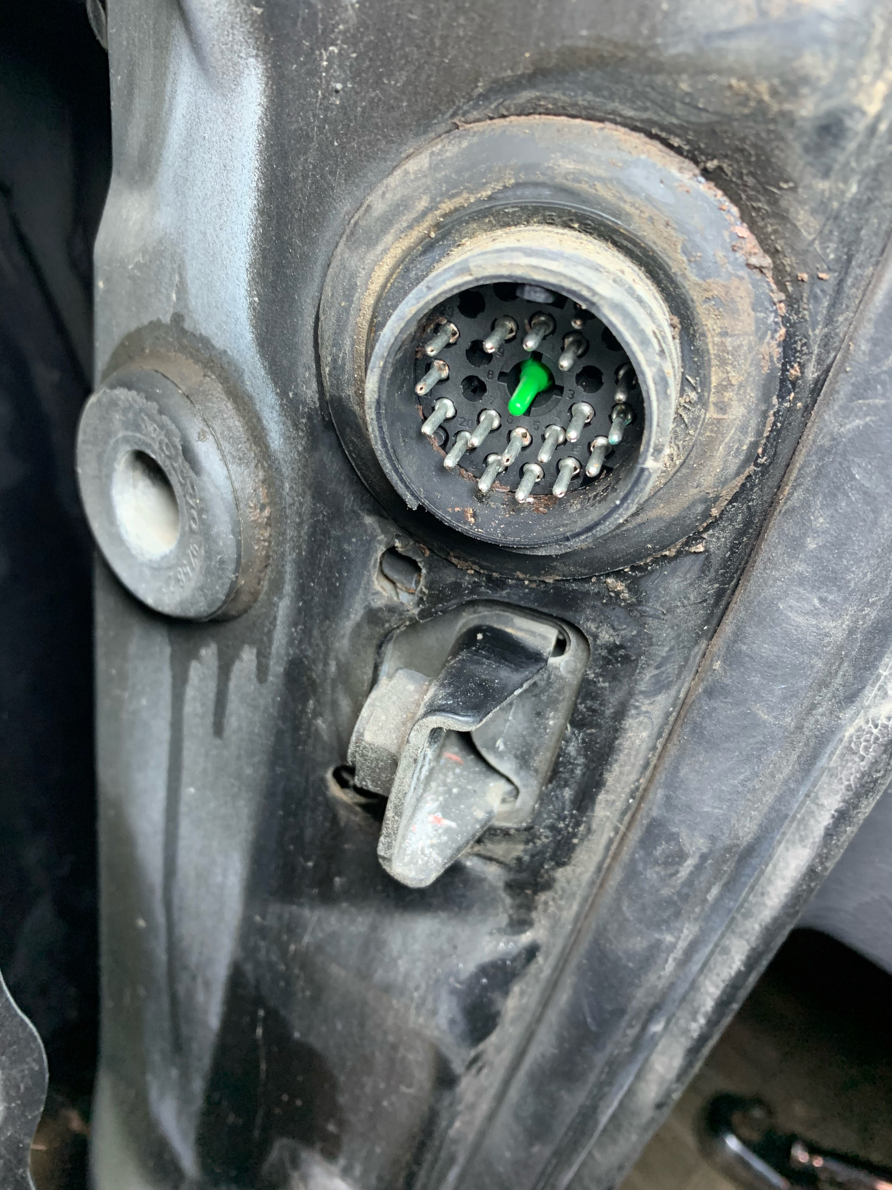

Here's a shot of the door pillar showing, clockwise from left: the grommet that allows finger access behind the broken welds, the male connecter end and the door strap anchor. You can see the broken spot welds to the left of the anchor, the top one is clearly visible the bottom one partly.
6. Clean up and check out the work area. Another pic after cleaning it up and removing the rubber grommet and plug. You can see cracks around the two broken spot welds. That's where you drill and install fasteners. Reach your finger into the hole and feel around the work area from the back so you know what kind of edges are back there on the plate near the broken welds.

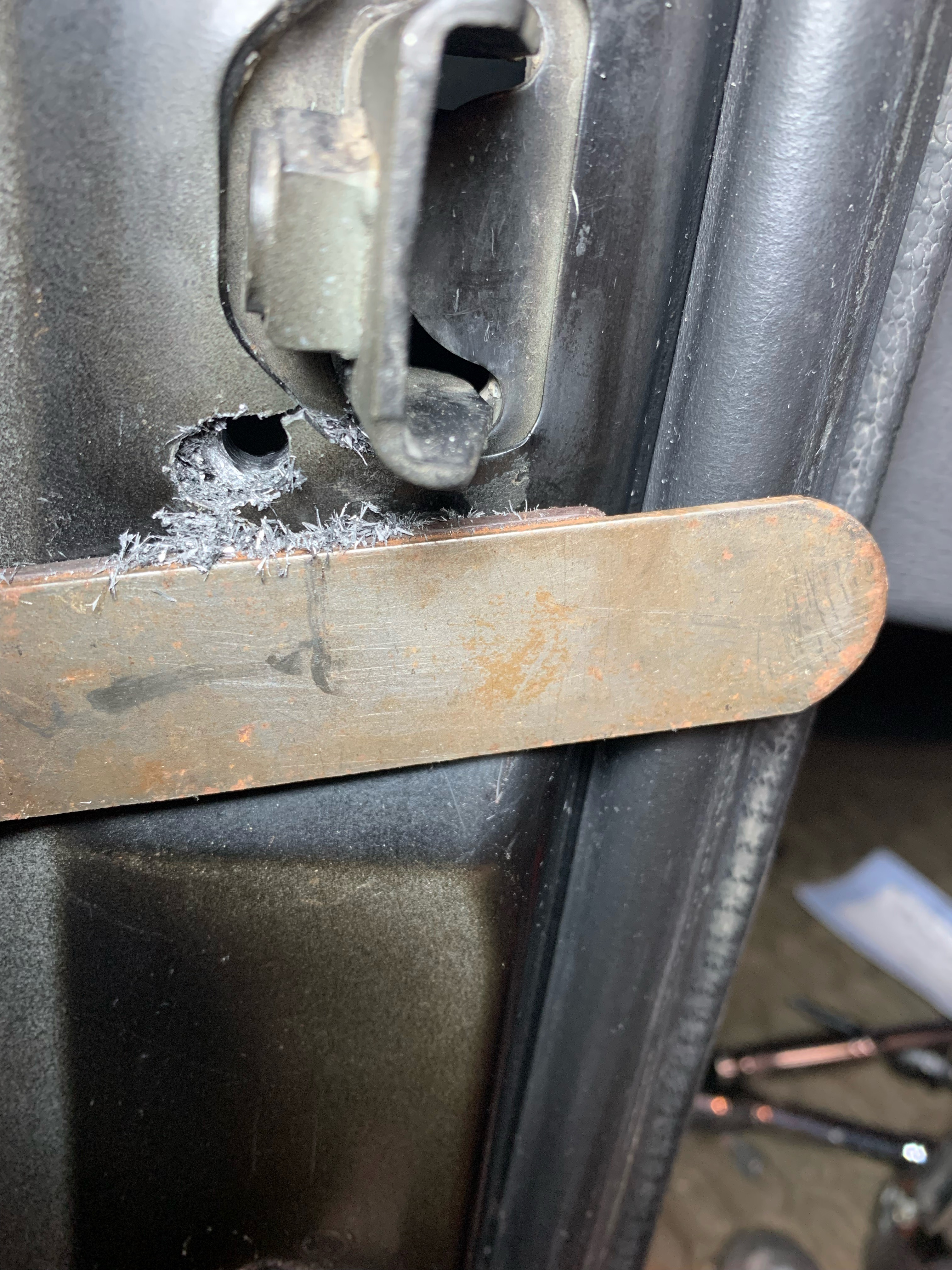

7. Drill holes. I used a 1/4 drill bit for the 1/4 bolts I had on hand. Check the hole size by drilling a hole in a piece of wood and make sure the bolt slides in easily. Drill the holes slightly offset from the corners of the broken welds, so that bent plate edges in the back don't get in the way. For the same reason I also angled the drill tip slight above horizontal for the bottom hole and slightly below horizontal for the top hole. The rusty strap in the pic is a magnet to contain the swarf. Vacuum it up between and after drill jobs, to keep the chips out of your skin.

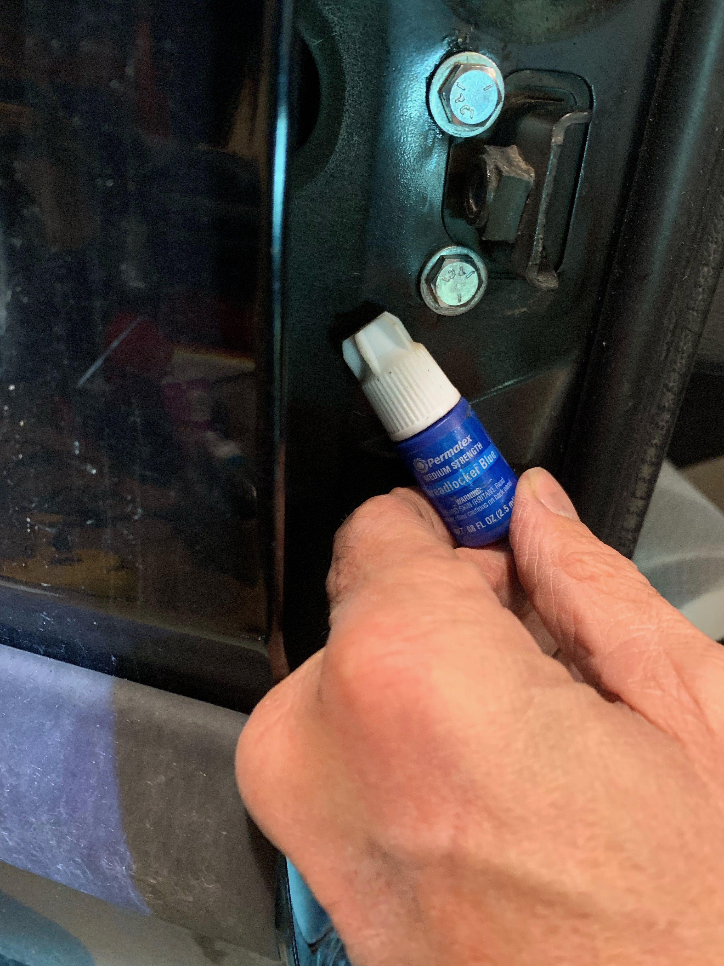

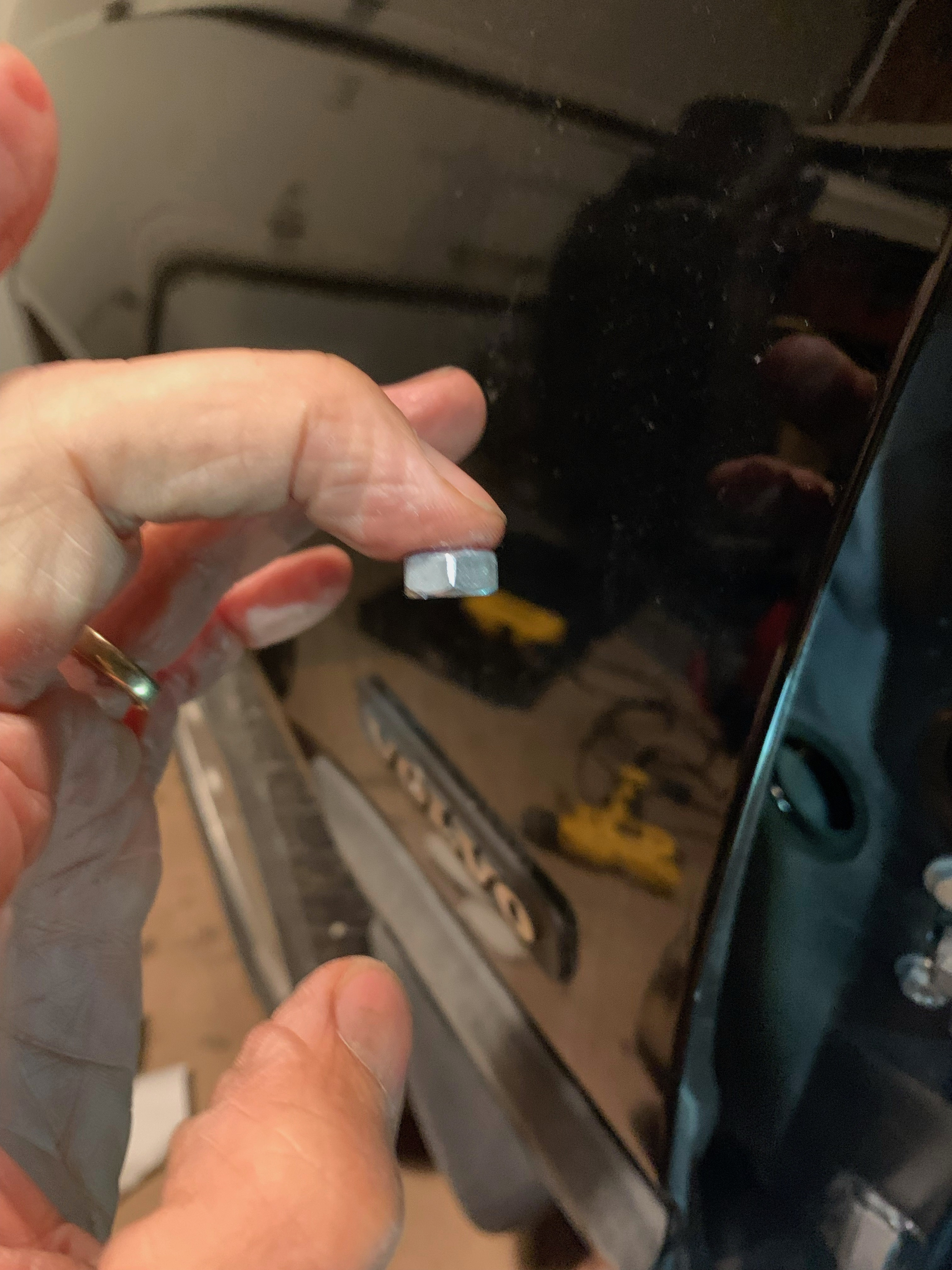

9. Install the nuts and bolts. Put a washer on the bolt, I did the top one first, put some blue Loctite on the bolt threads near the tip, then put the bolt in the hole.

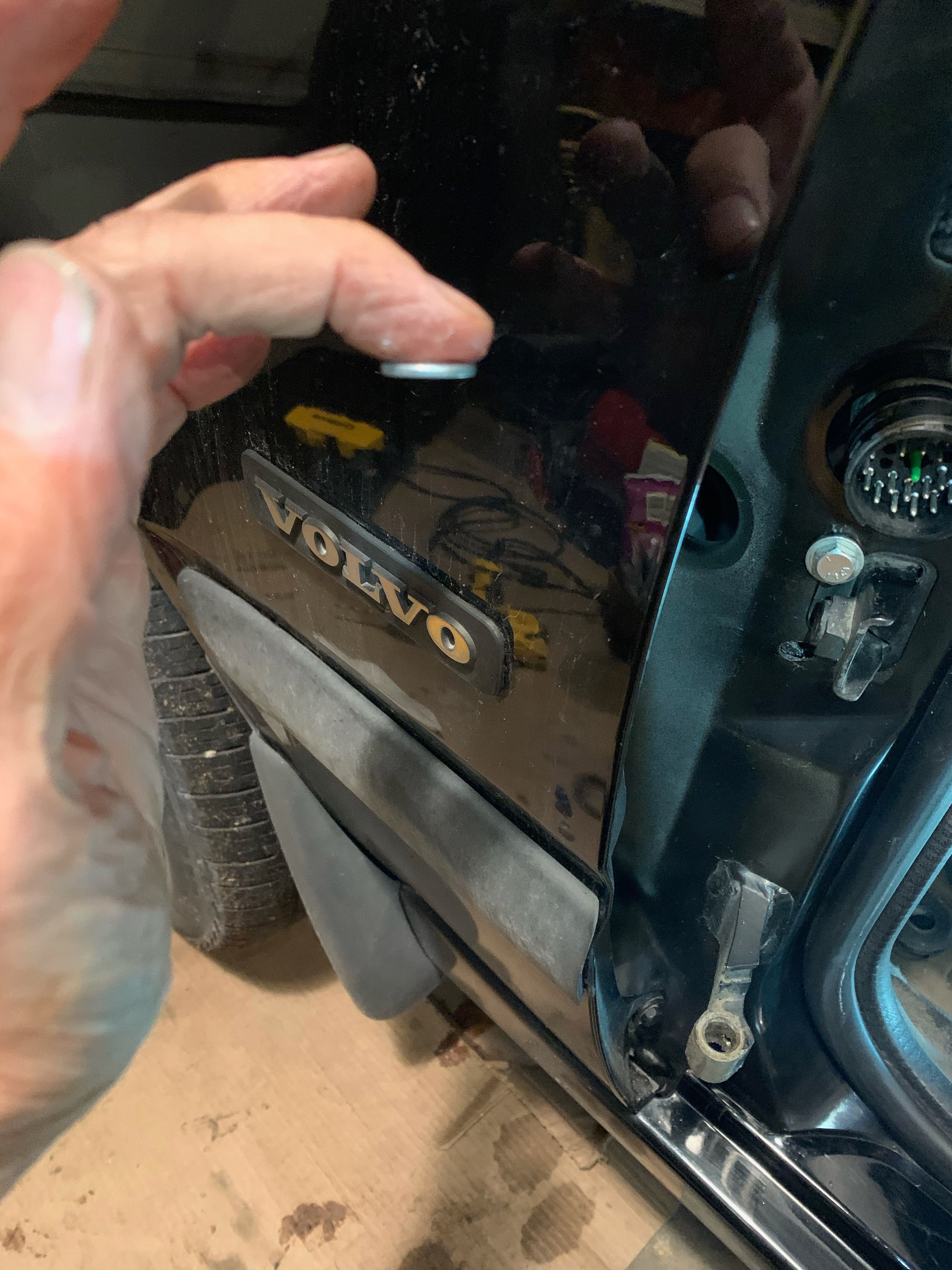

With just a smidge of silicone stick the washer to your fingertip so you can reach back inside the pillar and get it on the bolt end. Then do the same with the nut and screw the bolt into it, finger (haha!) tight. I was able to get the top bolt fastened without dropping anything but lost two washers into the fender when working on the bottom.

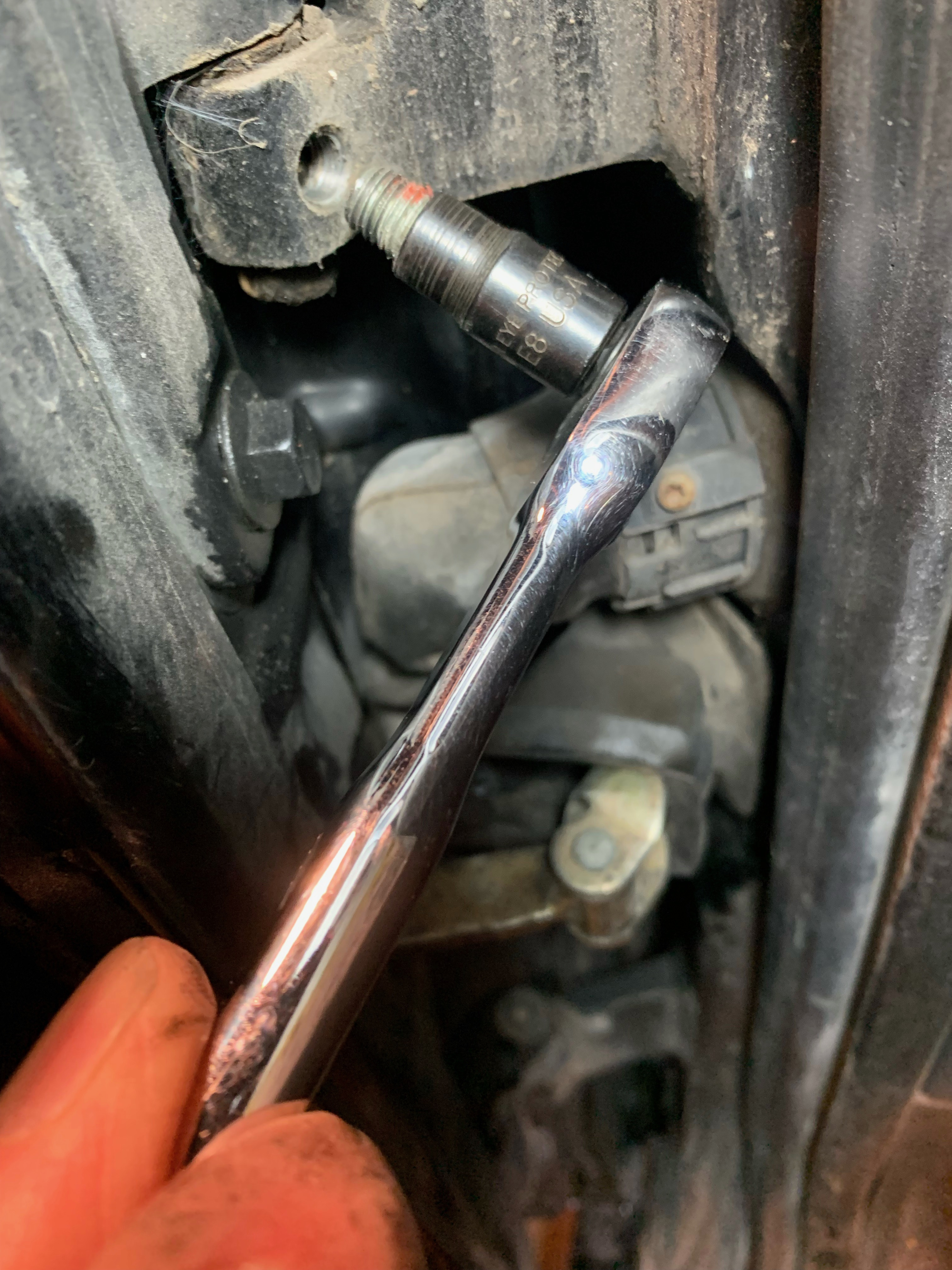

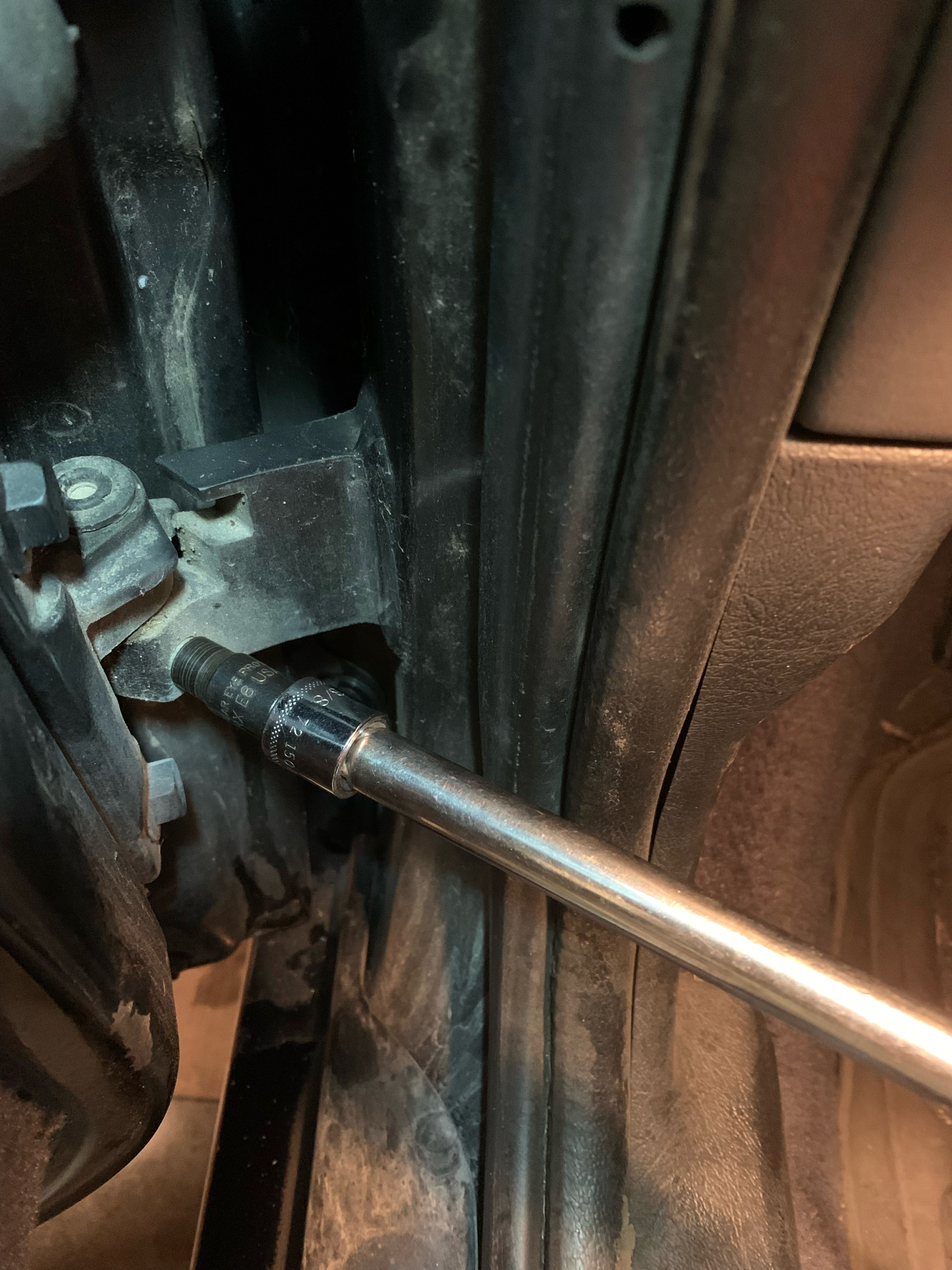

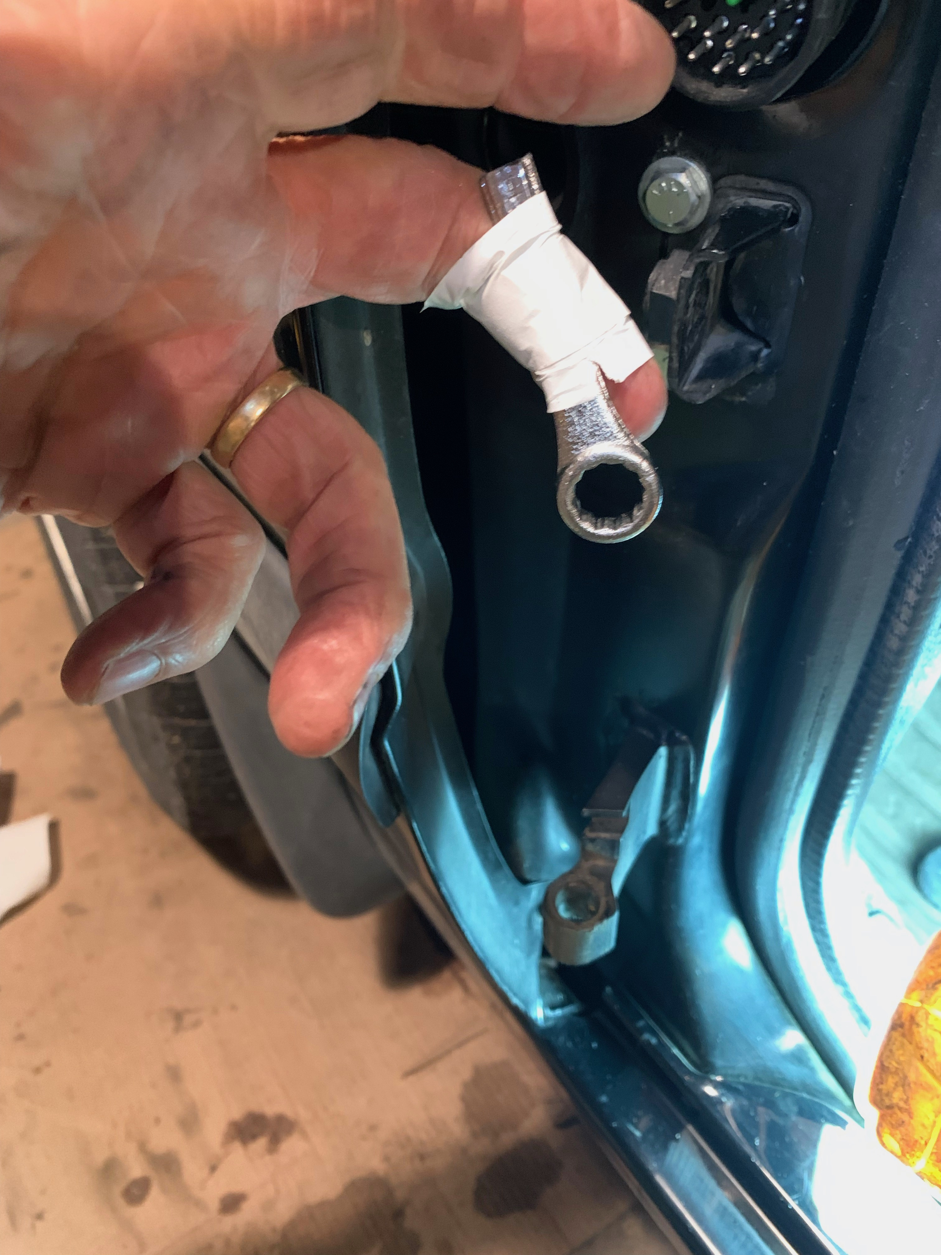

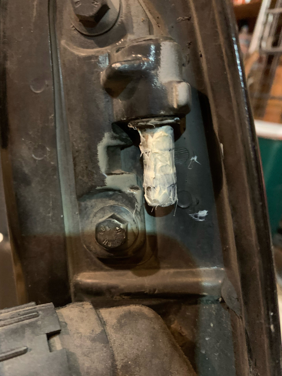

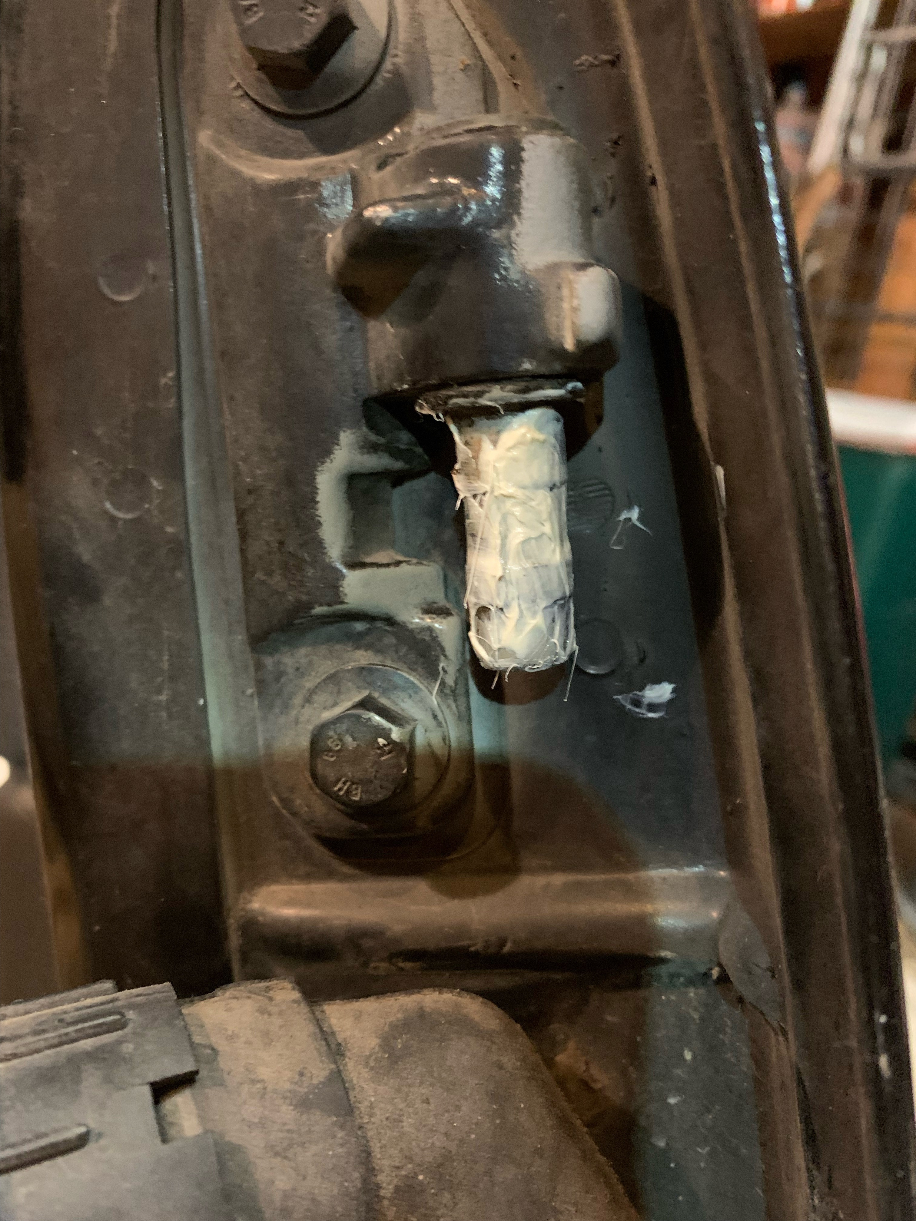

Now before the Loctite dries, set up the cut off wrench to reach the nuts in the back. You need to tape it to your finger so you can reach it into the hole and curl it up to hold the nut. Others also use a piece of string on the wrench here too as a leash, but I didn't. Not a bad idea however. Here's the angles I ended up using for grabbing the upper nut (I could have cut the box end a little shorter):
and for the lower nut:
Tighten up each fastener with a socket on the bolt head while holing the nut. Get it tight but don't get hurt! OK, all tightened up! Let the Loctite dry.

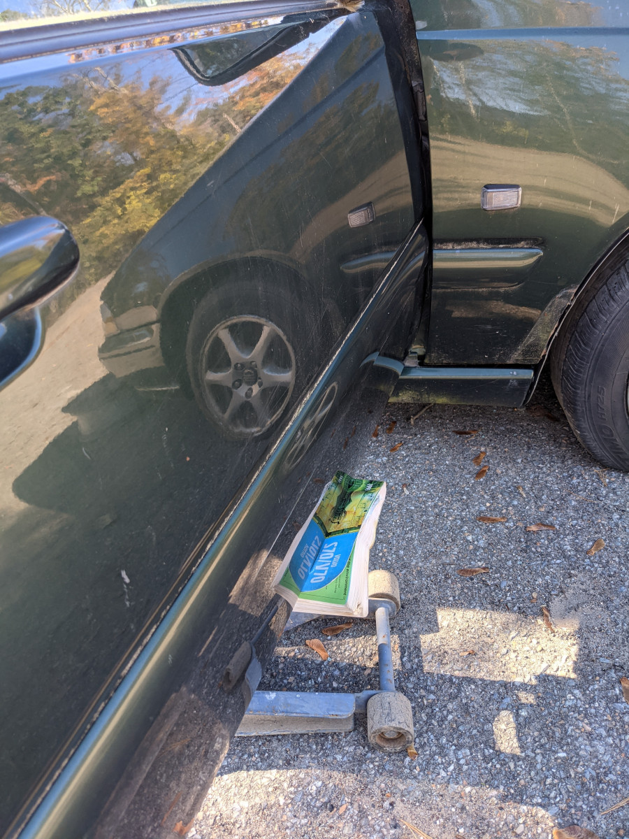

A tip for removing the door which I just used on a junkyard run:
To get the door off the hinges after removing all hardware, put a jack under the door to apply GENTLE pressure. Place the head of the jack about 6" away from the hinge so most of the force goes to the hinge pins, not farther out which might torque the door. Place something soft between the jack head and the door, such as a soggy owner's manual from the floor of the junked car. Apply gentle pressure on the jack, then use a crow bar at the squared off parts of the hinge to gently pry up. After it moves a bit, raise the jack a small amount more and pry again. Hold the door carefully while doing this. Repeat until the door is off.
