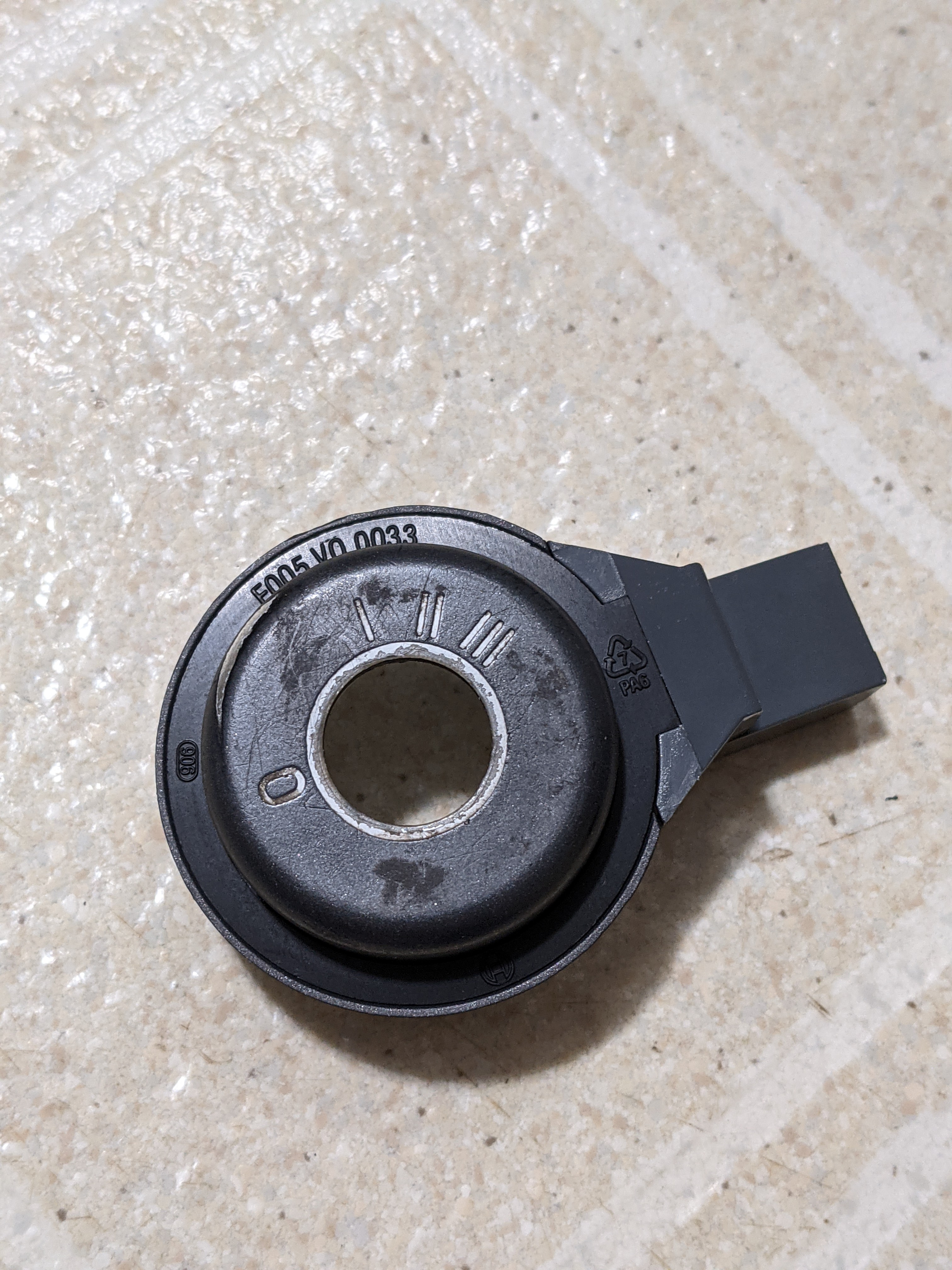

I just pulled an immobilizer ring from a 1999 V70. I'll be driving through your area on Sunday afternoon or Monday. I could come by and test this ring in your car, selling it to you if that fixes the problem. Feel free to PM me your address and I'll see how it works into my plans.
I just tested the ring on my 2000 and it works fine. Trying to start with that ring disconnected just cranked the engine with no start. I'm guessing it turned off the fuel pump. I started with the ring, stopped, disconnected the ring, then tried to start. The engine almost started as if there was still some gas in it, but it stumbled back into cranking.
Interesting, this taught me that the immobilizer was another "no start" condition.

There is a coded chip in the 99- North American Volvos. The antenna ring 'read's' the chip and if it sees what it has programmed into the immobiliser the car will start. The 2 issues I have found with the 99-00 P80 chassis cars are:
1) The connector to the ring can get oxidised/dirty over time, and sometimes just removing the connector and re-fitting it is enough to make it work again.
2) The unit cracks with age and it will stop working.
It is unusual for a key chip to fail in these keys. In the 2001 on P2's there is a chip internally that can fail but I will stop there.
If Firefox can help, it is worth trying to see if the used replacement works.
Before then, try locking the driver's door with the key and un-locking it a couple of times. Sometimes the system can get confused and shut you out. This will reset the system. If this doesn't work the the antenna ring issues need to be investigated.

The issue is resolved…..at least for now. Our car is a Denso NA so Abscate’s data jibed perfectly with our experience. Two starts with IMMEDIATE stalls. Less than 1 sec, which as Ozark Lee pointed out in a post I saw somewhere is significant. Then the crank no start the next morning. So this morning I pulled the antenna ring, dripped some electronic cleaner in the plug and plugged and unplugged it numerous times and it’s working. Thanks you to Abscate, foggydogg, Scot850, and particularly Firefox31. I appreciate the offer of your precious time. Enjoy you visit to the area. And as always best of luck with all your projects.
