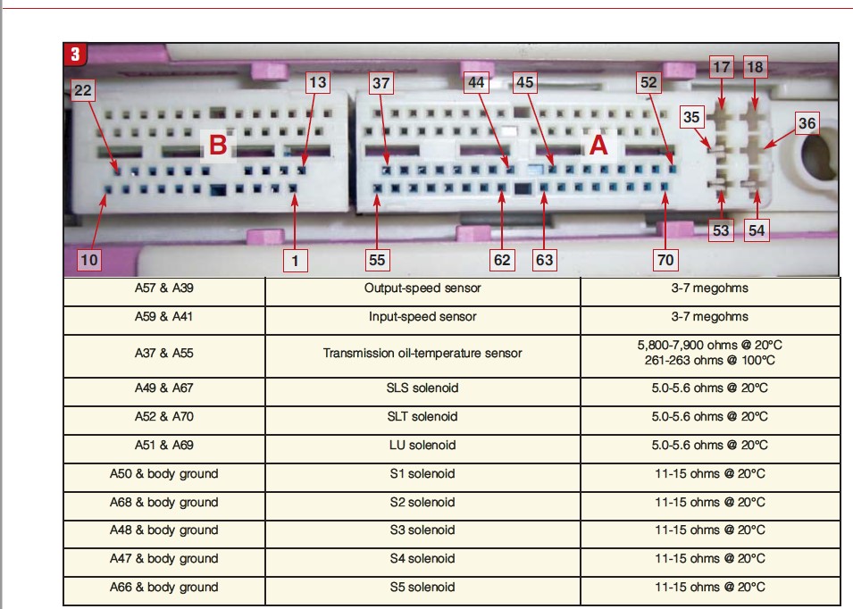

All I have is a photo of the TCM connector and I'm attaching it as it may be similar to the layout of the ECM pin connector. I can't tell from the photo if there's marking on the connector, there should be. Look for numbers at the ends of the connector rows and look for an A, B marking somewhere. Hope this helps some. If there's no visible numbers on the connector shown, look at the connector on the ECM for pin numbers at the end of the rows.
Not the connector for the ECM but the pin layout may help. Note the left end of the connector is not in the photo, there are a couple of more pins not in the photo and confuses the numbering sequence not seeing those pins.

Thank you FirstV70 at least it seems my confusion is not unfounded, I have tried a few forums with no reply, your help is appreciated. I will use the photo and try and familiarise myself with the pins,
I thought 'A " was one of the rows.
Thanks.

If the ECM connector follows the pattern of the TCM connector (photo) then you'll have two groups of pins A and B and you can see in the photo there's a dividing gap in the connectors between the A and B pin groups. The starting Pin1 location is different between the A and B pin groups and this may be the case with the ECM pin groups too but check for markings on the connector to be certain.

Thanks all, Looked under a magnifying glass and you can see the pin numbers and a and b connectors marked. (very vaguely)
