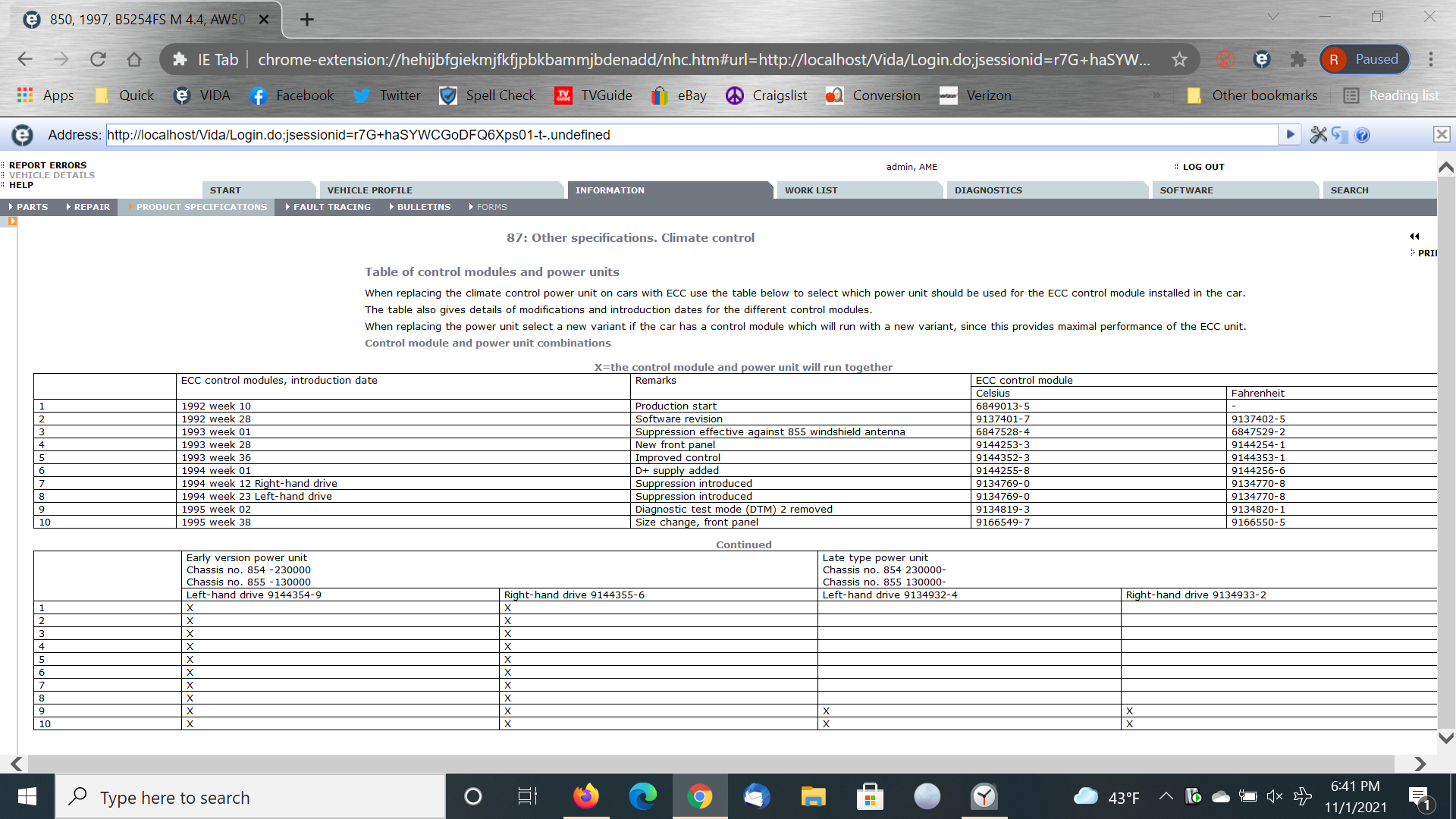

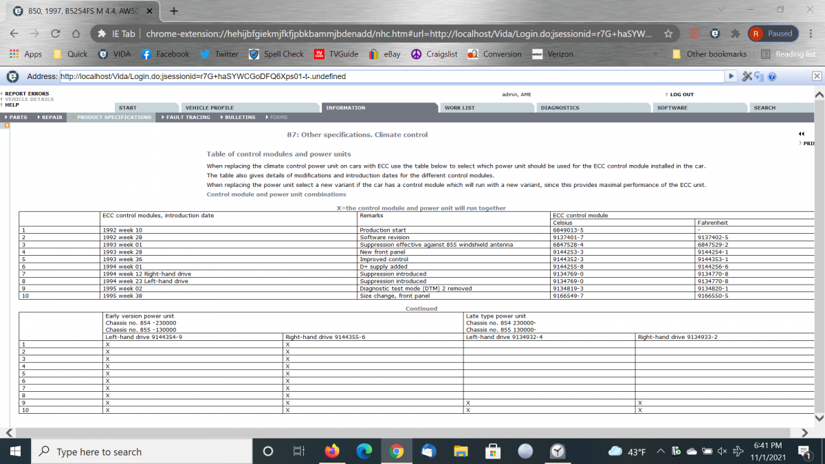

You can use a new one in a older model IF you change the wiring harness also. The new wiring harness is for the D+ supply.
In VIDA set vehicle selection to 1997 850. Then go to: Information/ Product Specifications / Other / Body and Interior / Climate units / Table of control modules and power units.
There you will find a table of what works with which model years, chassis numbers ... power units.

So my unit is a 9144256. Looking a little further below in the chart I see a 1995 unit 9166550 having a "size change." Hmm… that doesn’t bode well for a replacement. Yet, going through volvopartscounter.com shows the 9166550 when searching for my 9144256.
Is the -550 a direct replacement for the -256?

It is size change front panel. No indication of any change in size of the ECC. This need some more investigation.rsmigel wrote: 07 Nov 2021, 05:40 So my unit is a 9144256. Looking a little further below in the chart I see a 1995 unit 9166550 having a "size change." Hmm… that doesn’t bode well for a replacement.
Your ECC is a unit group #6. Which means you have the D+ supply modification. That rules out unit groups 1 - 5.
