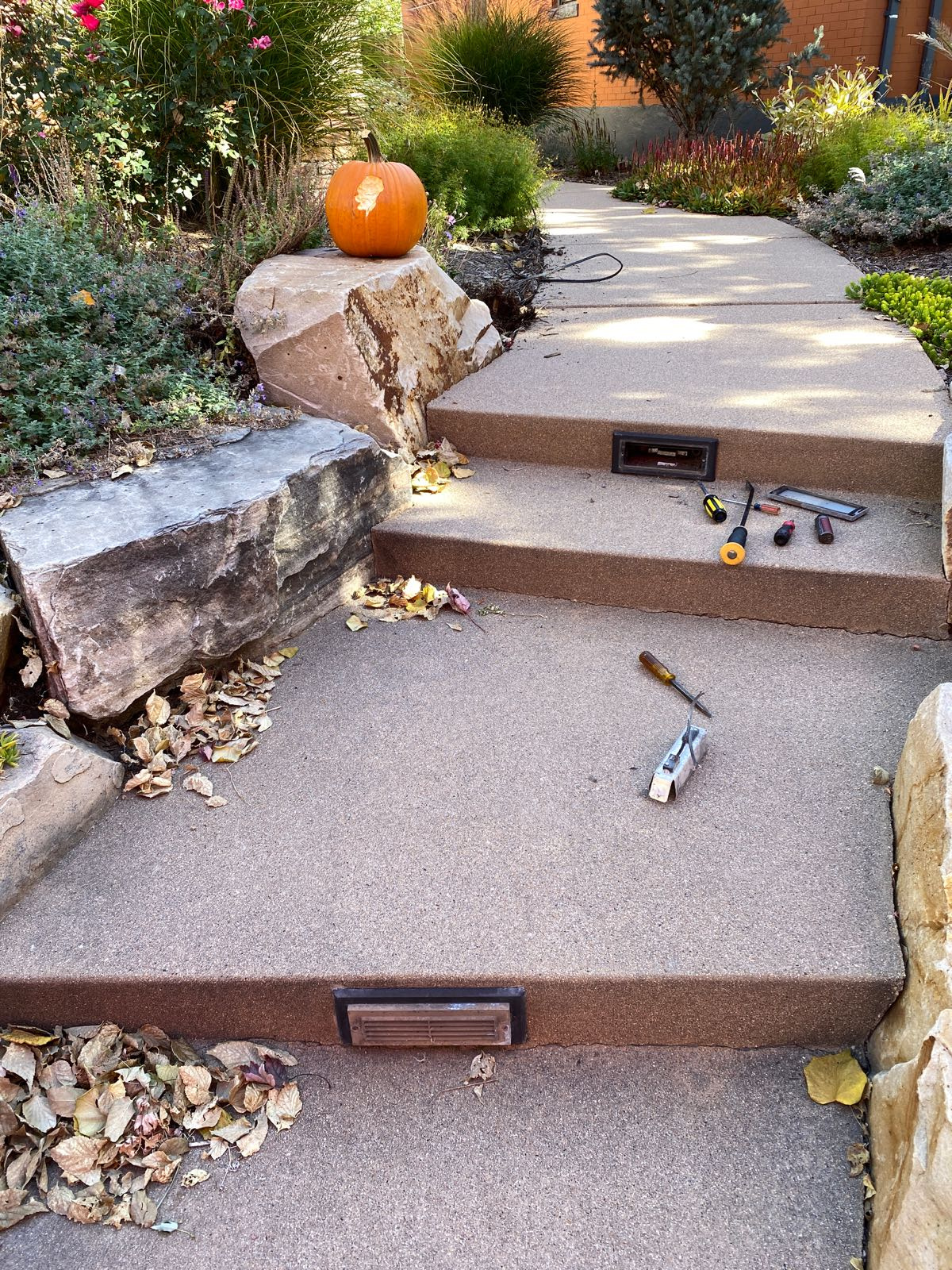

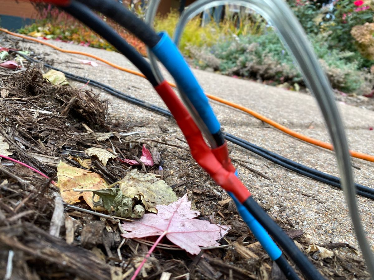

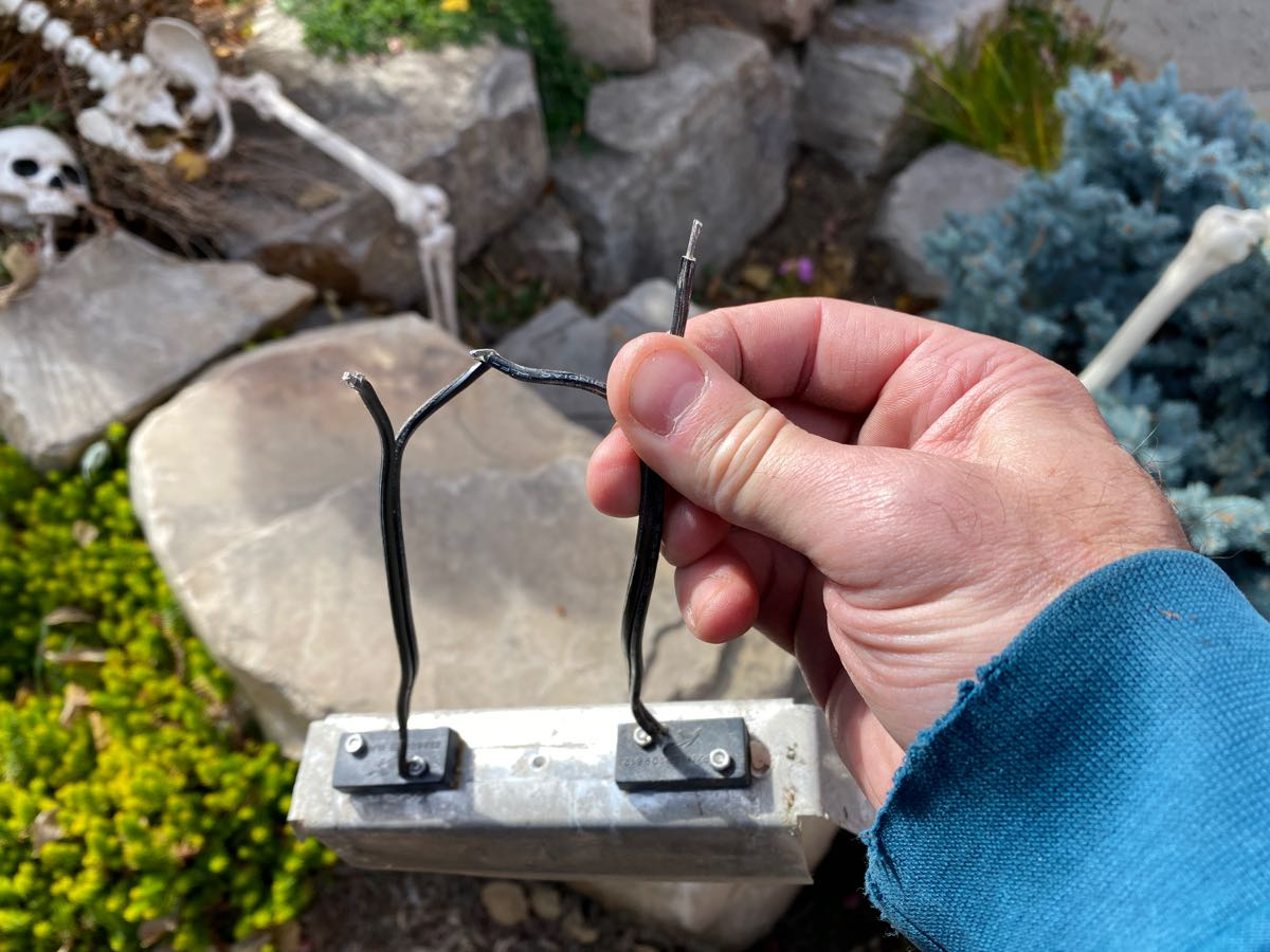

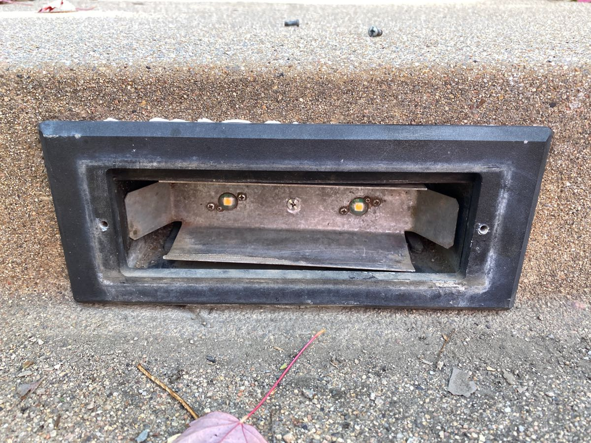

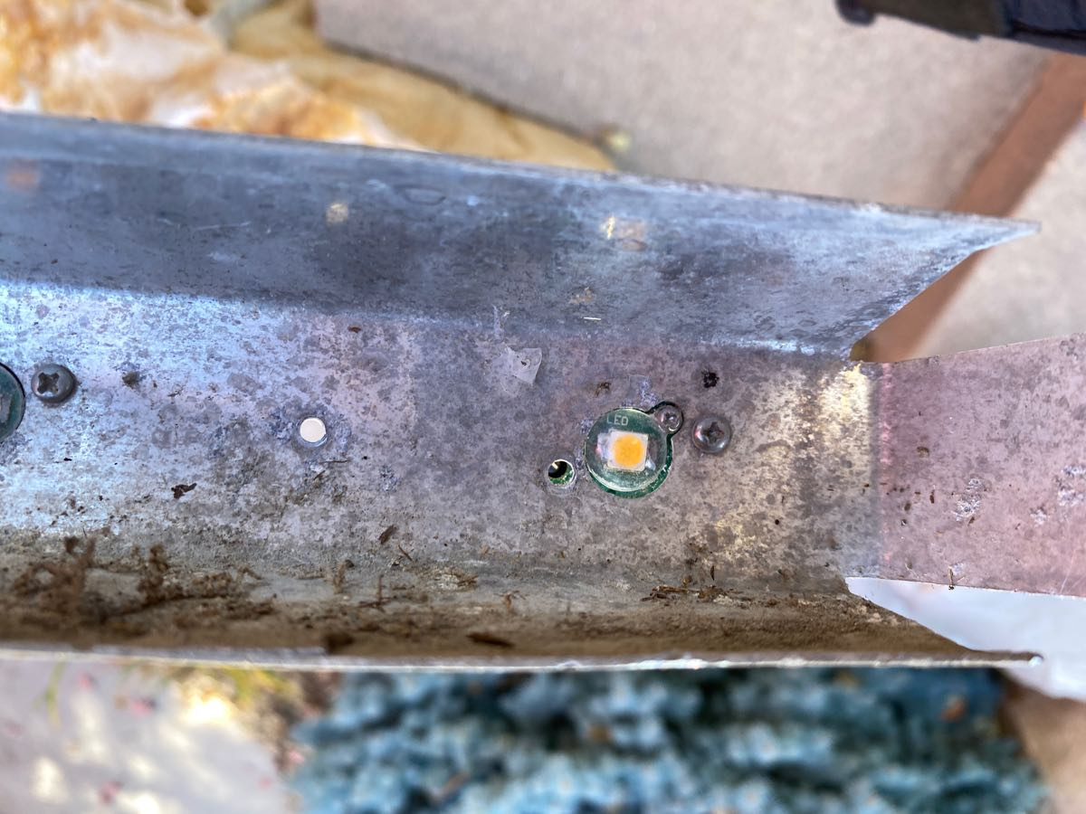

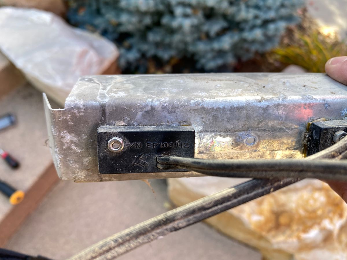

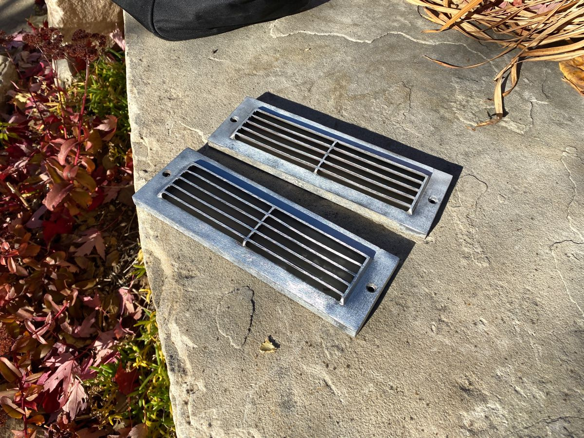

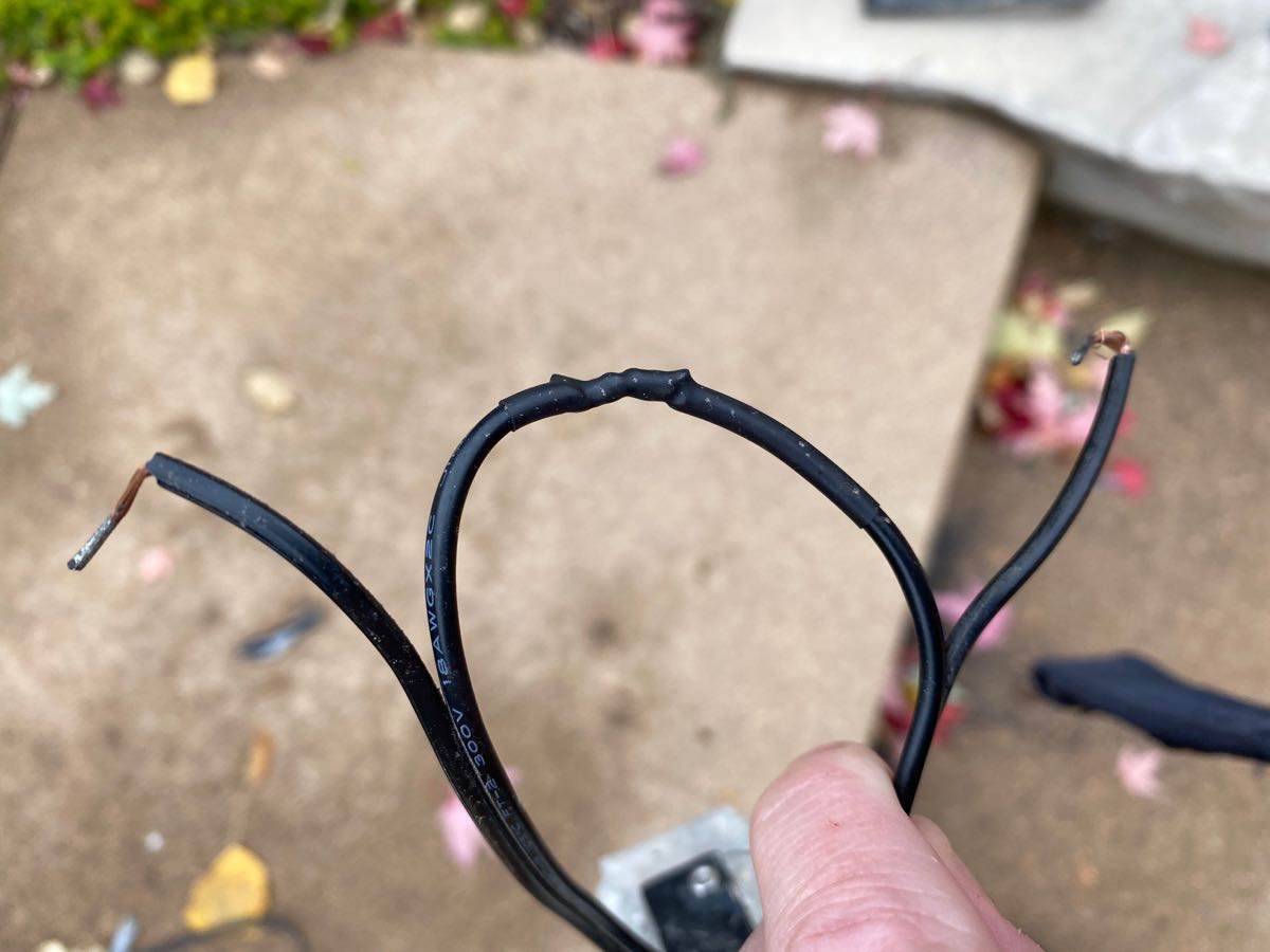

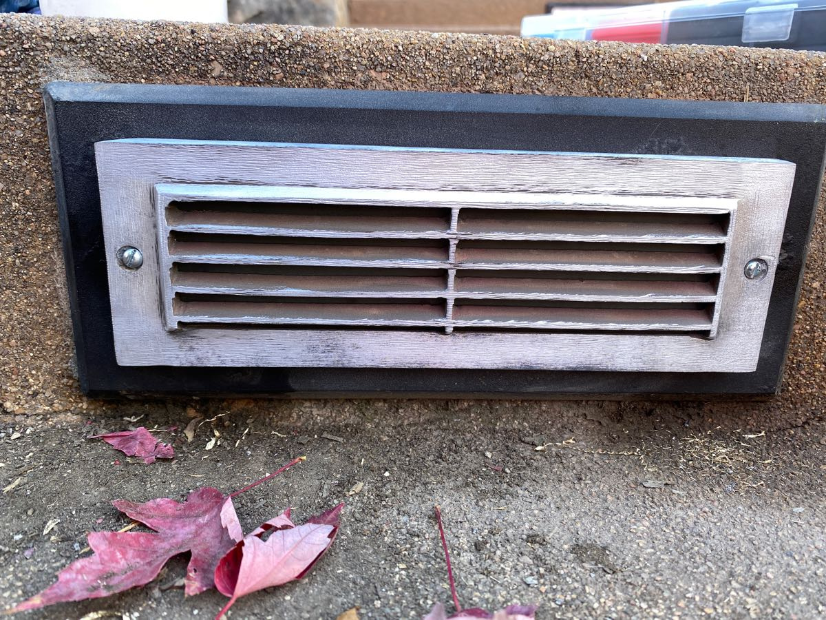

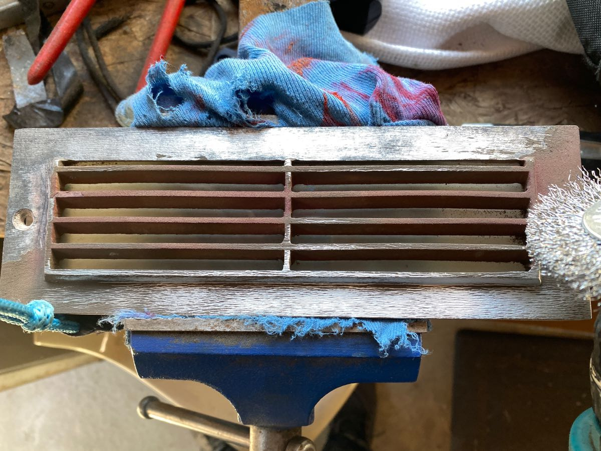

Last month I went to actually do something about this and finally get my step lights working. I procrastinated all summer, so it was time to get busy...
So my house came this way. I began looking for the underground low voltage lines that were rumored to be there hooked up to the step lights, but not hooked up to power.
This was the only info I had on the situation, and it was something the previous owner said at the closing table to me in 2018.
In other words, the step lights had never worked, not for me, not for anyone.

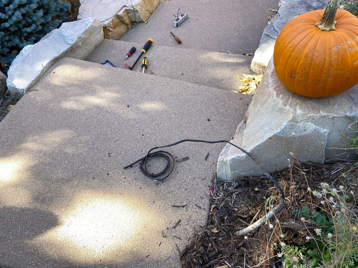

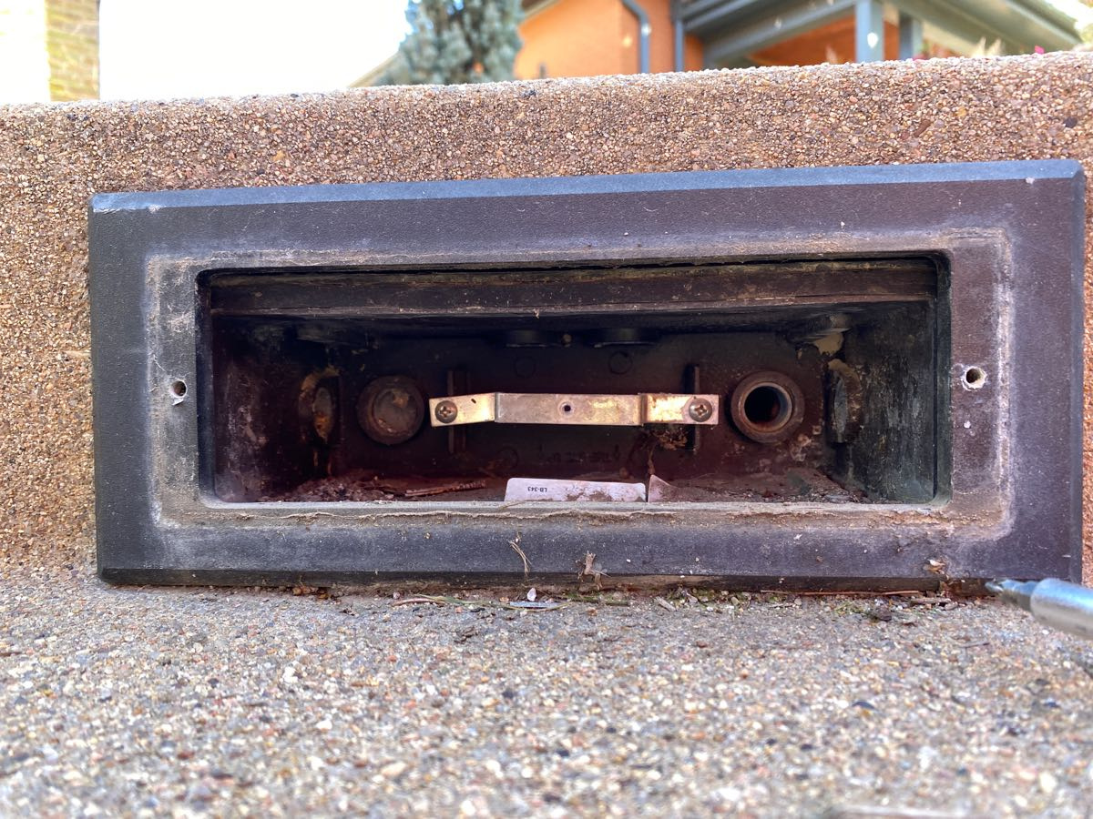

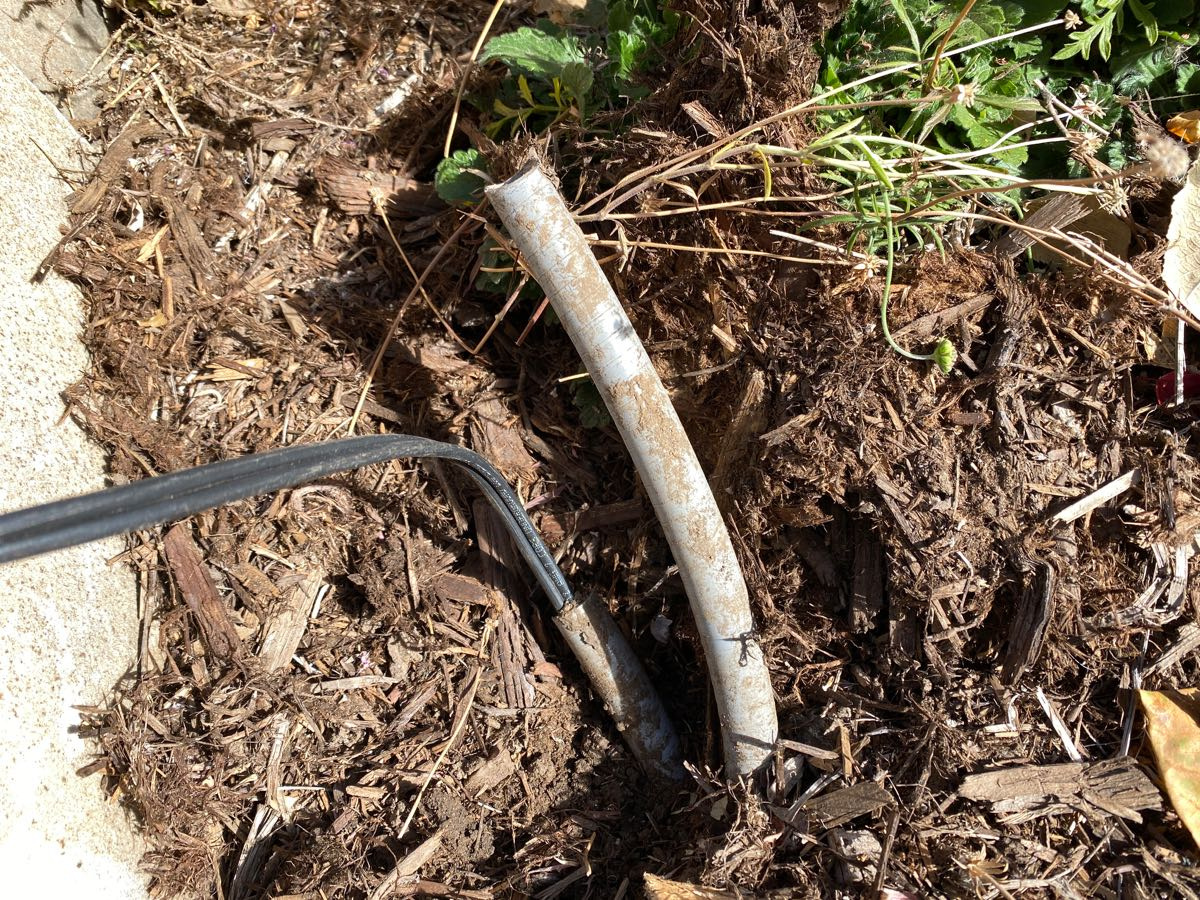

After getting the grilles off and LED light brackets out, I discovered the lines aren't actually run to the boxes. There is a line going all the way to the back of the house from the sidewalk, and there are boxes, but they don't meet.
I didn't know about the construction standard of using conduit, so it took me poking around to find... conduit. I thought lines would just run up to the boxes under the concrete steps.

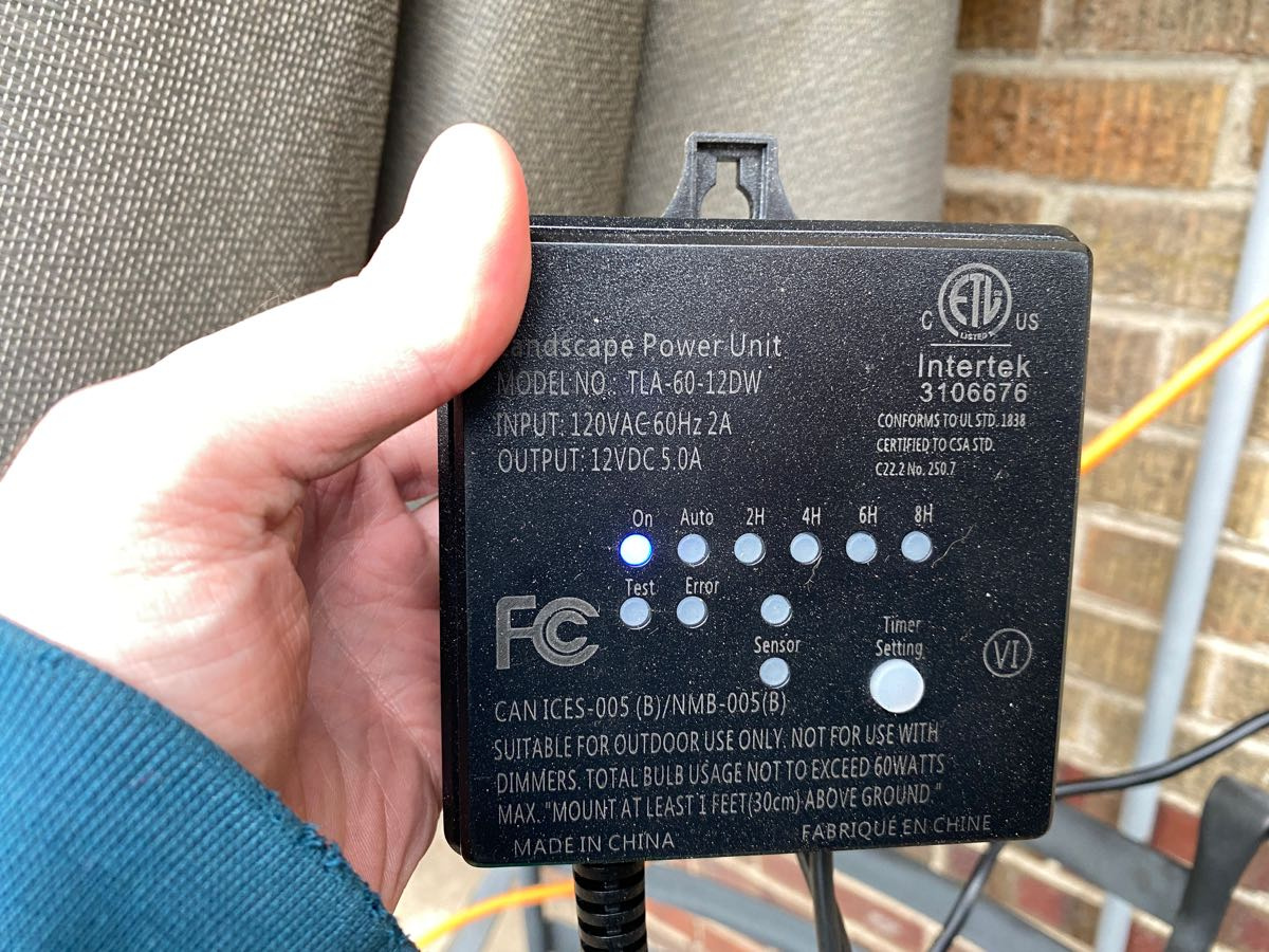

I bought a $37 daylight sensor/120->12v DC box for this.

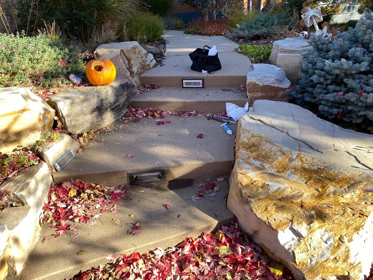

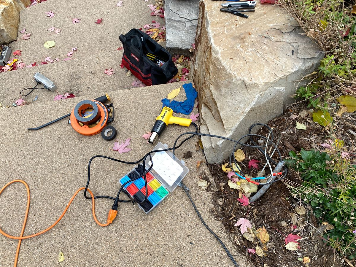

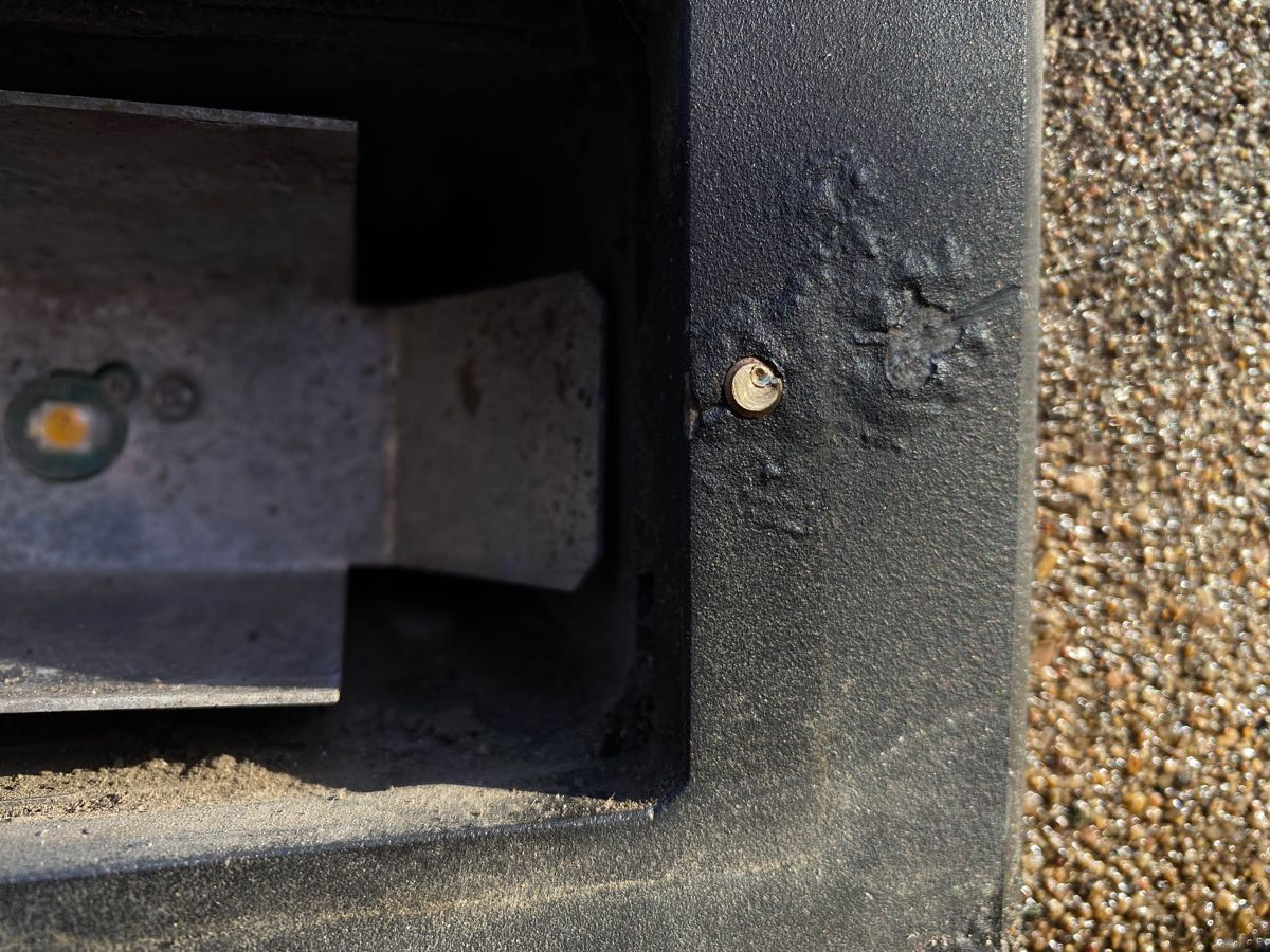

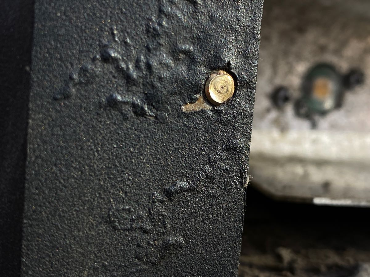

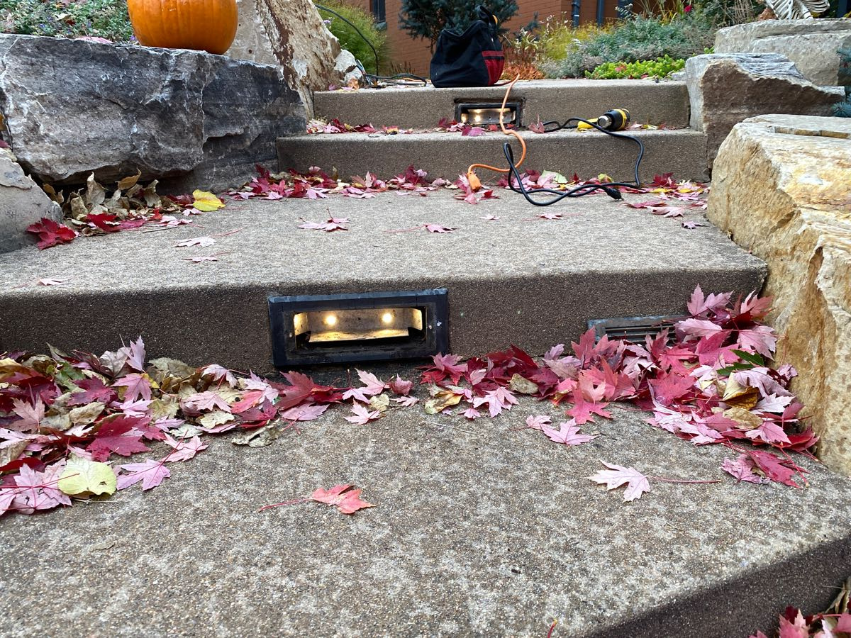

In these photos you'll see my work, from in-situ proof of concept, to dealing with two screws that sheared off at their base (ugh), to shrink-wrapping the wiring with my new $25 heat gun, to completion.

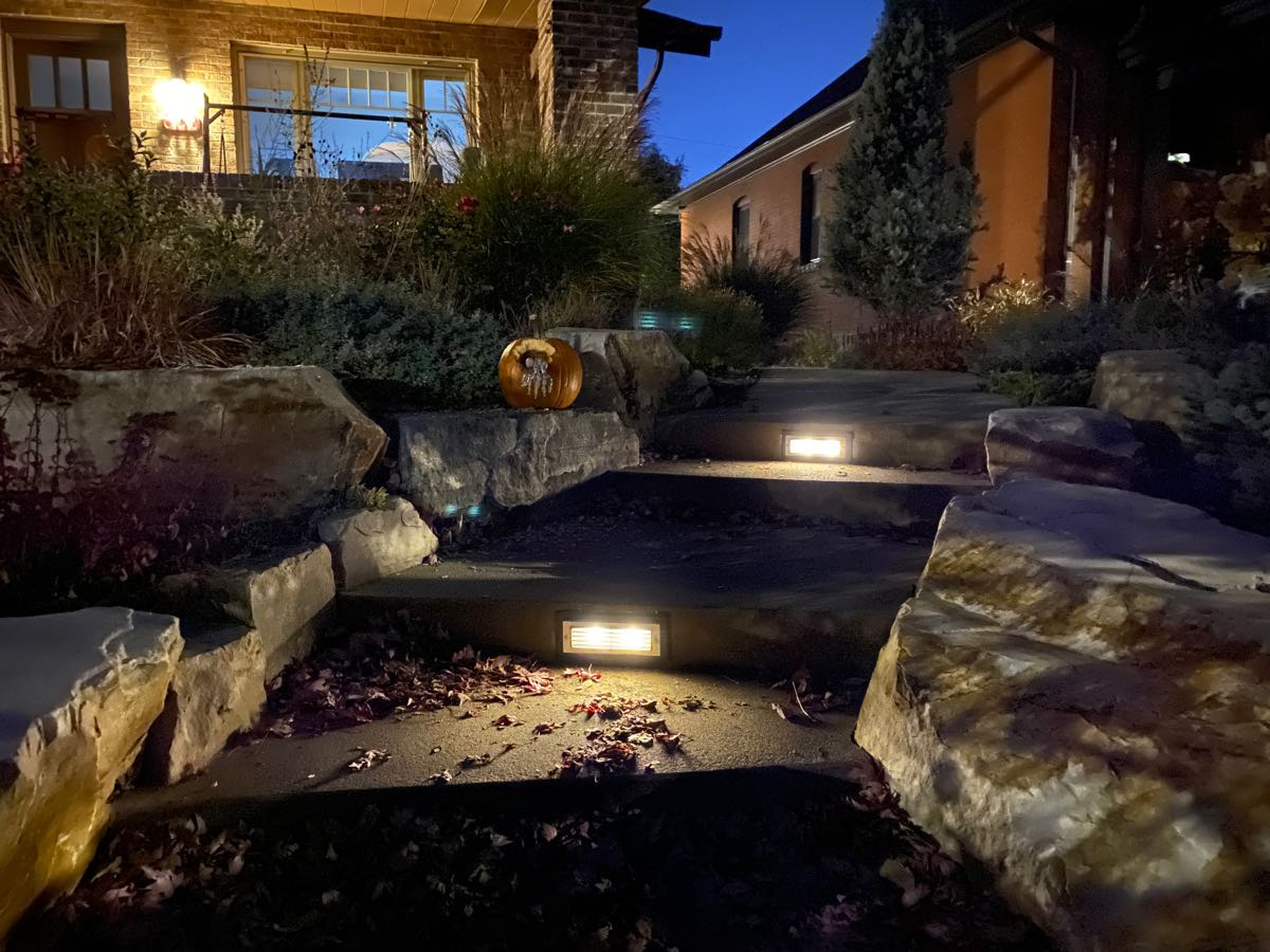

The lights come on at night by themselves because the AC->DC box has a daylight sensor. There are other modes, but this is the mode I want. It plugs into an outlet at the back of the house, under the electrical panel.
