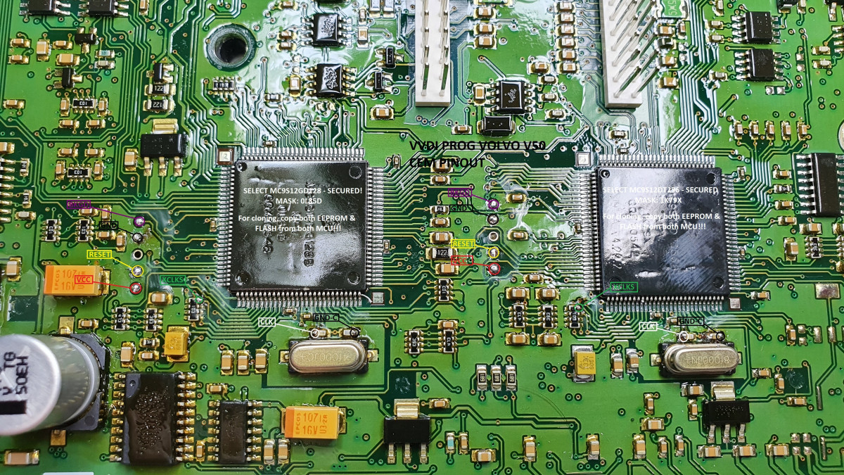

Every last one of the V50 EWDs ( Electrical Wiring Diagrams ) are online ... in multiple languages. The EWDs have the connector pinouts. It is not straight forward but there is enough information that you can map out the pins. It will take some legwork.
4/56 is the CEM.
Schematic:
Connector:PIN
Example A:1 = Connector A : Pin #1
Connectors:
4/56A is connector A on the CEM.
4/56A:1 is pin #1 of connector A on the CEM.
Same goes for connector B, C, D, E, F, G, H
If you are looking to extract the dump file.
