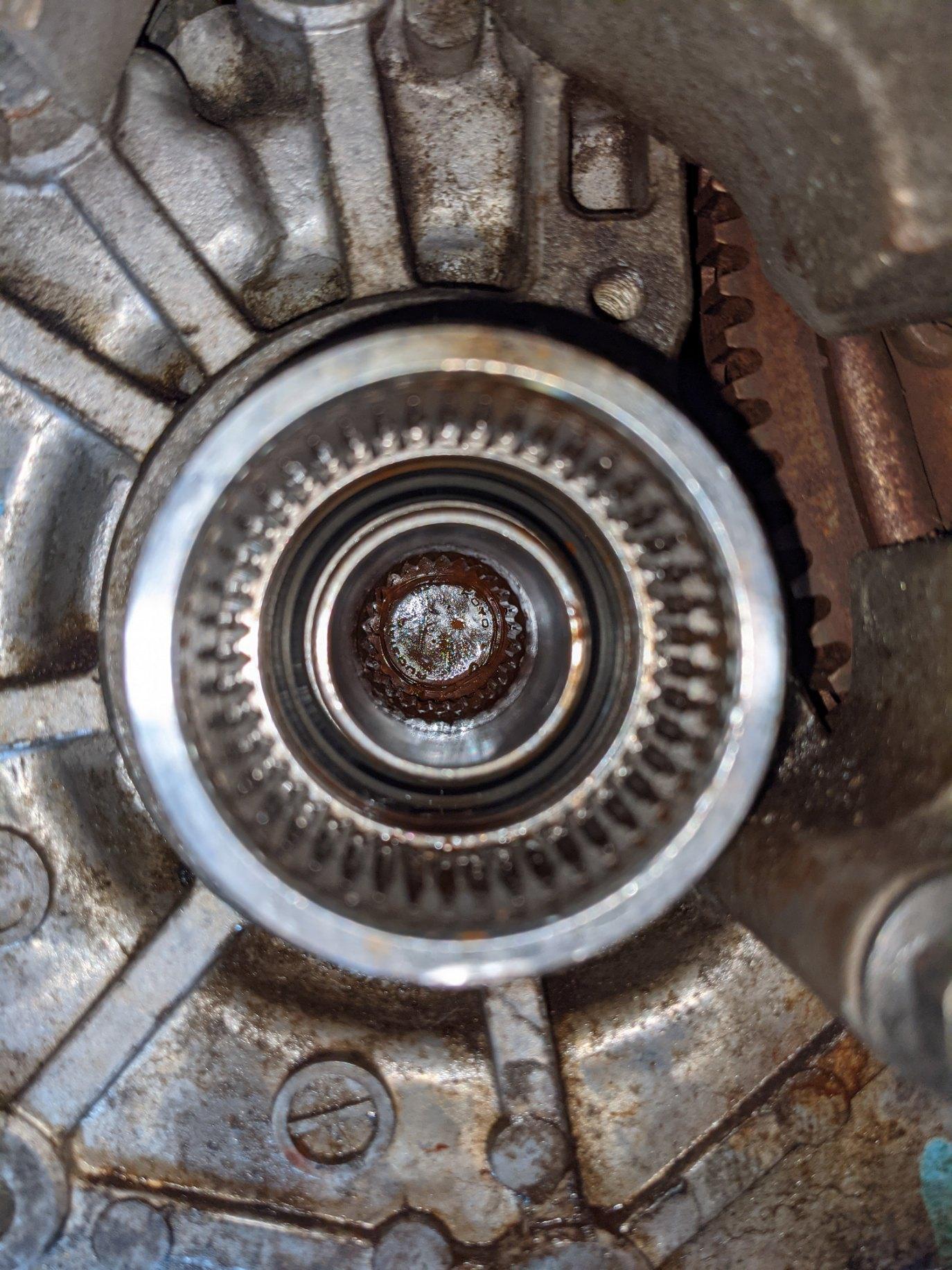

Hello,
I replaced the angle gear sleeve recently and transmission oil started leaking between the transmission and angle gear. The inner sleeve was a little crooked in the sleeve but looking further in my friend found another seal that looks damaged. Does anybody have experience with this? I can’t find anything in the parts breakdowns. You can see the seal I’m talking about in the pic if you zoom way in. It says KOYO on it.
Anything helps.
Thanks.
‘06 XC90 AWD 2.5T transmission seal behind angle gear sleeve??
Took digging but found out what it is.
According to this post the only way to reset the plug is by disassembly of transmission.
https://www.matthewsvolvosite.com/forum ... 6&start=20
