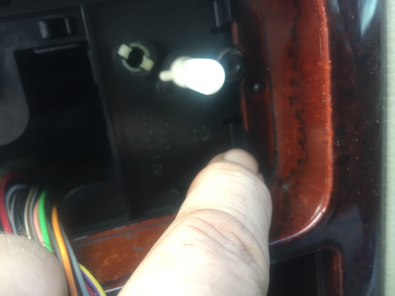

Brought my spare mcc control unit but as I pulled off the knobs and manipulated the plugs the lights flashed.
It turns out pressure on the rear face makes the lights intermittent. We put a spacer between the rear face and the mechanical cable unit and all is wellll

Sounds like some loose solder joints.
Glad you got it working though. No lights on the unit at night is no fun.

Ah, I know what’s going on
The bulbs bayonet the front of the circuit board on the MCC unit. The electrical connection is inside , on the rear of that board.
Slight Pressure on the bulb holders will disconnect the connections in the board and ,,,,, lights out
