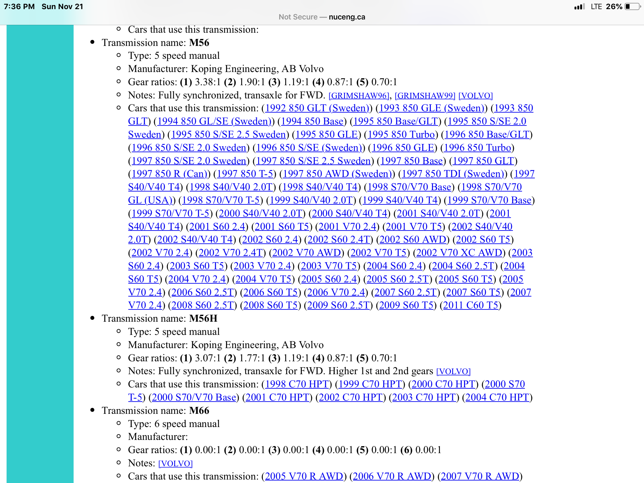

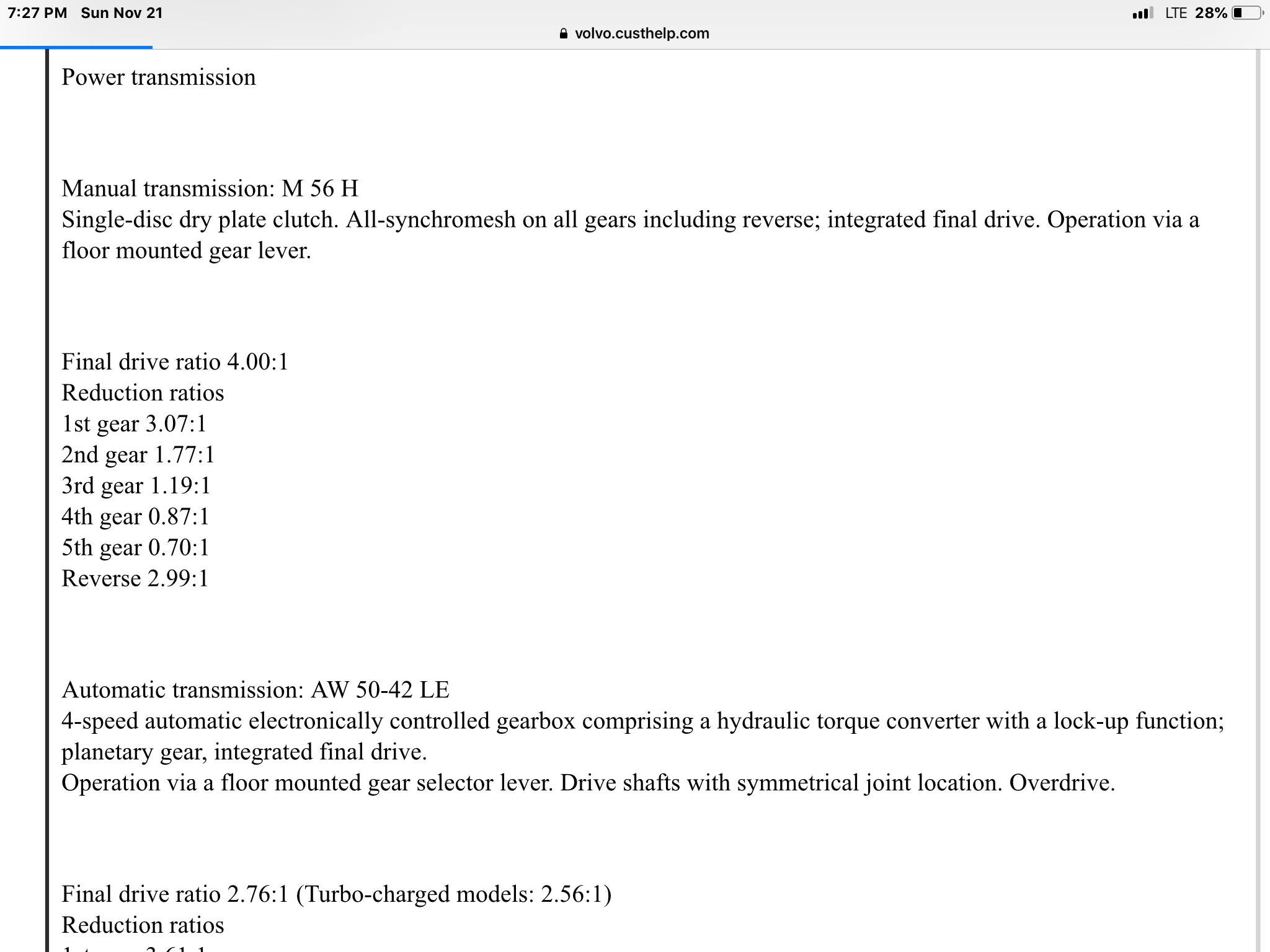

It looks more like the NA eng8ne uses the M56H with 4.25 final drive, turbos use the M56L with 4.0 final drive.

This resource implies the M56 crosses the P80 P2 design threshold
