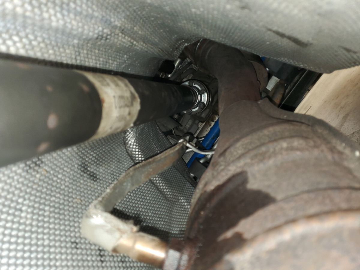

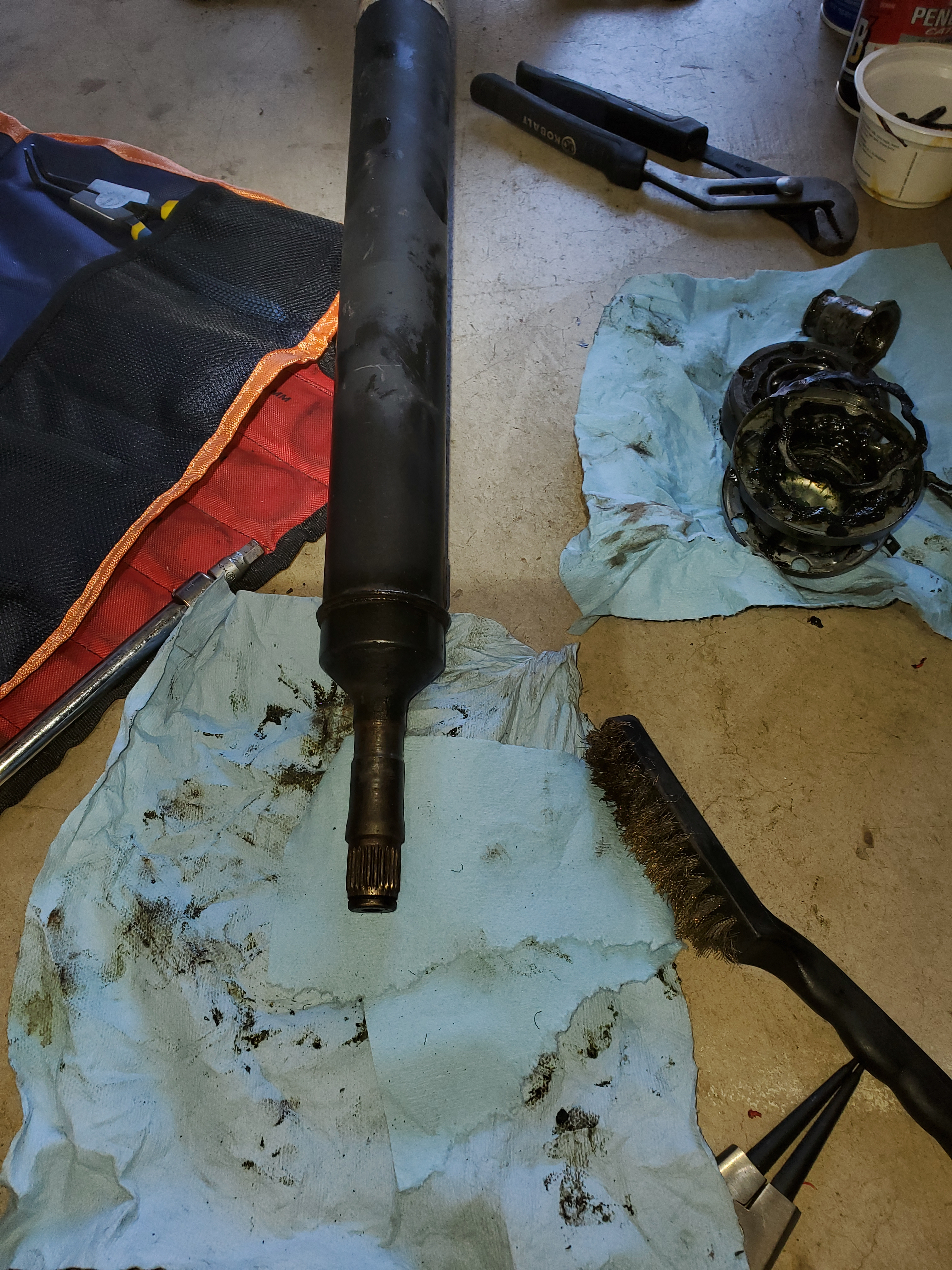

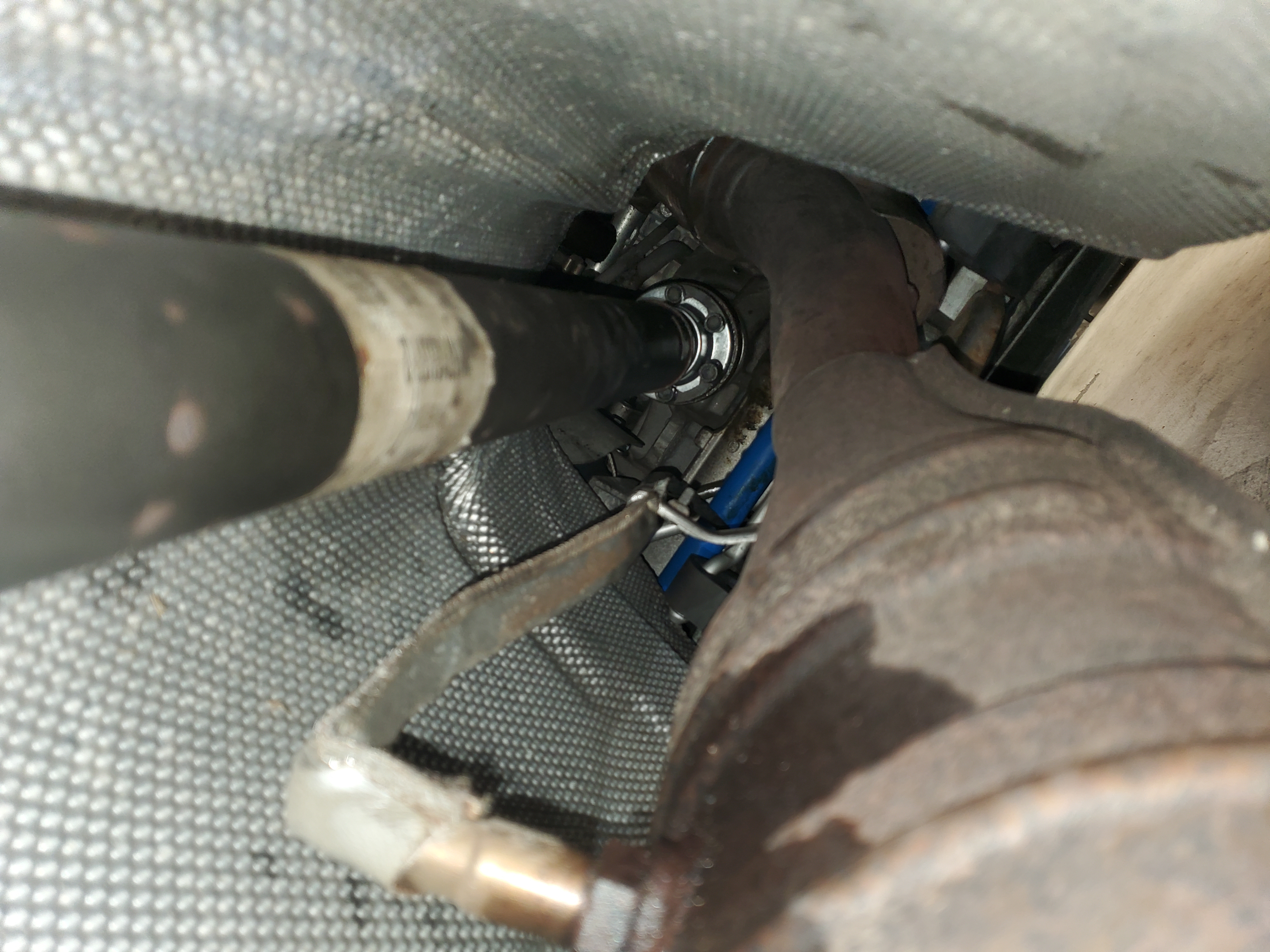

Shaft out, front CV joint removed:

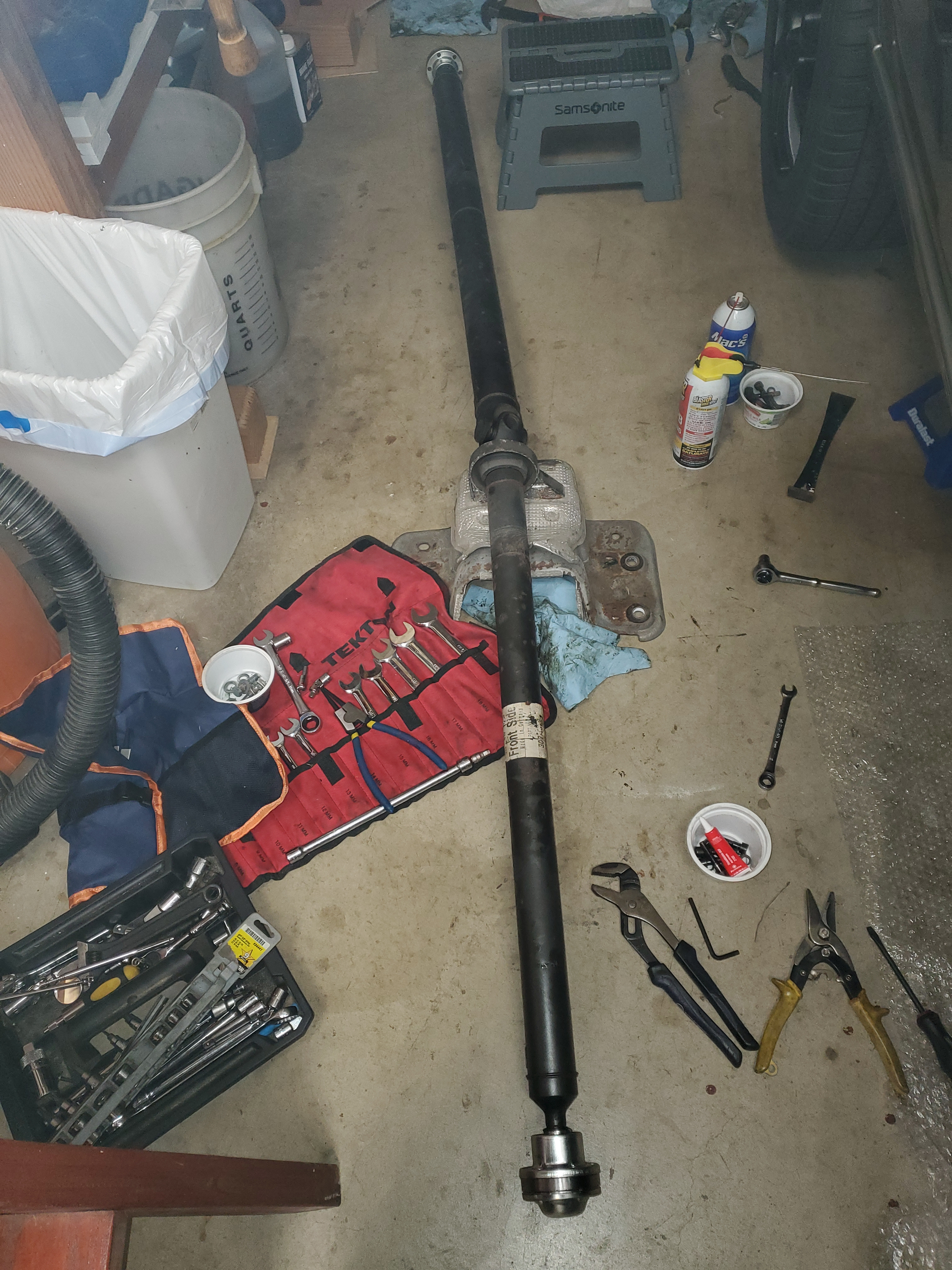

Both CV joints replaced:

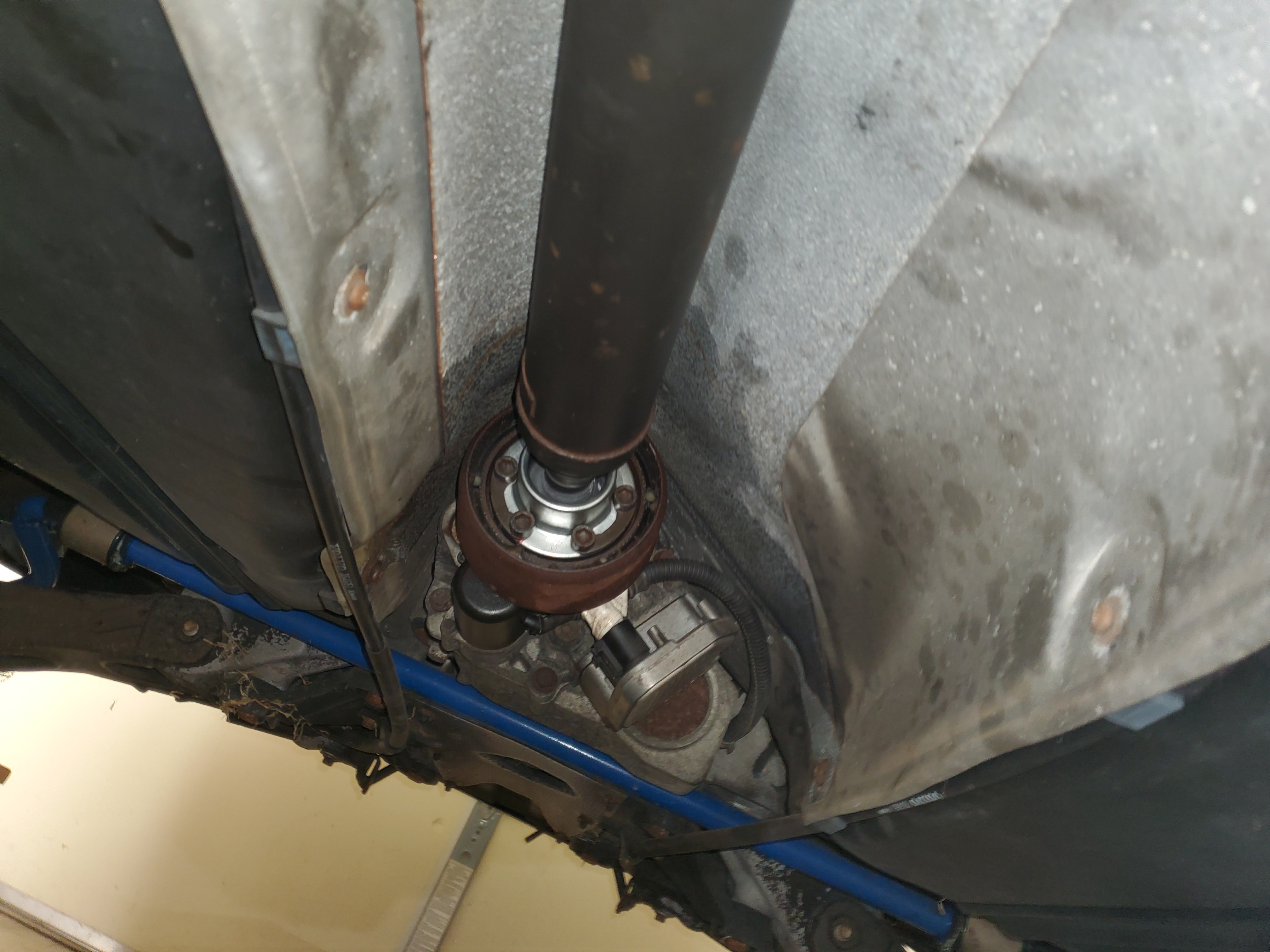

Close up of rear CV joint (old, removed joint in the upper left):

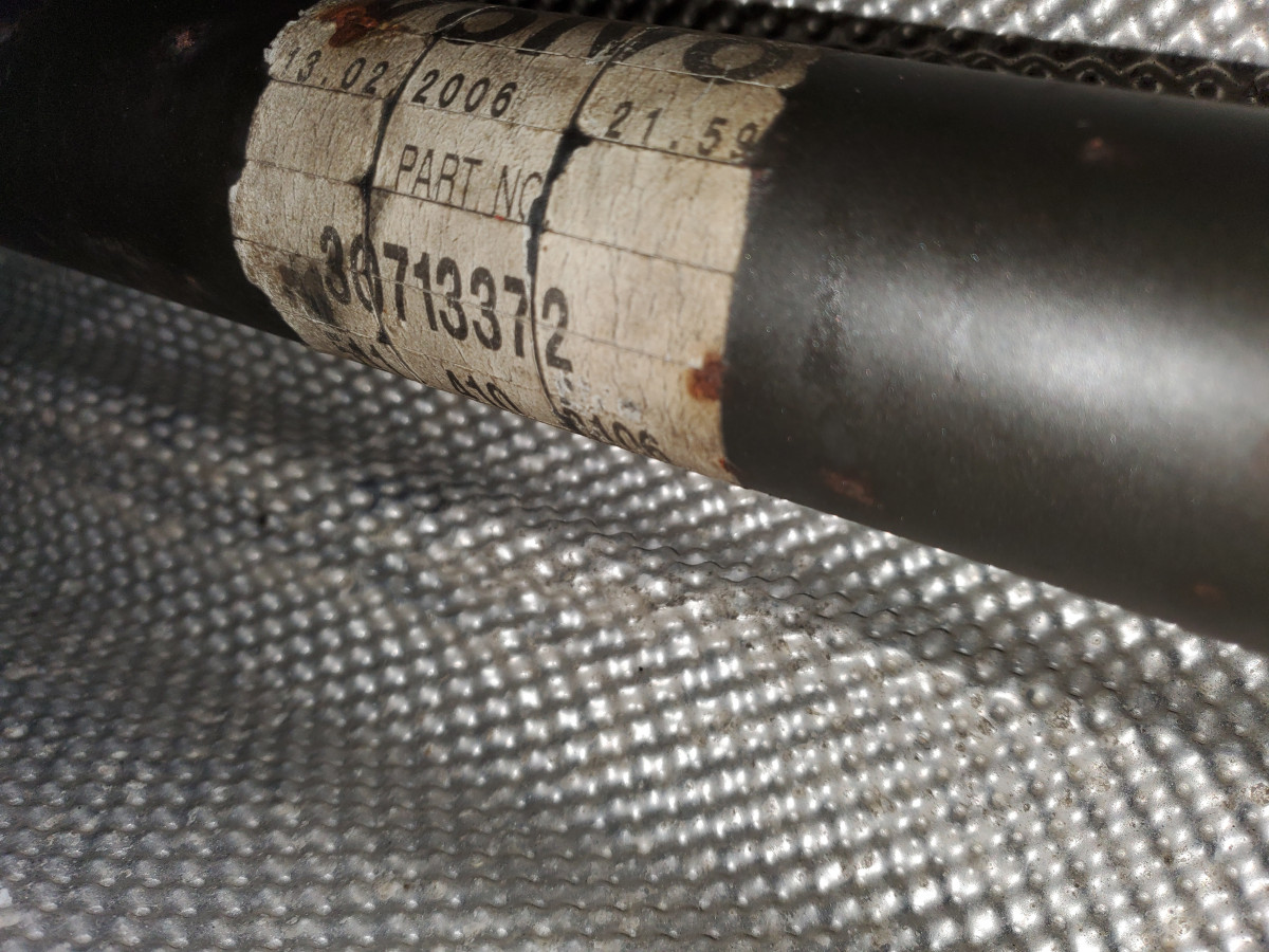

For reference, my driveshaft has the following sticker/part number on it (30713372):

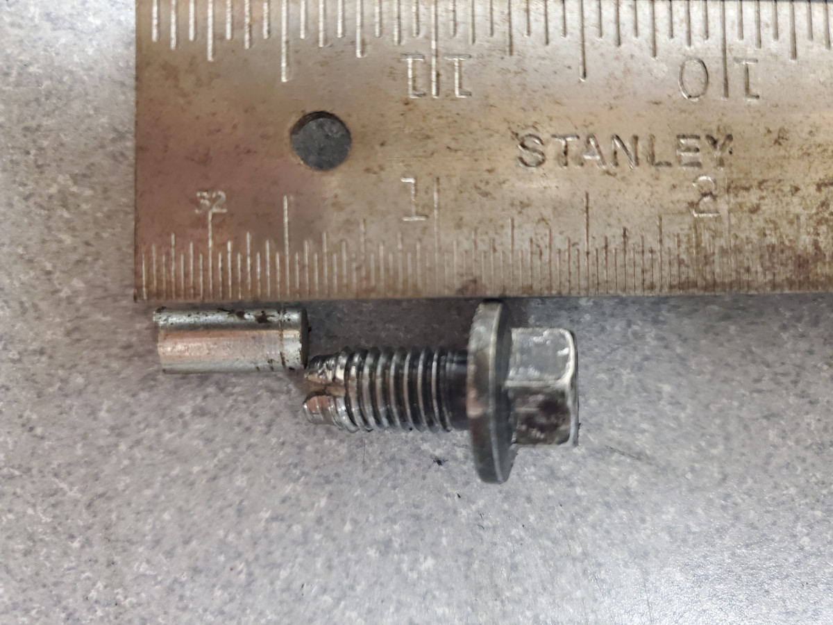

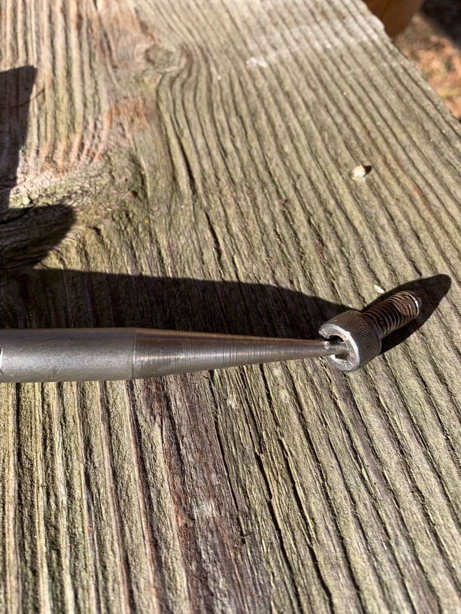

Probably the most helpful piece of advice I found for the process was the bit about using a sawed-off screw shaft (the smooth part, not a threaded piece) and an improvised tap to push out the rear CV joint from the Haldex. If not for that trick I'd still be under the car trying to separate the two. I snapped a pic of the bolt and shaft pieces I used so you can get an idea of the necessary lengths. Bolt is M8x1.25, about 20mm. There's also a pic of where I threaded it in behind the Haldex flange to push out the prop shaft.
M8x1.25x20mm improvised tap bolt inserted behind the Haldex flange:
Here's the overall length of the tap bolt and the sawed-off bolt shaft used as a spacer:
Victory shots:

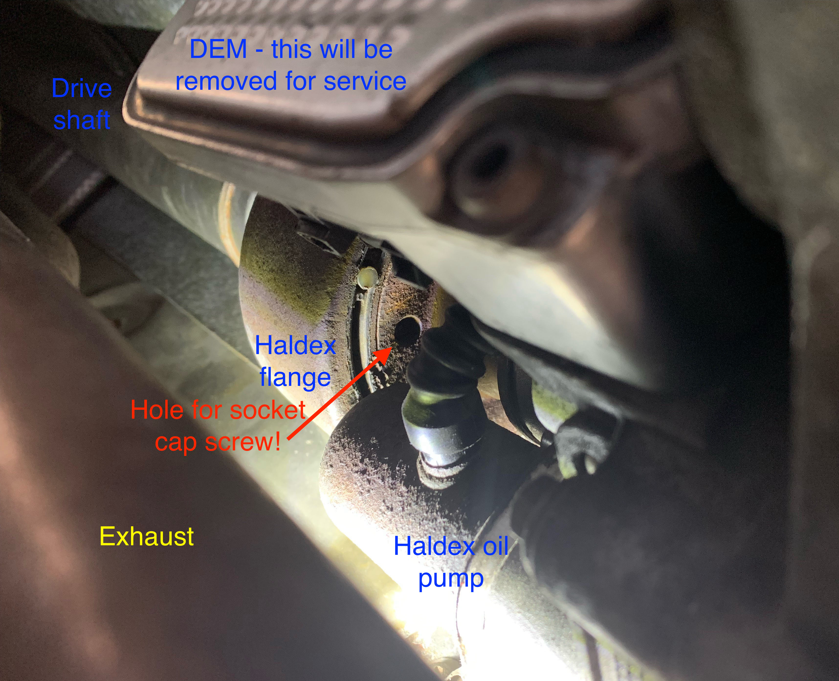

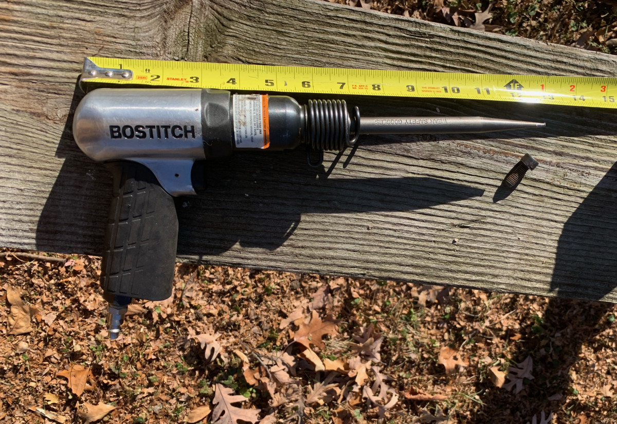

In the rust zone the CVs can get fused into the harmonic balancers and you may have to get more intense on "tapping" them out. I've removed a few now and what has been foolproof is to get a socket head cap screw that matches the 6 on the front of the CV, maybe a few mm longer even. This will slide through one of the the non-threaded holes on the rear of the harmonic balancer and act as your lever pin. The recessed hex head is key: you can put a pointy air hammer bit in the hex recess and zap the CV out without the bit slipping away and the air hammer damaging anything. Works really well, front or rear CV.

I’m not getting the visual on this Erik, maybe a picture sometime?

he's saying use a cap head allen bolt from the rear, through a blank hole into the threaded front plate, use a pointed air chisel in the allen bolt, the cap head bolt will prevent the chisel point from jumping out.

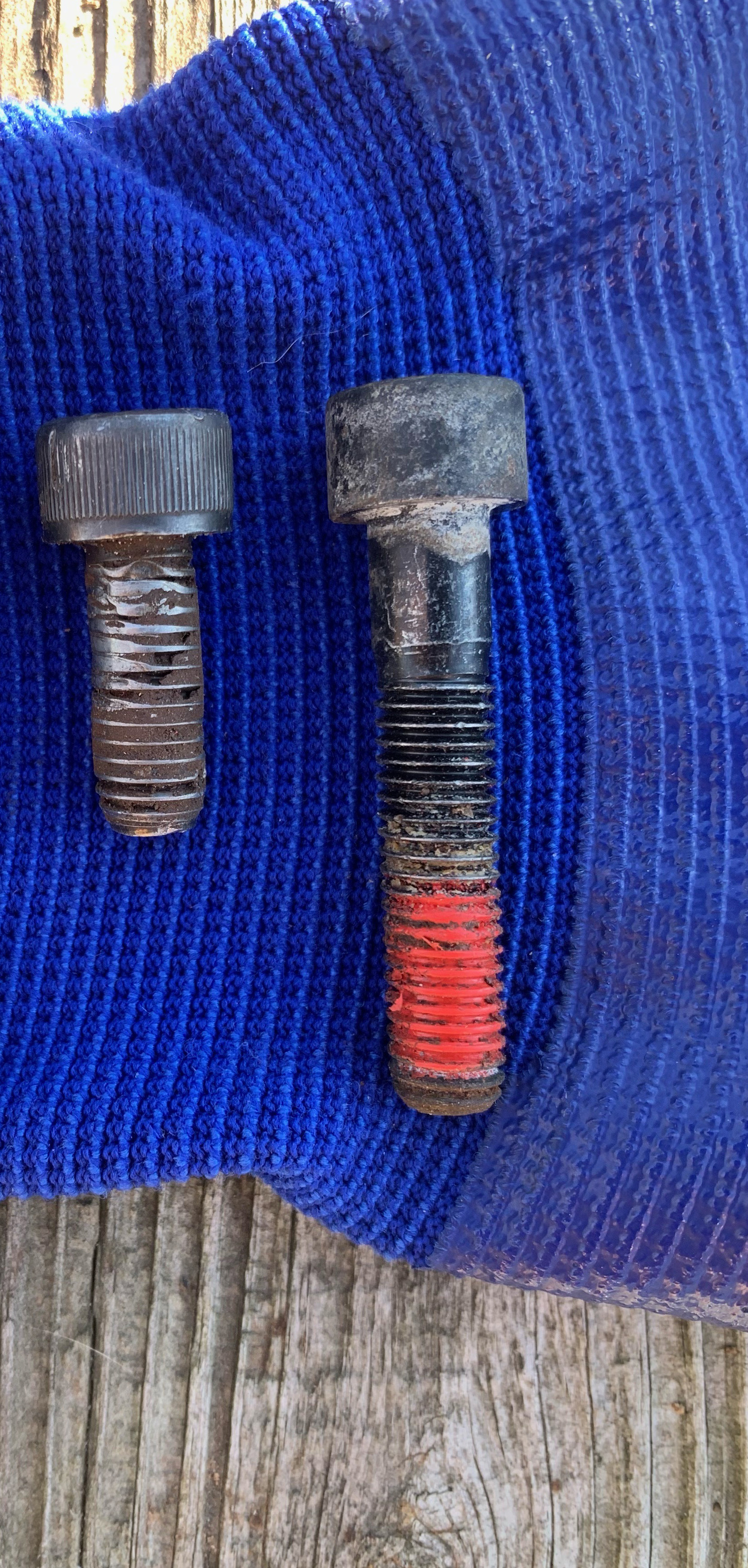

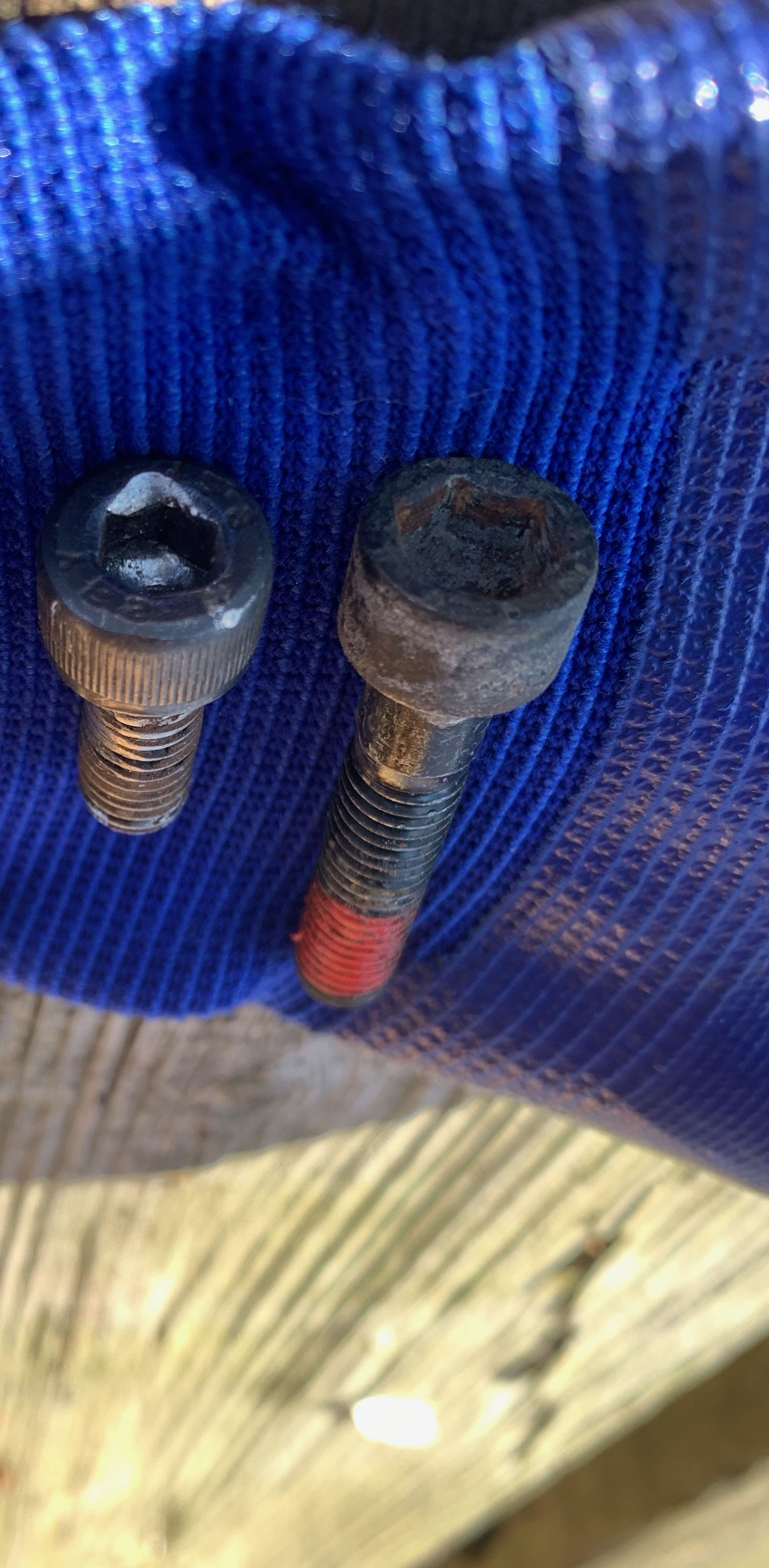

The long bolt with red loctite residue is a factory drive shaft bolt - those go in the flange from the front. On the short bolt that you can use from the back of the flange for driveshaft removal, I think its 12 mm long, you can see the threads are mashed in from using it to drive out CV joints. From the top, note the deformed socket head. Battle scars! The air hammer bit must be long-ish, at least 7 inches. The short pointy bit that came with my cheapo air hammer was too fat and too short. You'll dull the point in use but hey that's what it's for. This is the approximate angle when in use under the car. The socket head keeps the point of the air hammer bit from slipping. Access to the hole in the rear of the flange is easier when you are doing the job because you first remove the DEM. Sorry, no pics for the front of the drive shaft, but the same hammer bit and bolt worked up there, too.
