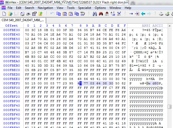

Checked P1 CEM with processor mask 0L01Y and found PIN @FBEF8 in order 4-2-1-5-3-0
PIN is 300377384764

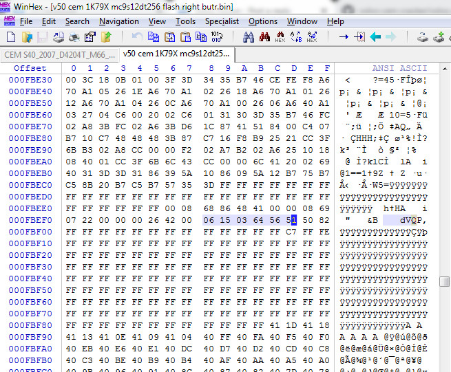

@ the same address PIN is located in P1 CEM with processor 1K79X mc9s12dt256 with the same byte order:

ZRimaZ wrote: 10 Dec 2021, 05:02 Checked P1 CEM with processor mask 0L01Y and found PIN @FBEF8 in order 4-2-1-5-3-0
PIN is 300377384764
4-2-1-5-3-0 is the shuffle order for .bin to PIN. VTL uses shuffle order PIN to .bin in the Teensy code.
The Shuffle order is {5, 2, 1, 4, 0, 3} in the Teensy code. Which is only flagged for a P2 CEM-B in the code.
What are the Volvo part number of these CEMs ?
List them in this format: Volvo Part Number, PIN Number, PIN Number in .bin.
unsigned char shuffle_orders[4][PIN_LEN] = { { 0, 1, 2, 3, 4, 5 }, { 3, 1, 5, 0, 2, 4 }, {5, 2, 1, 4, 0, 3}, { 2, 4, 5, 0, 3, 1} };
