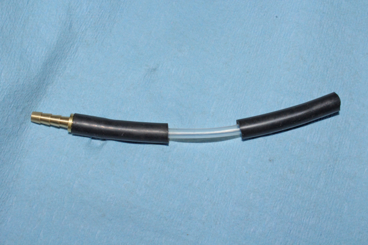

I used high temp, crack and chemical resistant PFA tubing for the small PCV hose. Matched the 3mm ID of the original hose because I believe this hose ID is used for flow restriction between the intake manifold and crankcase. The length of the PFA tubing goes from fitting to fitting with 4mm ID rubber hose ends used to join the 5mm OD of the PFA tube to the fittings. Volvo also sells this tube with the banjo fitting end. The PFA tubing isn't cheap but you don't need too much of it and still much cheaper than the Volvo part.notny41 wrote: 02 Dec 2021, 21:34 What's the alternative to silicone? Plastic? Or rubber I suppose. I have some clear vinyl tubing I could use - I'm just wondering if that would get brittle over time too? It is quite flexible right now, but that old hose that came off cracked in about 5 different places. I think it cracked as I was pulling hoses off the breather box, but nevertheless...

Ok thanks everyone! I had some thick-wall black rubber vacuum tubing laying around from a different project so I ended up using that and just put a couple worm-gear hose clamps on it to keep it on. I was able to thread the banjo fitting in first try - to my complete amazement, but I agree that you should put that banjo bolt on the intake manifold before installing the manifold to the head - otherwise there's just no f-ing way you are getting a wrench on it (I even have a stubby ratchet wrench and still no chance of getting it on - had to pull the intake manifold back off again to tighten the banjo bolt). I haven't started it up yet since putting it back together. I don't know if I feel like doing another marathon fix on this thing if it's still smoking like a chimney. I may just advertise it for $300 and if noone buys it, I'd probably just junk it at that point. I only paid $1k for it and we've used it for about 5 years. I think I got my money's worth out of it. I knew for sure it needed PCV attention after doing the glove-test and the fix for that was an inexpensive enough college-try for me (I got the REIN crankcase breather hose for $20 off amazon and the manifold gasket for $5). But if it turns out to also need turbo work, I don't think I feel like investing more money and scraping up the knuckles again...
Well, I have an update. I finally pushed the car back out of the garage and started it up. The good news is that now the glove tests passed and it is sucking the air out of the glove instead of inflating it. The bad news is it didn't seem to make any difference on the smoke that it is producing. So I still think it is the turbo. Now I am just debating if I want to deal with that... Ugh... My neighbor suggested that maybe there is just a bunch of oil still in the exhaust system that needs to be burnt up. I kind of doubt that though...
