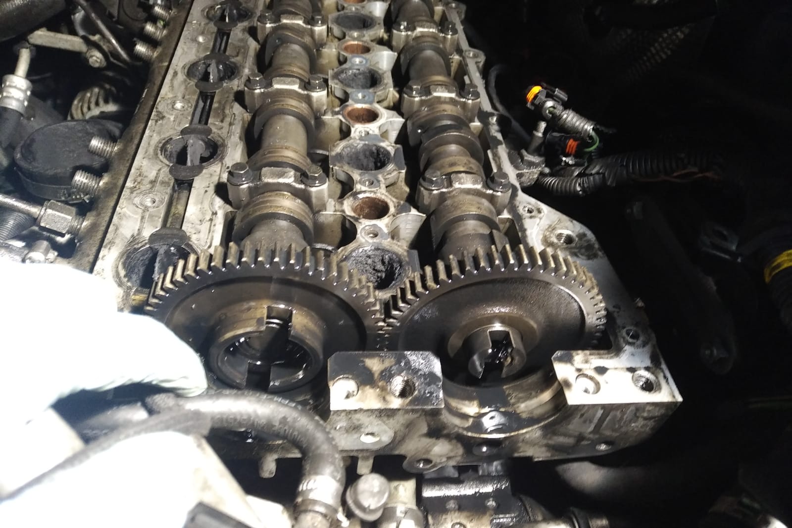

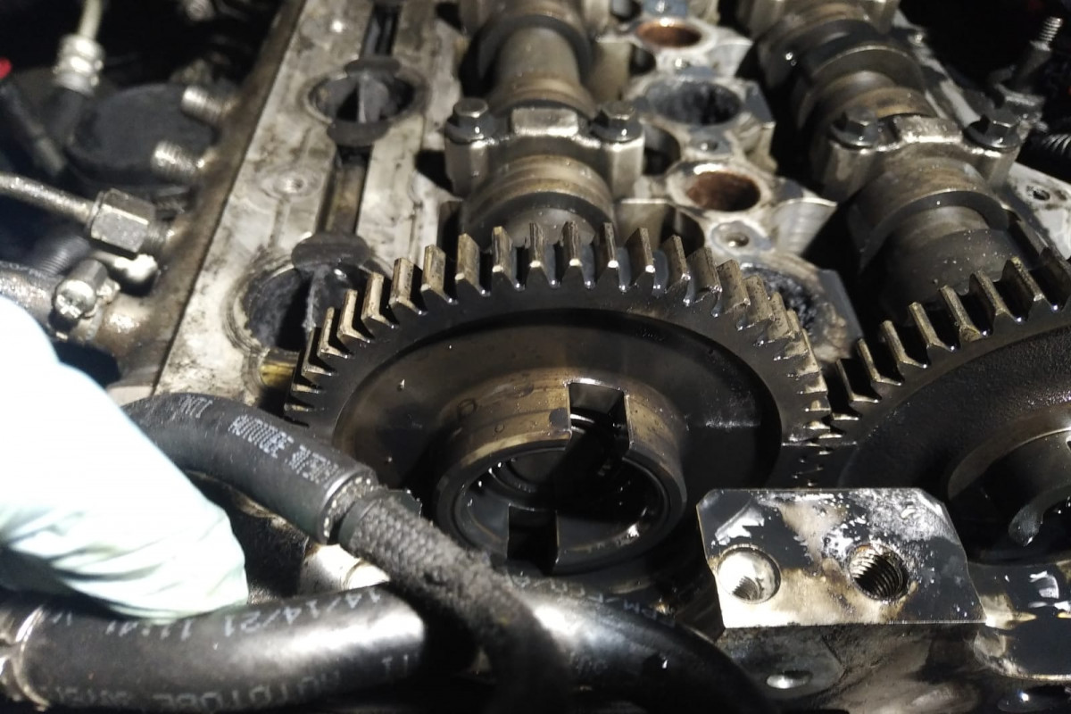

No luck...I tried your way but still the same. Just a thought...Could I have placed the camshaft incorrectly? Like just 1 tooth misaligned?
zakmuh
Posts: 49
Joined: 10 Jun 2016, 03:27
Year and Model: 2003 XC90 D5
Location: Nottingham - UK
Has thanked: 6 times
Post by zakmuh »
Removed everything again and checked. Single dot on the intake shaft (right) is in the middle of double dots on the exhaust shaft, as shown in the pic.

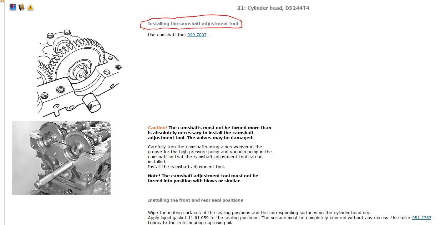

I didn't do the camshaft adjustment as per VIDA. This could be the reason for not starting?

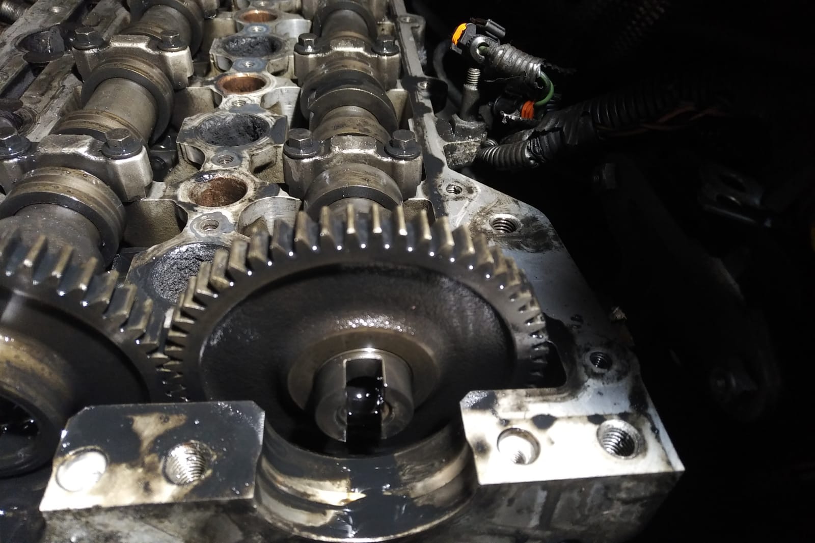

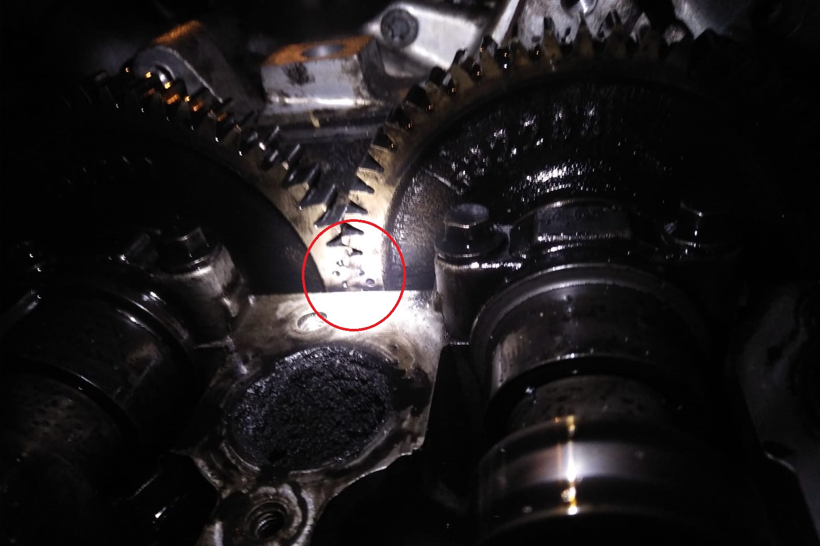

Post by zakmuh »
More pics from high pressure pump and vacuum pump side...
