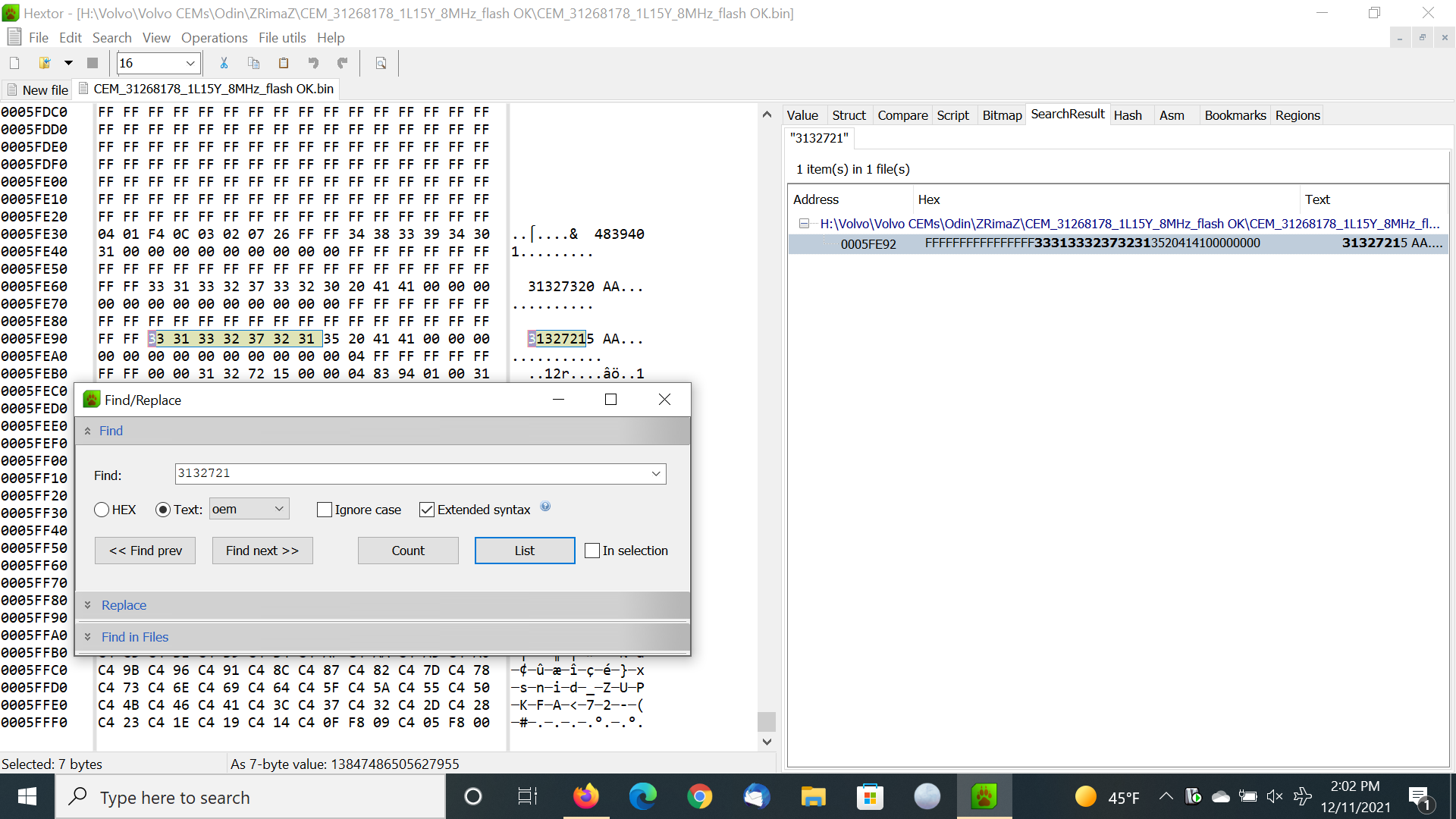

I now know where 31327215 came from. Change it to confirmed.swinokur wrote: 11 Dec 2021, 17:42 It was a while ago in this thread, but my P1 CEM did crack with the teensy code:
Part Number: 31327215
Searching P/N 31327215 in 49 known CEMs
CAN HS baud rate: 500000
PIN shuffle order: 2 4 5 0 3 1
Did you do a 31254749?

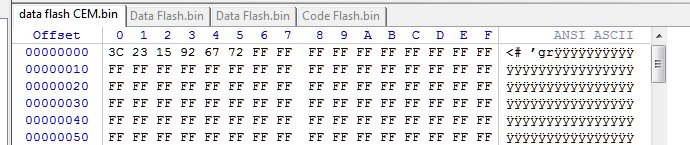

Hi, in my case what would be the right pin? Thanks!ZRimaZ wrote: 08 Dec 2021, 02:44Never checked it, but not I have done it ant -very strange -, but it looks very easy - P3 models with R32C processors R5F64525/R5F64524 have PIN located jus at the start of DataFlash, they are just swapped:RickHaleParker wrote: 07 Dec 2021, 12:43If you can, figure out the location of the PIN in .bin. Then parse the .bin files to extract the PINS. Publish the list of PINs. Perhaps we can spot a pattern.ZRimaZ wrote: 07 Dec 2021, 12:32 I have a lot of p3 bins. I do not know where then pin is located - there was no need for me until now to analyse it, but I can extract pin from flash in other ways...![]()
P3 CEM with M30882FJ processor has different system - it needs more deep analyzing. Attached are few flash files with PINs in their names.
P3 CEM M30882FJ with PINs.rar
- Capture_096.jpg (47.41 KiB) Viewed 1339 times

23 15 92 67 72 Shuffle {3,1,0,2,4} = 92 15 67 23 72 .
00 01 02 03 04 ....... Placement ...... 00 01 02 03 04
00 01 02 03 04 */ Placement /*
23 15 92 67 72 */ PIN in .bin /*
03 01 00 02 04 */ Shuffle /*
92 15 67 23 72 */ PIN /*

First of all, thank you, I forgot to say, that this is an CEM module mounted on an XC 60/2015RickHaleParker wrote: 12 Dec 2021, 15:2523 15 92 67 72 Shuffle {3,1,0,2,4} = 92 15 67 23 72 .

Another way to write a shuffle, which I think is better is: B:P 0:3 1:1 2:0 3:2 4:4 ( .bin to Pin, 0 to 3, 1 to 1, 2 to 0, 3 to 2, 4 to 4 ).
The advantages are:
The advantages are:
- 1. It is easier to read and work with.
2. If you want to the reverse shuffle to get Pin to .bin:- A. Flip each set, P:B 3:0 1:1 0:2 2:3 4:4
B. Re-sequence the numeric sets P:B 0:2 1:1 2:3 3:0 4:4 { 2,1,3,0,4 }
