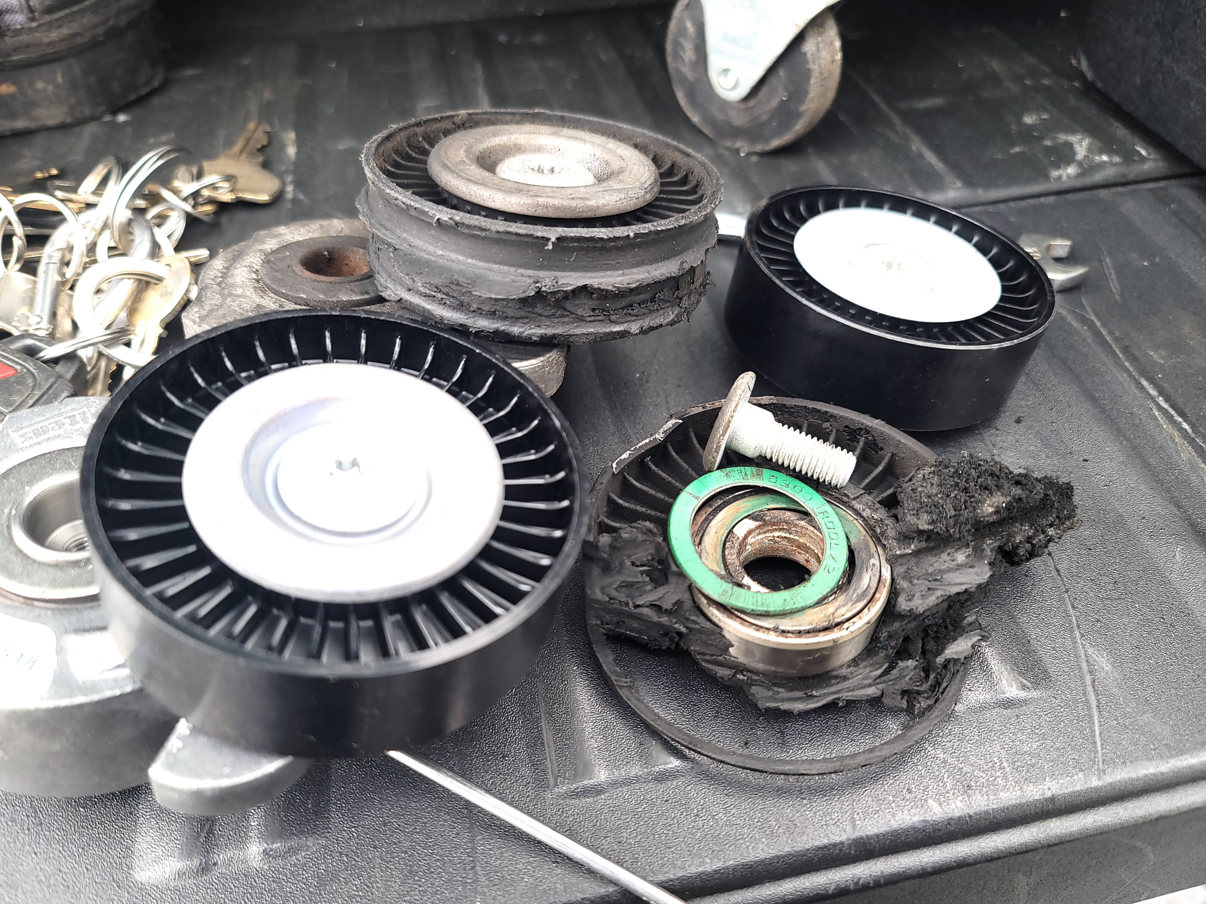

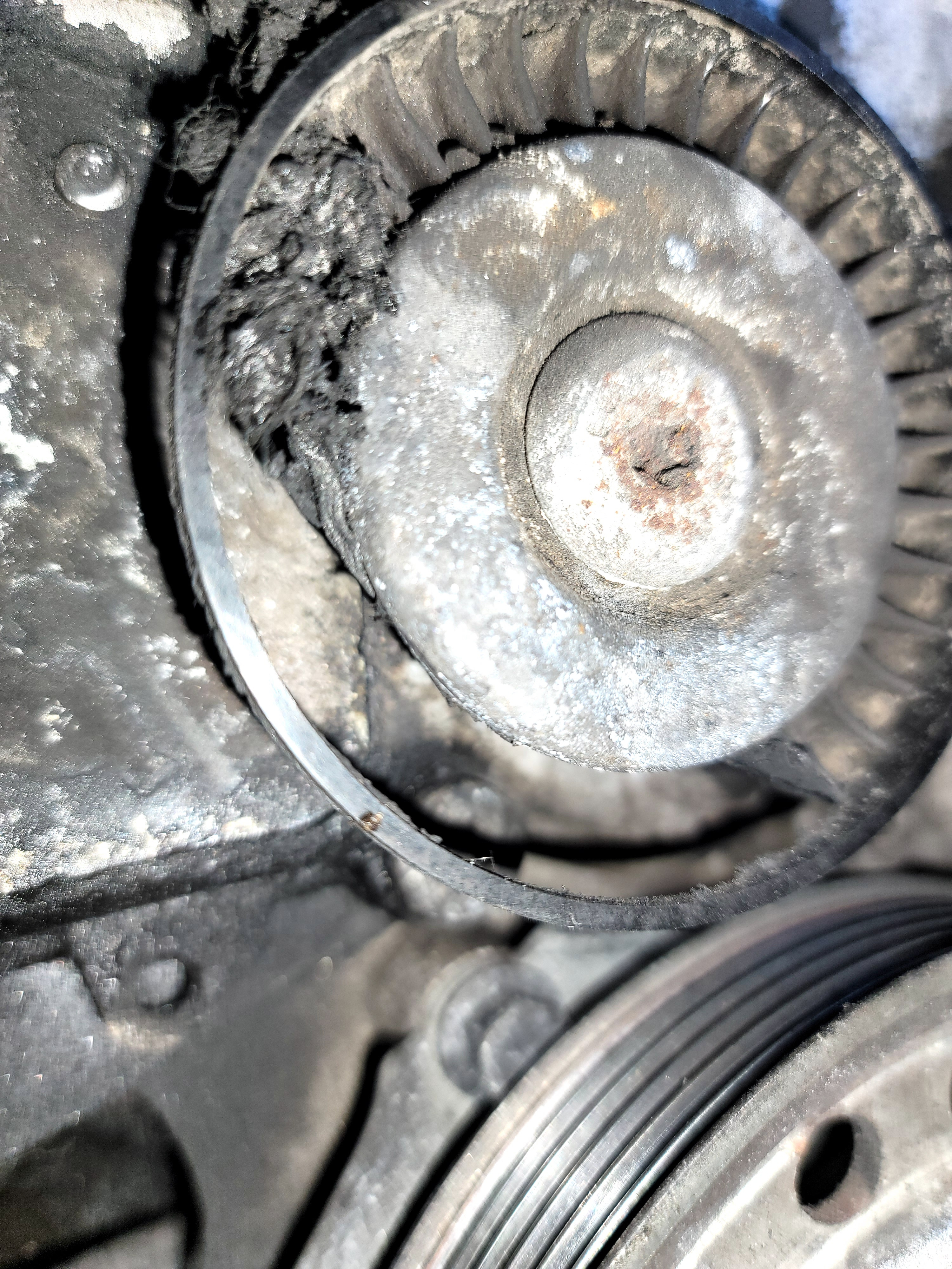

I knew this was going to be a tough job. My second Volvo with a straight six. I loved my old 164e, and when I bought this I felt like I was back at home again. The other day the serpentine shredded. Pullys both melted after getting shredded belt behind them causing catastrophic failure. In a far as the power steering pump and completely stuck. I've never seen a system like this. Everything weeks is loose, out of the way. Is there (and yes I've been searching the forum for about an hour with no help found) a good guide with photos preferably, to help me get this apart without having to spend a couple hundred bucks replacing whatever I broke going in blind? I really appreciate whatever help I can get, I need this car running and driving.

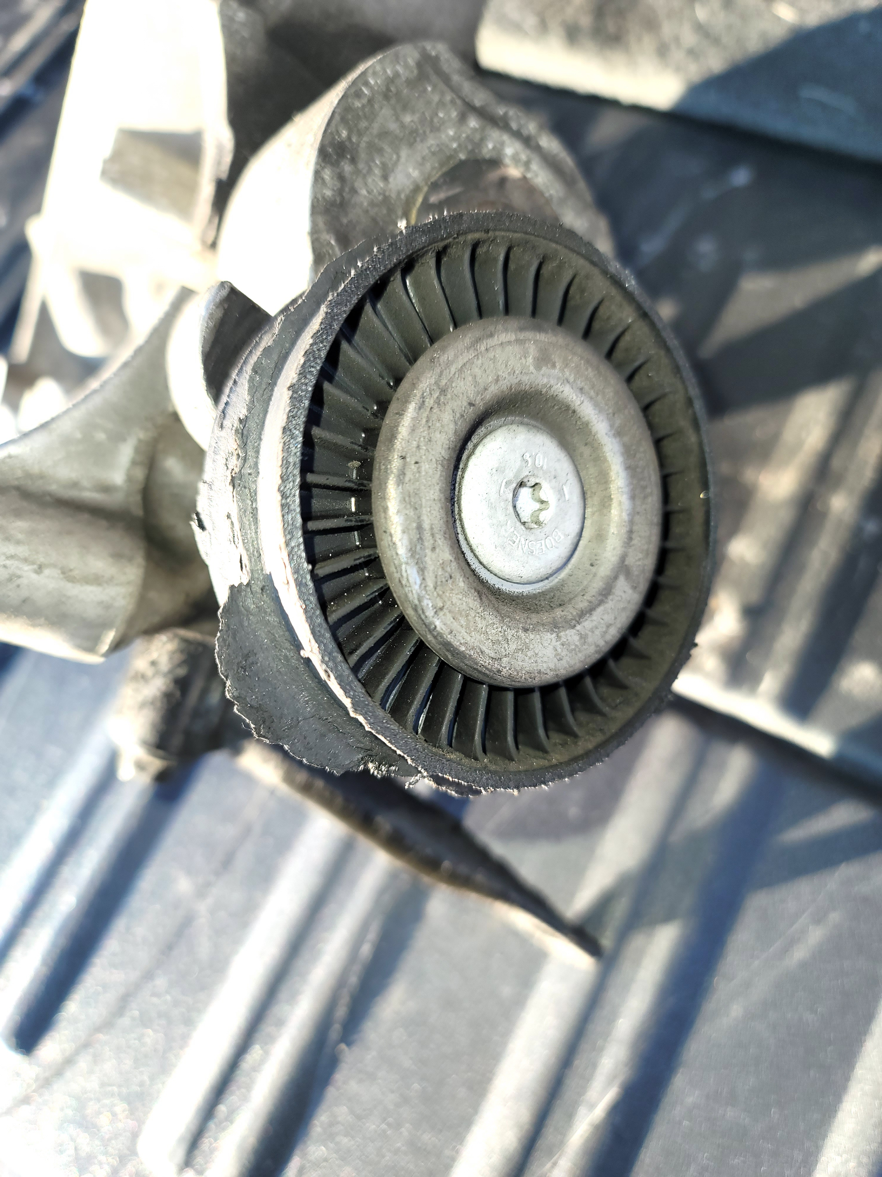

I'm not doing a blow by blow but I do have a couple of shots of the damage...it's gruesome and I'm fairly positive it was like this for at least a week (the time I've been smelling burnt plastic but unable to locate the source).

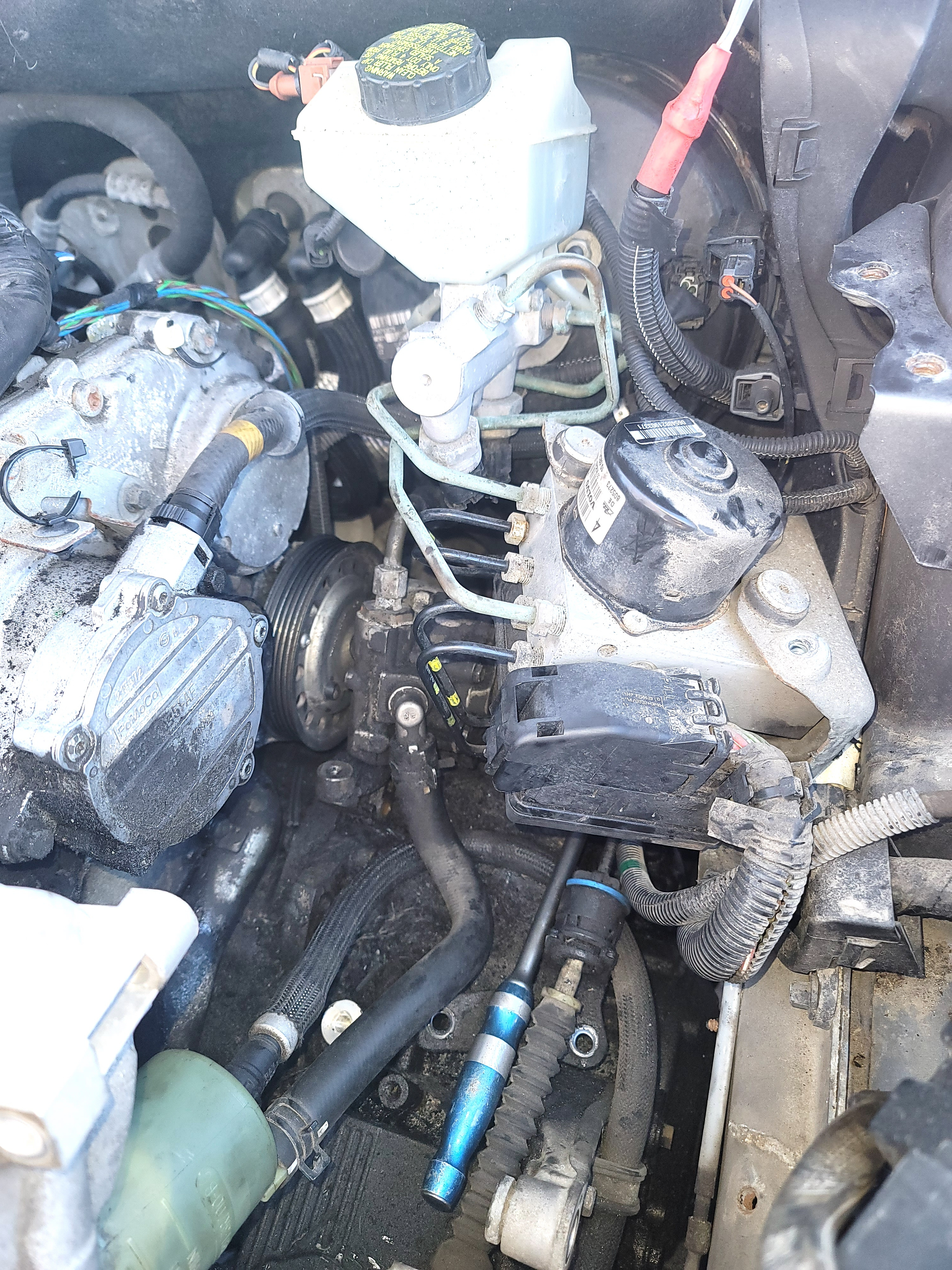

That little T20 torx bolt on the pulley stripped out. I'm so frustrated right now I could, and have, screamed. Any ideas or does the pump come out with the decoupler? I think I'm going to have to pull the whole thing.

You will need to disconnect the input and output of the power steering pump as well as all of the mounting bolts and then it will detach from the water pump.
It is likely that the spring will be stubborn to remove.
The only connection between the power steering pulley and the water pump is the spring

You can drill the head off of that Bolt and replace the spring and holder if you like

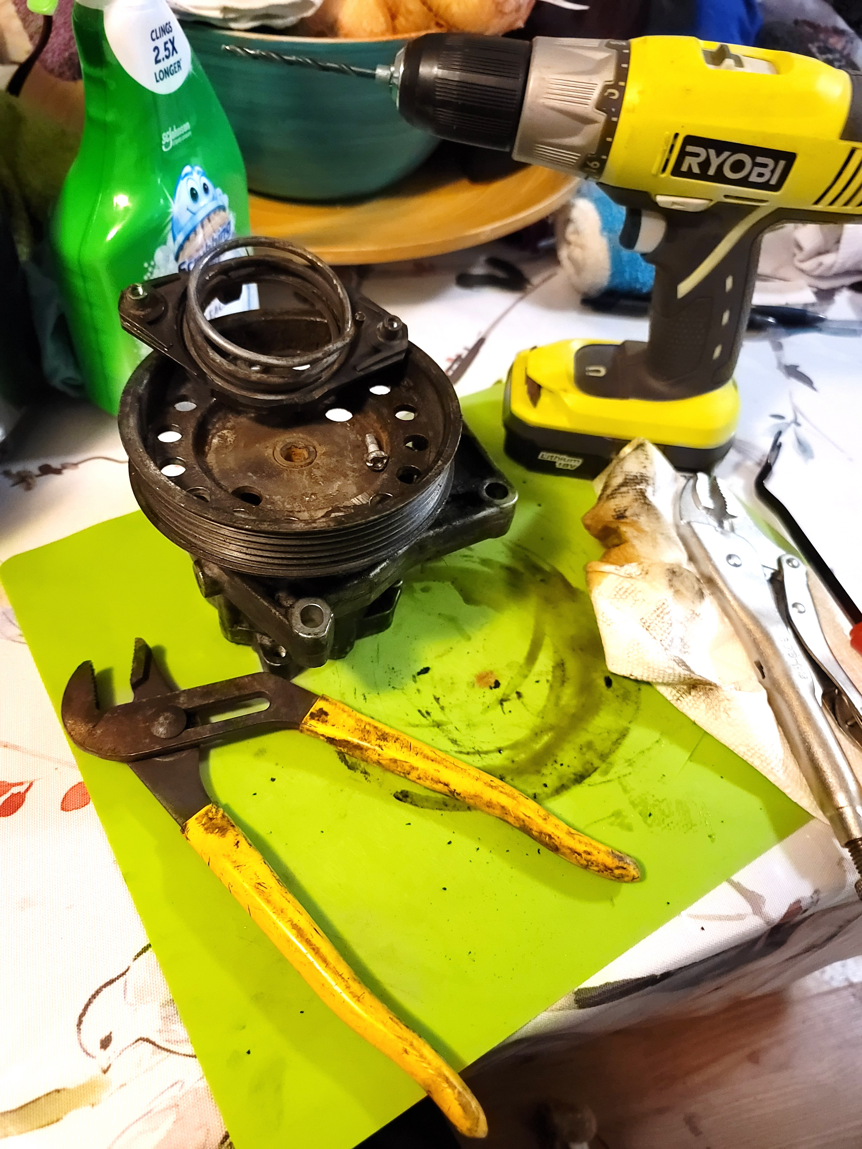

Thanks. Because of the ABS pump and brake lines I've got zero room to drill it out. I burned up my dremel trying to knock the top off of it as well. Today I broke down and pulled the entire pump, brought it home and got the bolt out of it sitting at my kitchen table (much to my wife's consternation). What's silly is that I couldn't get an M5x.08 by 15mm torx head anywhere in town. I was told by one of the places that the US market tends to skip M5? I don't know how true that is but I finally had to buy them on Fastenal's website and have them shipped from Indianapolis. The new ones are Allen heads though, so I'll be able to tighten them up with my ball-end Allen keys. I'll stick a touch of blue loctite on there just in case, wouldn't want them backing out. In case anyone is interested the Fastenal part sku 0154262 and they were $.84 cents apiece. $14 to ship it 2 day.
