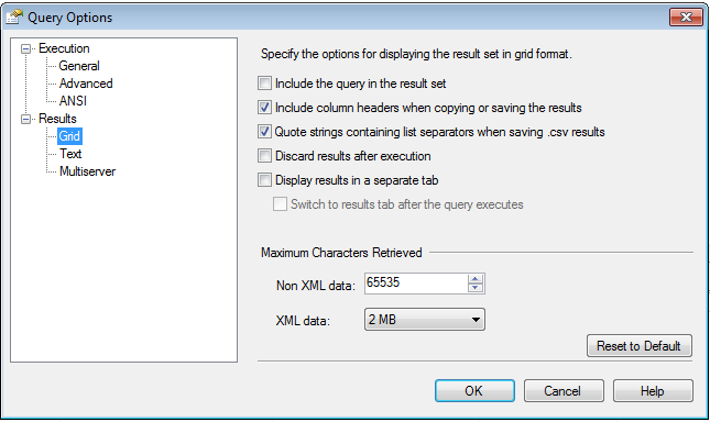

I played around with this a little bit and it seems like this will only give you the diagnostic/request IDs. From what I can tell this does not give any information about the IDs and messages that are present in regular CAN communication.
Maybe someone can use my results, so I'll attach the SQL Query and Python script that extracts the zip files and searches for the correct model and year.
If you want to play around with this make sure to enable the options below in SQL Management Studio, so the column names are exported as well: This does not contain any information from the VIDA database, so it should be fine to publish. Use at your own risk etc.
With the extracted scripts it should be pretty easy to use the request ID protocol that is documented here: https://github.com/Alfaa123/Volvo-CAN-Gauge
For convenience the SQL query already attaches the correct ECU IDs to the output of the query.
