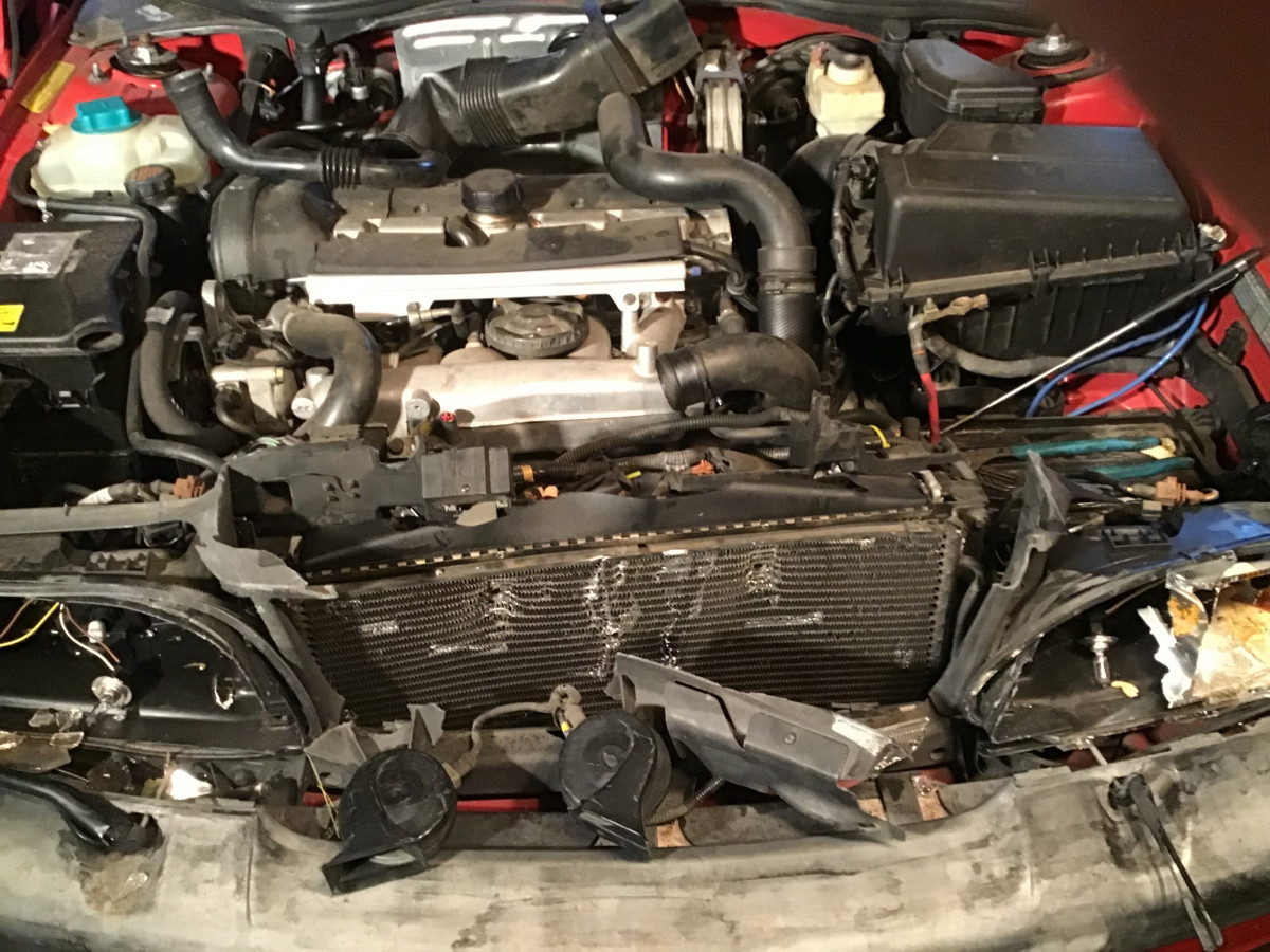

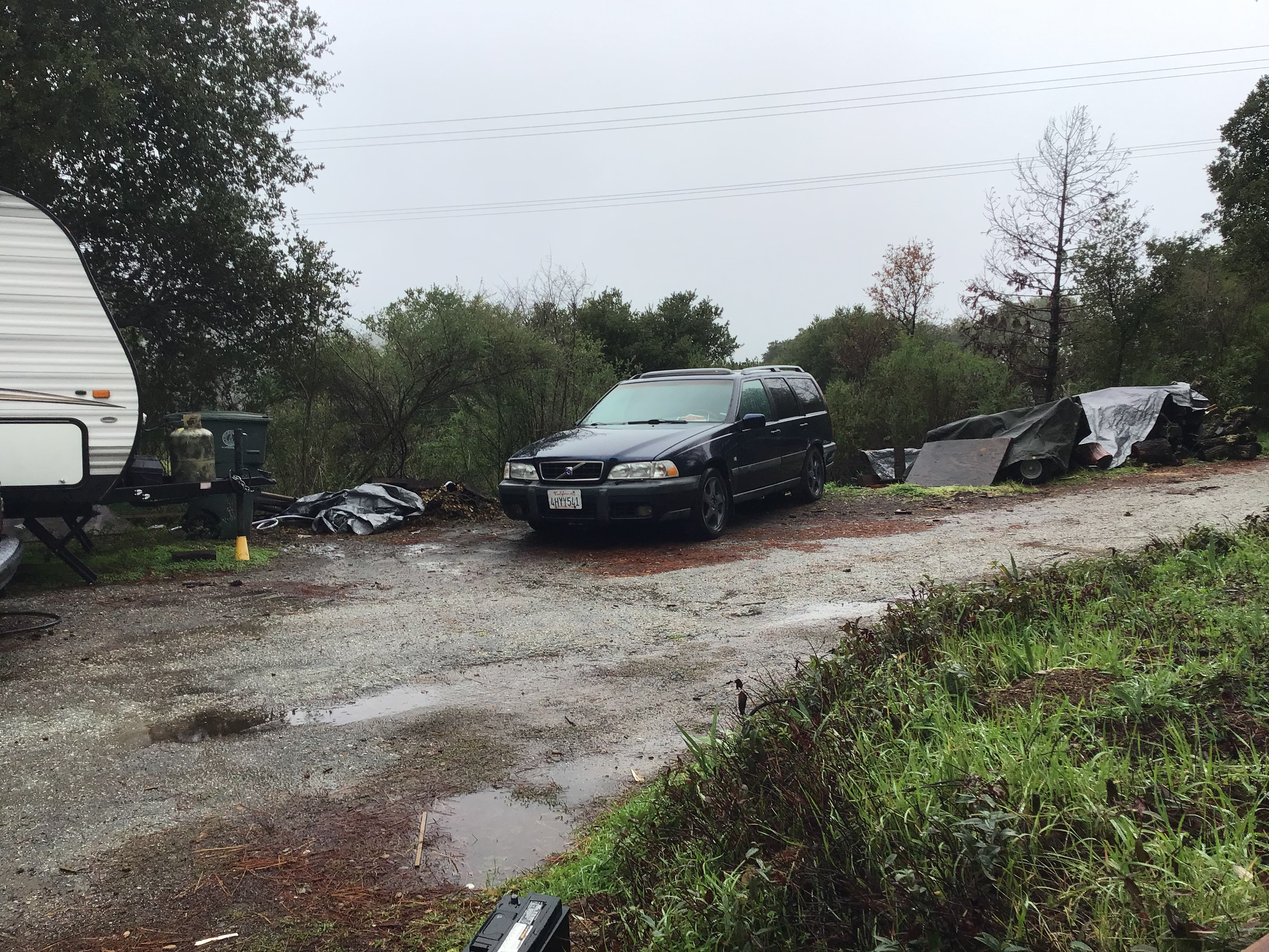

parts car and the carnage
blue parts car
"the carnage"
Would you install this radiator, damaged enroute from V. dealer
The reshipped the radiator you see in the carnage shot

Is the brass adapter just threaded in or is it epoxied or both?
Rocket99
Posts: 145
Joined: 25 Dec 2017, 07:36
Year and Model: 2000 V70 XC
Location: Los Altos, CA
Has thanked: 56 times
Post by Rocket99 »
scot850 wrote: 25 Dec 2021, 16:48 Is the brass adapter just threaded in or is it epoxied or both?
drilled and threads cut with a tap
together with JB weld it will be far more sturdy than the flimsy nipple from the factory
JB weld is probably overkill
If i'm not mistaken It is at the bottom when installed perhaps not exposed
Posts: 15506
Joined: 05 Apr 2010, 14:46
Year and Model: 2000 V70 R
Has thanked: 2210 times
Been thanked: 1852 times
Post by scot850 »
If that is the bottom of the radiator, then that is the drain plug, not a nipple! If there is a drain plug at the opposite corner then all is good.
There is a nipple on some radiators at the top hose that feeds back to the radiator header tank. I was trying to orientate myself relative to the radiator but hard to tell from the picture.

scot850 wrote: 26 Dec 2021, 10:43 If that is the bottom of the radiator, then that is the drain plug, not a nipple! If there is a drain plug at the opposite corner then all is good.
Now its almost fully apart I see that nipple is top passenger side
had to get it apart to tell these engine compartments a jam packed
I think I'll need to trip it shorter close to the length of the V. original length
thank you for all your input
I'm not the least concerned that brass nipple would be a problem
your paragraphs near the top of this thread are super helpful

Just as an aside, if your donor wagon is a vin 56 code, I would question the "R" designation; it won't matter for (most) of the parts you're after.

Thanks foggy, I'll be sure to verify, since the major parts I need are A/C condenser, intercooler, hood , headlights and turn signal(side) lights I think i'm good. I will verify again. Lucky for me the bumper I smacked into was fully above mine so zero involvement of my bumper.

A real "R" will be AWD and a high-pressure turbo, along with some trim and interior details. All the tin and plastic stuff you're after will transfer. The "R" would have a distinctly different front bumper cover as well.
