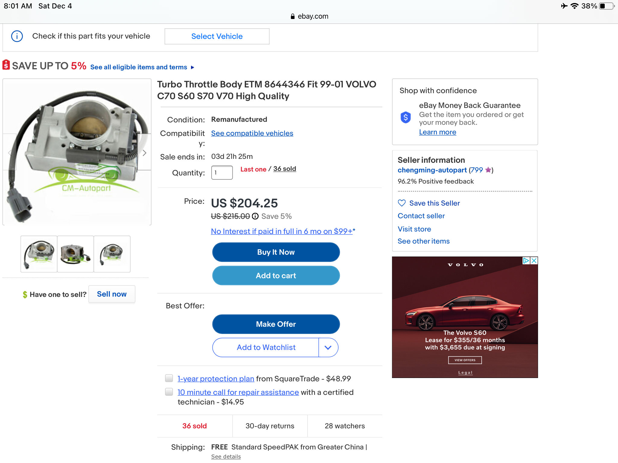

There are a bunch of sources of refurbished ETM at the $200 price point coming fro Gang ZHOU
Each seem to have sold tens of units. Many have the late white label showing MSO of Italy or Sweden
Any feedback on these? I don’t like that most every seller has “ XX sold, last one “ 🤥

Question of not only what are you getting, but you also presumably have to then get it programmed. If it won't programmed you are also out on that cost too.
The 'LAST ONE' is a good ruse. Sure some may be real, but most are just a marketing ploy. Same with ratings these days. Many companies delete or exclude bad reviews or have many fake positive reviews. Hard to know who to trust these days.
