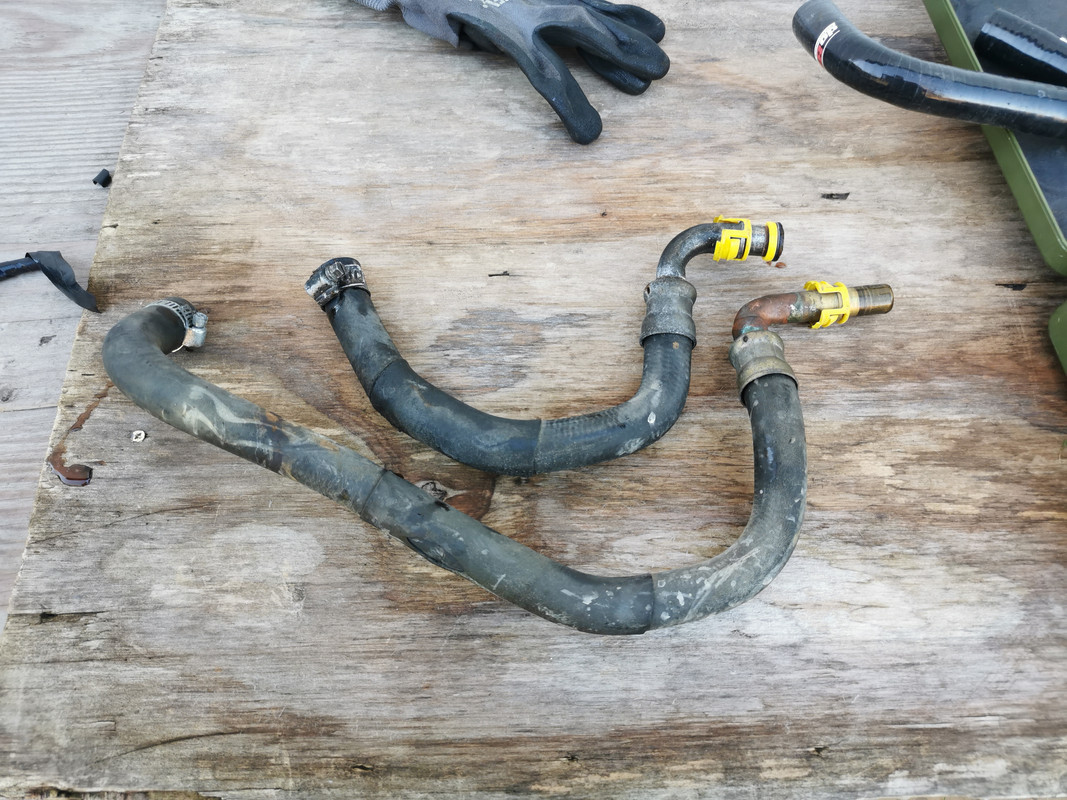

From about one year ago!hausmeister wrote: ↑31 Dec 2021, 15:38 Since it was so warm today I did a little bit of work. Heater Core is failing, and I checked out the lines which looked fine, but upon touching felt extra crispy.
Maybe someone can tell me if these lines are correct as they came out: long one on top, short one bottom, and the plastic ring goes on the short one?
Even easier.
One hose comes off the back of the cylinder head ( actually just below it on the block)
That’s the hot coolant flow IN to the heater core
The cooler side connects to the water pipe and heads back to the pump to be circulated through the radiator again.
Both hoses will fit into the upper and lower coupler positions, so upper and lower aren’t reliable markers. Stock configuration is upper Is hot in, lower is cooler out, relative to the heater core

Worst case scenario you can just bypass the firewall junction.

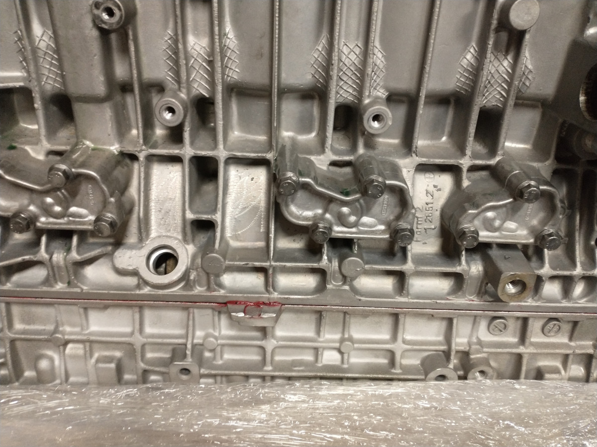

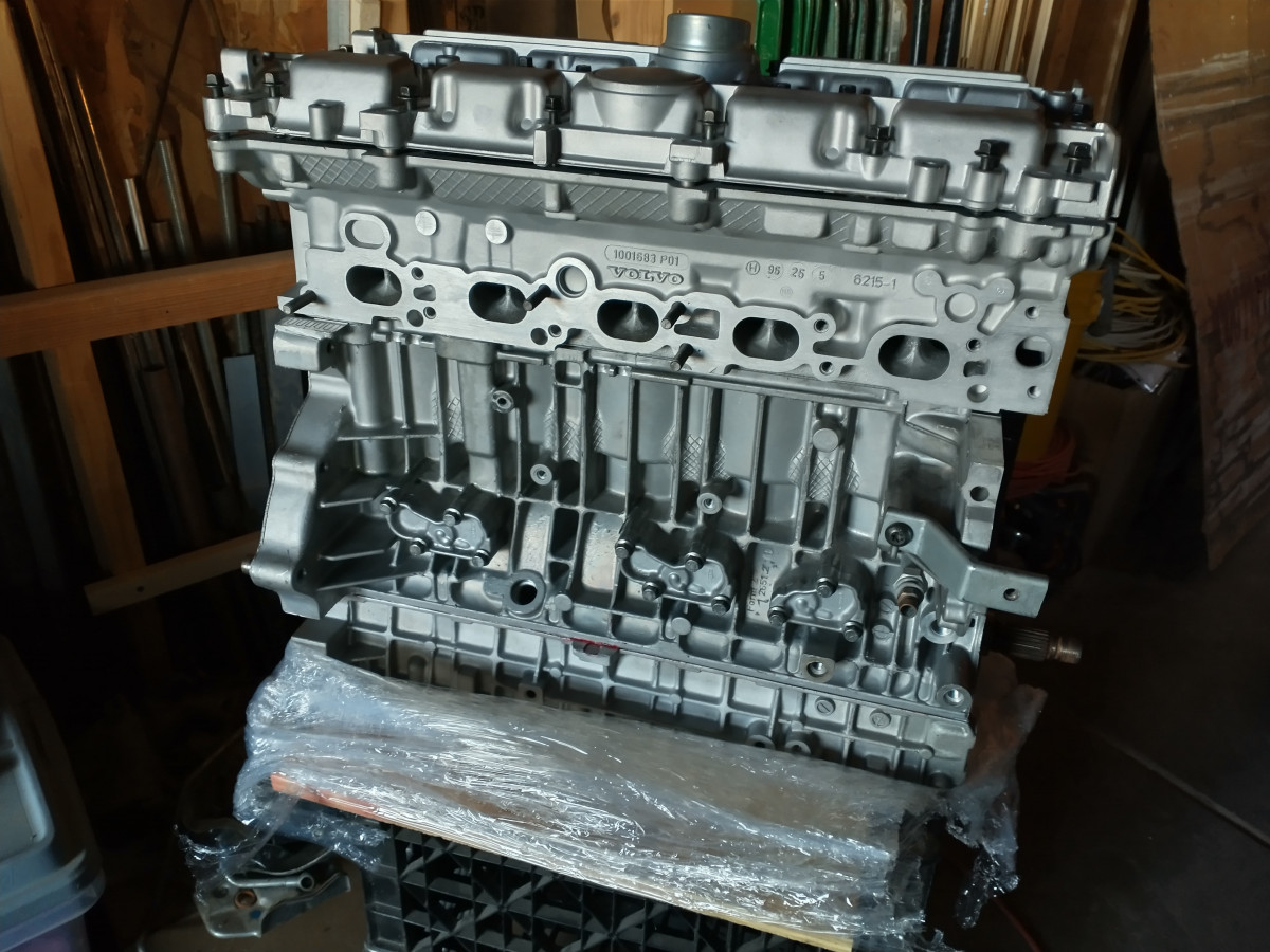

4 1/2 months later and I finally get my engine back from the shop. But they did a beautiful job !
So now install the N/A cams etc. One question; the shop said that I needed the gaskets for these three odd shaped areas, what ever they are. So what are they, so I can get these last couple of little things ordered up ?
Now I finally get to button this baby up ! Did i mention that it's been 4 1/2 months ?

I believe they are access ports for the piston oil jets
They 271815 gasket kit should cover it
https://www.volvopartswebstore.com/prod ... 71815.html

Oooh, pretty!
Those should be the correct gaskets. I'm surprised that they even offer those gaskets still, I would have suggested ultra black RTV.
