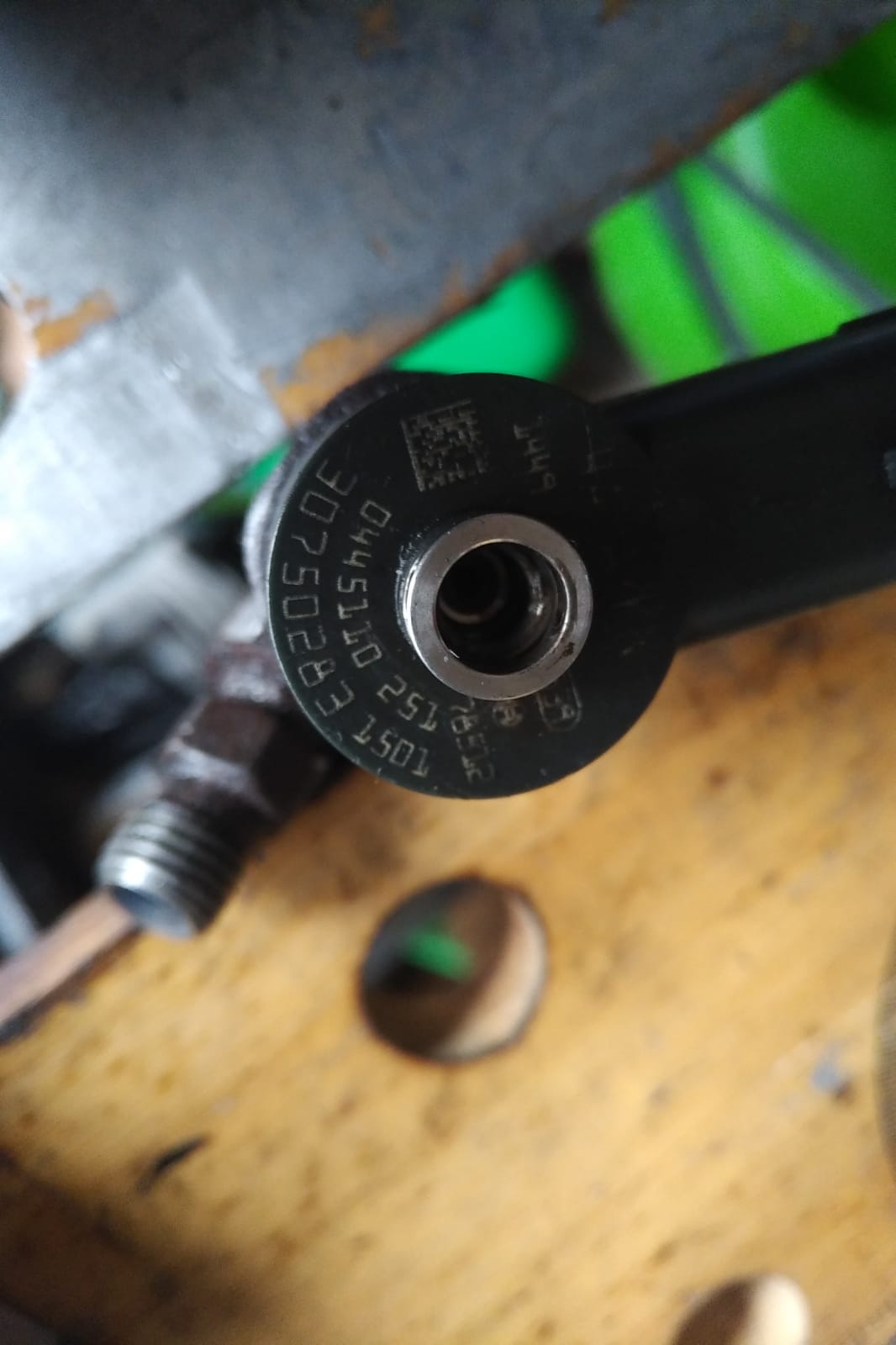

I think I've found the problem....Did the injector check and as you could see No 5 injector is leaking. What causes injector to leak? Faulty wire connection or its mechanical?
This is the leaking injector 30750283 (same on all 5 of them), but the part number on VIDA is different. Local Volvo breaker has it but part number is different. Should it match exactly?

2. There are different classes of injectors so you do need to find a match.
3. The high return flow on #5 would be mechanical.
