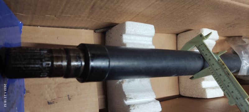

I hauled out the original take-off
The HF caliper says 43mm.
The older one may fit in the gearbox, but the outer carrier bearing won't fit in the clamp.
I bought a DSS 7843XB, and it's a great copy. 20k miles and counting,
https://www.carparts.com/axle-assembly/dss/DSS7843XB

Thanks for measuring,
The DSS page you linked indicates equivalence to the later version of the driveshaft (36001220, which supersedes 36000571) as you said. The DSS price is quite attractive ($160) especially given your good experience so far.
