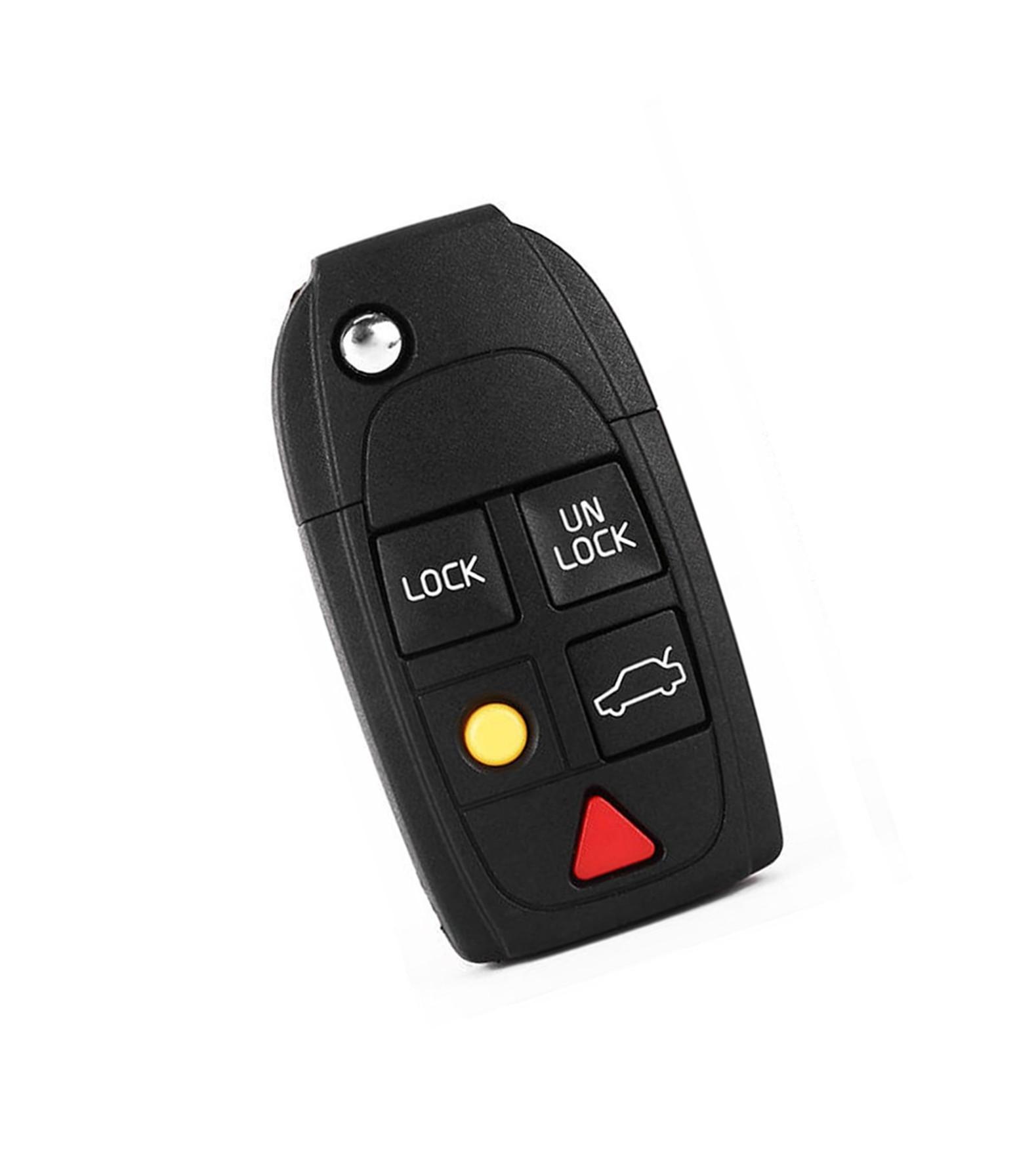

Does the one you have look like this.....
https://www.volvopartswebstore.com/prod ... 53436.html
..rather then this?
The second one is the flip key with the alarm sensor chip inside as well as auto lock, courtesy lights, and emergency alarm button.

Yes, mine looks like the key that you linked to, not the fob in the embedded picture. Which is why I wondered if this car would've had a keyless entry remote like this one: https://usparts.volvocars.com/p/Volvo_2 ... 85150.html
