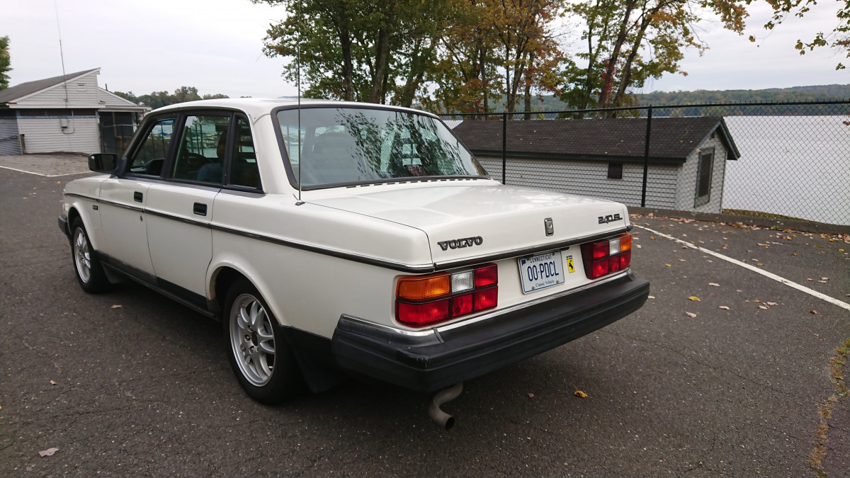

They will most certainly fit, but you would need to install the 25mm spacers on both axles.
I have a set of 16 x 6.5 Helium wheels with 205/55/16 on our 240 (Frieda) and it works just fine.
These were originally on 2000 S70 only.
I hope that helps.
Dirk
