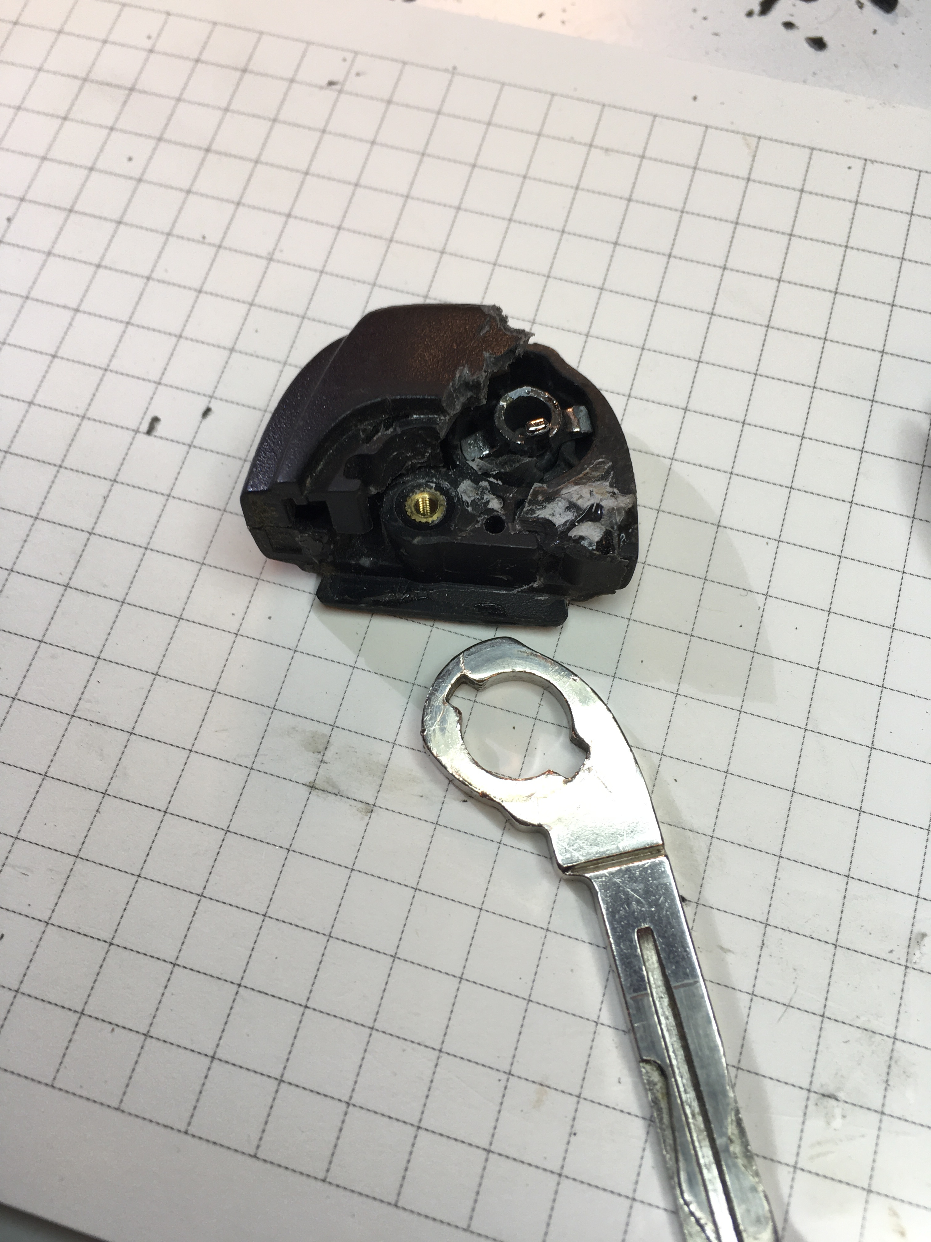

Then the trouble starts. I found that the entire upper section with the blade was filled with hard black epoxy. The PO's mechanic had filled all the voids and glued the halves together. First goal was the get the old blade out of there. It is hard plastic. There's a little glass transponder capsule somewhere in the upper piece - It's like an archeological dig in that you want to chop through the rock, but you have to make tiny progress with little tools in order to not destroy the priceless dinosaur bone in there.
OK, blade out. To this point I've used big snippers, tiny snippers, tiny screwdrivers as chisels, tiny needle nose pliers, and even a Dremel to very carefully split the halves. Two hours of slow and careful.
Ah HA! The dreaded chip / capsule / transponder!

It's embedded in the plastic and epoxy. I snipped and carved with a sharp utility knife, but I did not pry.
Then it's almost free, one more little snip....... ARGH, I've cracked the glass. ...
My mess is way worse than that German guys!
I got that little parallel ridge low enough, shaving with a utility knife, to loosen up the capsule.
And there it is...what a mess I've made. There appears to be a tiny copper coil inside. I read posts here at MVS that it isn't ruined..... yet. And someone said don't use glue, not sure why. So I gathered the little dome end pieces and set the whole thing on upside down scotch tape with a tweezers. After a lot of fiddling I managed to roll up the tape around it like a tiny burrito. No pressure, not too thick.
I pinched the ends shut and trimmed them.
This is what was left of the upper section.....

Oh no, did you try starting the car yet with that cracked transponder?
I cracked mine too the other day. Actually I just chipped the glass & it immediately quit working. Yagger is making new keys for me. Dealership wants $270 for just a new switchblade key. That does not include any key cutting, software, IMMO programming (transponder marrying) OR labor costs!
If your transponder doesn’t communicate with the ring behind the steering column (like mine ceased to) any longer he can help you out for a lot less than the dealer.

Sorry I didn't finish this, we were off to dinner.
Old key blade in new case. (Forgot to put the capsule in here and it had to come apart again - at least this one is easy to take apart) You learn to fiddle a bit with fitting and twisting the spring to load the flip key, then snap the lid on over the button.
Old guts to transfer. The original rubber tray is shaped much better than the new one, so the circuit board fits. I used it.
So...the punch line......
Went to the garage, and to my surprise it locks, unlocks, turns on the courtesy lights, unlocks the hatch...all good.
We were quite pleased with ourselves.
After Pete's post, I had to go back out and try it again..... Locks and unlocks just fine.
Then I tried to start it and it acted like a low battery - not dead, but clacking, no start. UH oh....
Got the other key, the one we always use, and it started the car after a couple of stumbles - wonder if that's from messing with the alarm and all that unlocking.
So I was hoping to provide a nice little write-up, but I wonder if I've done the opposite lesson, in how to not break the glass and screw up your keys.
