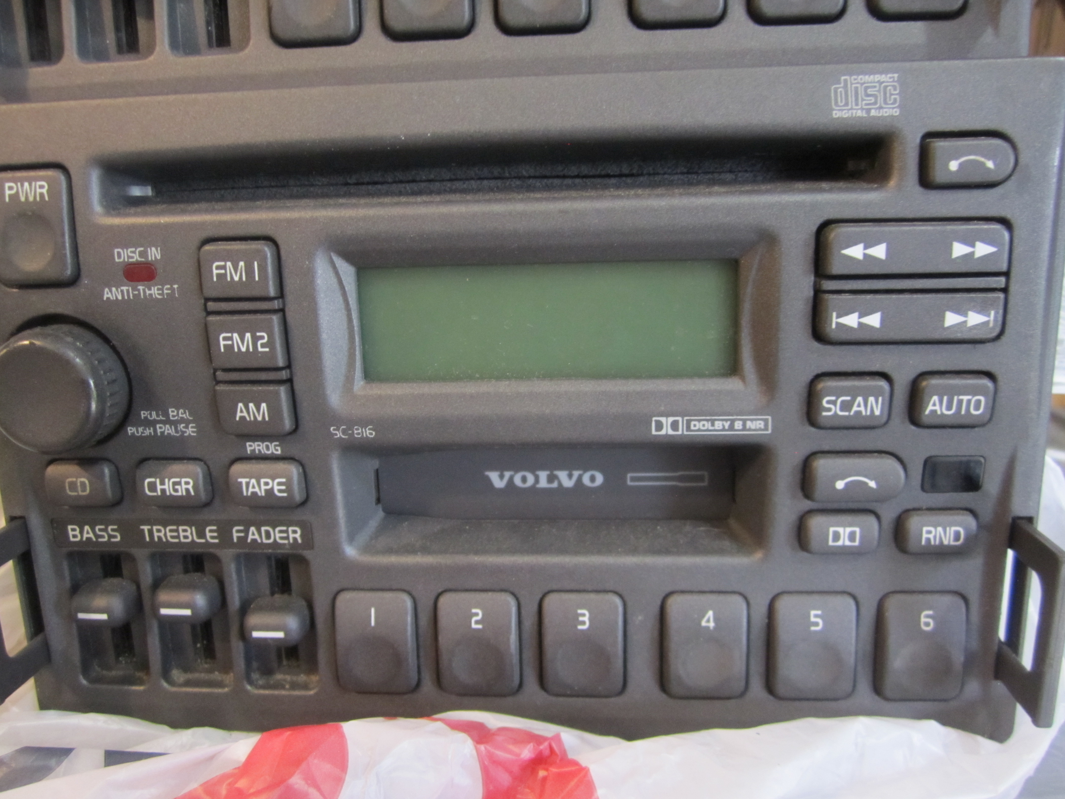

Which head units do you have? SC-815 or SC-816 perhaps? Should be on the front face plate usually about half way down?
You can see the SC-816 to the left and below the LCD screen. SC-815 is an older but similar unit.
The CD issues are usually the laser needs cleaned (the multi-CD units in the SC-900/901 are bad for that) and cleaning the heads on the cassette can be as easy as using 2 cotton buds taped together to give the length needed to get to the playing head and some IPA/rubbing alcohol. If you are stuck, I can probably help and may still have some units kicking around as well.

that's the unit i have! CD/cassette combo. how would i go about cleaning the laser on it?scot850 wrote: 24 Jan 2022, 12:25 Which head units do you have? SC-815 or SC-816 perhaps? Should be on the front face plate usually about half way down?
