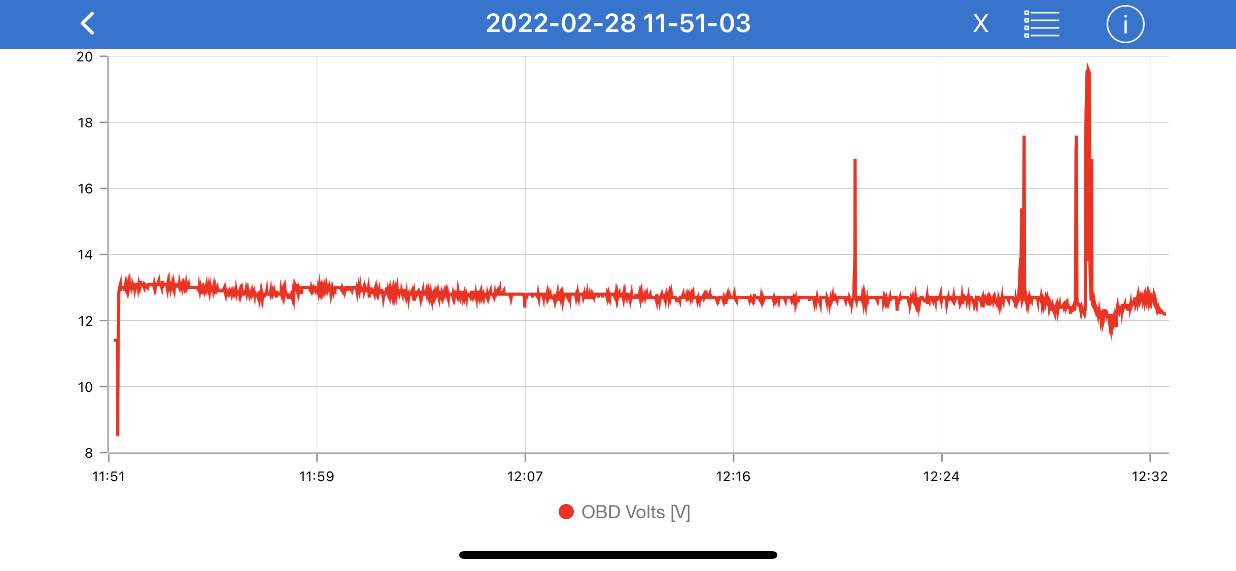

Hi all, I'm back again with an update.
I tried swapping a battery from my father-in-law's Infiniti, which itself had recently had a battery swapped in which was obtained at a junkyard. This car had been running fine on this battery for a couple of weeks. We removed the battery from the Infinite, attached it to a charger on a recondition cycle, which after 24 hours changed to float charge. About a week after reaching float, I shut off charging. The battery showed a level of 14.3 immediately after charging stopped, which then dropped to 13.6 after a minute.
I installed it in the Volvo. It wasn't quite a perfect fit - the battery had a weird piece of metal sticking up alongside of the positive terminal, but I managed to wedge the clamp around it and tighten it down. The battery was a bit taller and narrower than the existing battery. But the car started up successfully and ran normally for nearly 30 minutes.
Here is the OBD voltage graph of my test run. The voltage after ignition was 13.0. It experienced a shallow but continuous decline throughout the remainder of the run.
At 30 minutes in, the voltage had reached 12.7. There was a brief voltage spike up to about 17, which caused the 'brake failure service urgent' message to appear but didn't cause any other symptoms, such as the clunking I had seen previously. 7 minutes later there were a couple of similar voltage spikes up to about 17.5, but no clunking symptoms. Then I remembered that in previous runs, I had the HVAC blowers on maximum, so I switched them on to max. This immediately caused voltage to drop by 0.3 volts to 12.4v. Once the car was in this state, it started experiencing larger voltage spikes up to 18-20 volts, as well as the return of the clunking that was seen in earlier.
Since I'm experiencing basically the same symptoms with a different battery, I tend to think it's not a battery issue, unless both batteries are problematic. The only other battery test I could do would be obtaining a brand new battery.
Since there were smaller voltage spikes prior to turning the blower on max, I tend to think it's not so much an issue with the blower motor, but rather that the alternator is not able to put out adequate voltage to power the car's systems, and that the blower motor adds just enough load to push it over the edge.
I believe my decision now is whether to attempt to replace just the voltage regulator, or the entire alternator. Any thoughts?
