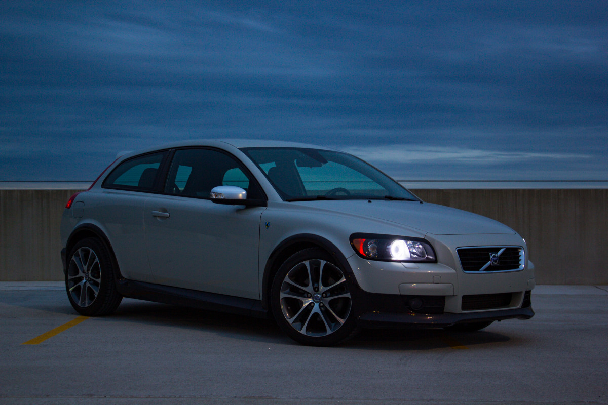

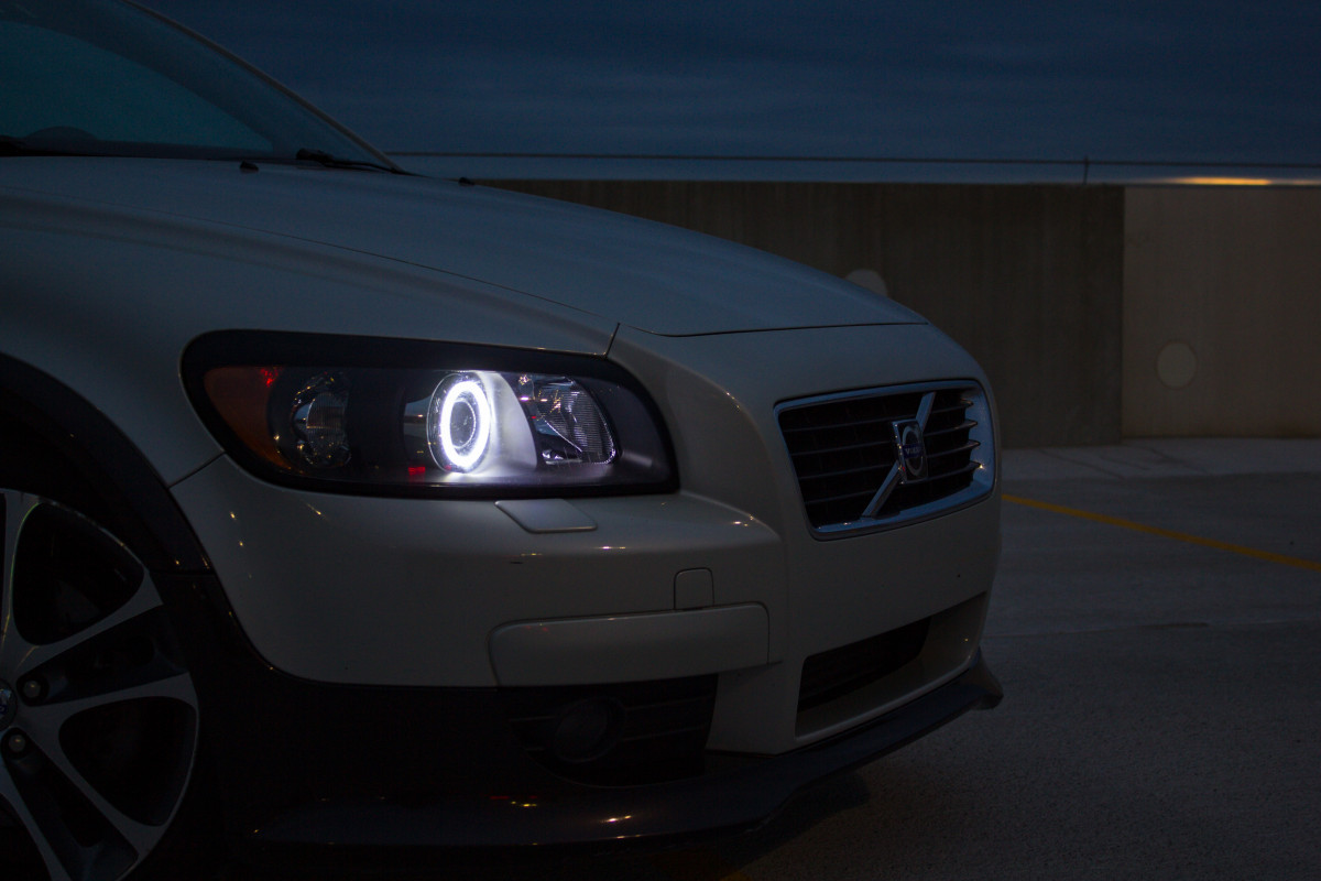

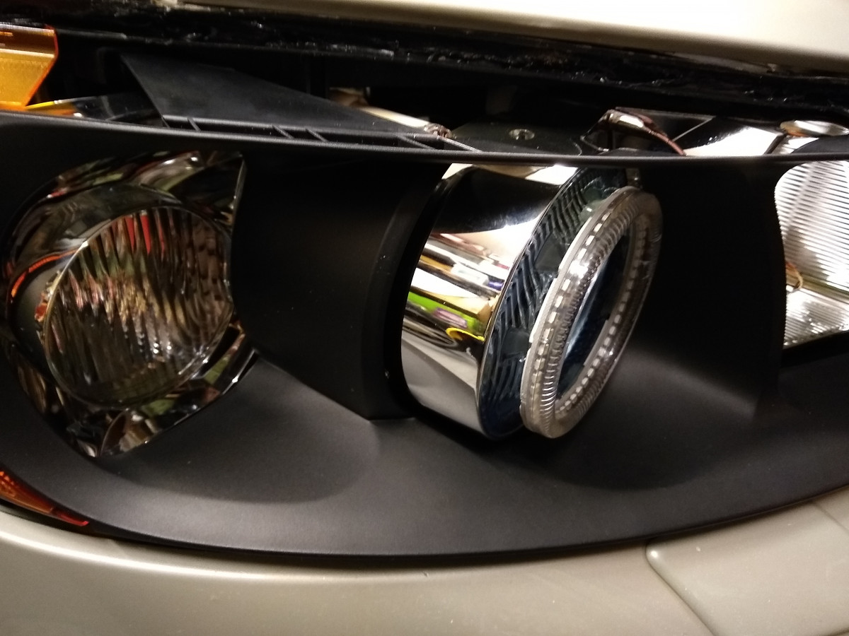

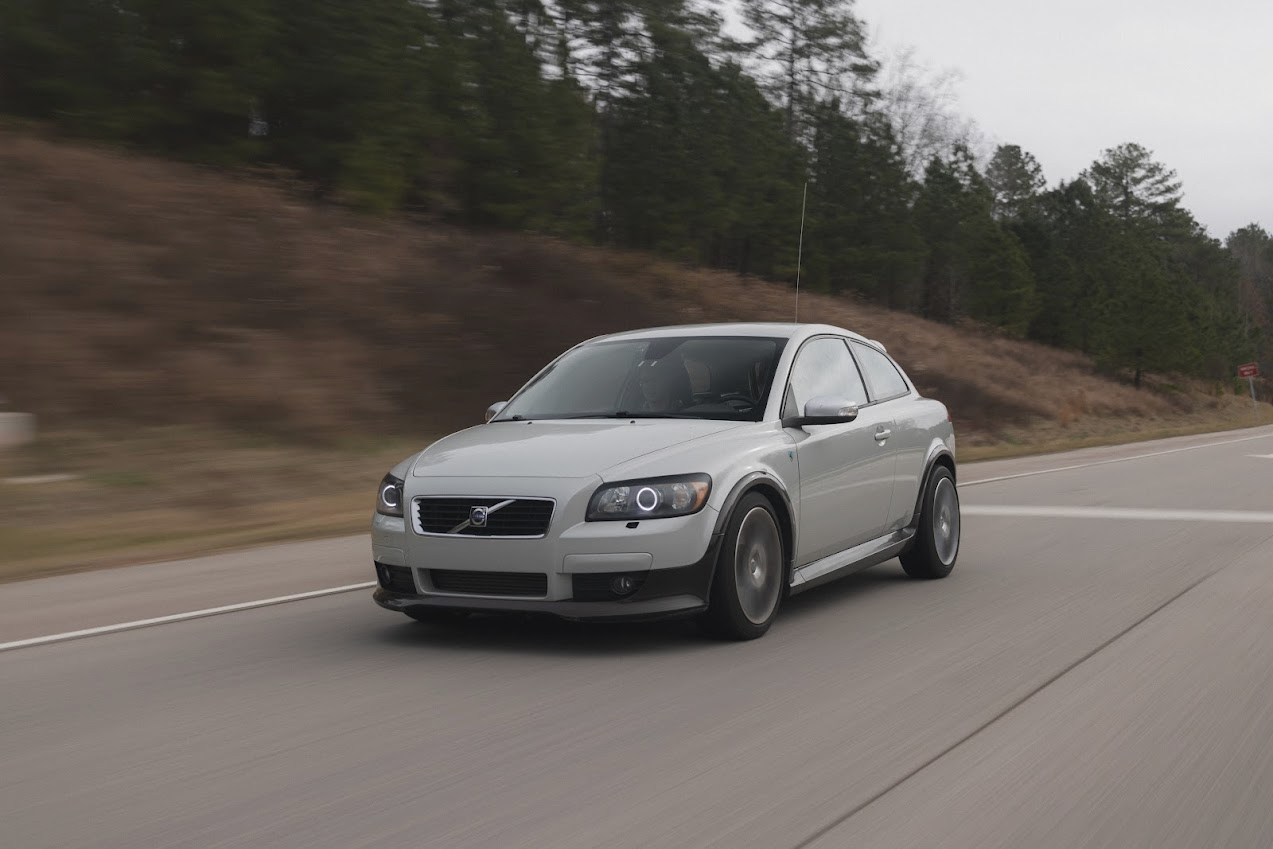

Suggest you find a Halo small enough to go behind the trim ring / xenon cover. We separated our assembly but another C30 member said his Halo was slightly smaller so could just go on the back of the ring. Wire into parking light and it can be on all the time without issues and you won't have the DRL or headlights on.
Hot glue and double sided tape which it came with.

Post by MoVolvos »
Bright enough for safety during the day.

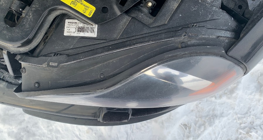

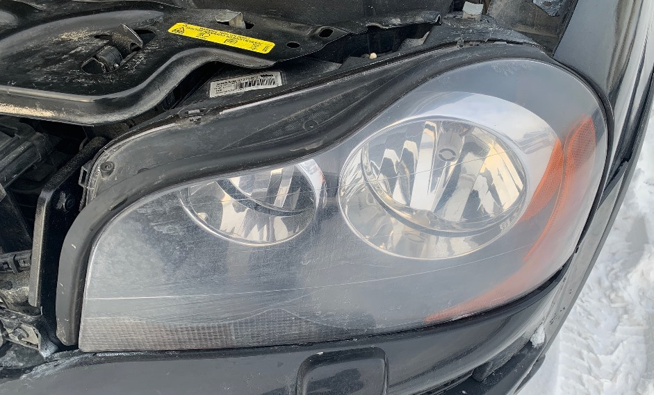

Post by Oka »
ggleavitt wrote: 27 Jan 2022, 11:18 No idea your headlight setup, maybe post a photo of the front of the vehicle with both headlight assemblies clearly visible.
2005XC90 Headlight 1.JPG (259.8 KiB) Viewed 894 times
2005XC90 Headlight 2.JPG (198.33 KiB) Viewed 894 times

Oka wrote: 27 Jan 2022, 18:09
A direct frontal picture into the inside would be helpful.

Looks like Halogens for both hi and low beams. Take you own assembly and separate. From the seams it looks straight forward. Install Halo's on the hi beam as it hardly ever gets use. When the lo beam is on in the evening it won't heat up the Halo as it's on the other lens.
As mentioned before driving with only the parking lights switched on during day all your exterior lights will be on for safety and the DRL will be off.

MoVolvos wrote: 27 Jan 2022, 14:25 Bright enough for safety during the day.
Yes it is bright enough.
My next question, I would think all Volvos, especially, the older models would have the same lighting settings, with the low beam meant as Driving Light? I don't know about your model. Or, did you modify the settings to have the Angel Eye for driving, if so, where's the low beam? That lighting style is so cool!
